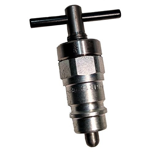

   / Can't connect Pioneer fitting from my EA grapple to the tractor? #24
Maybe tool like this to relieve pressure for you female connector on implement...
#25
I could use that tool. who makes it?

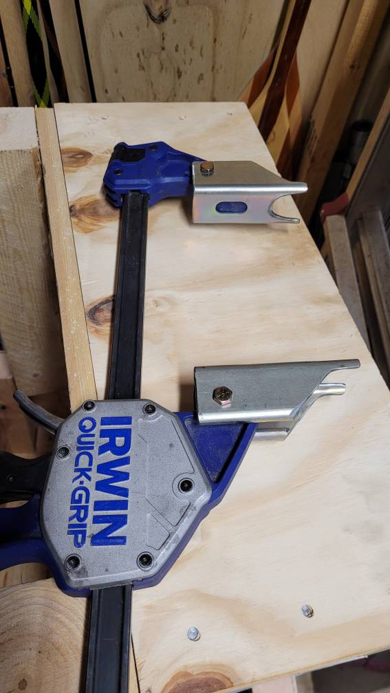

   / Can't connect Pioneer fitting from my EA grapple to the tractor? #27
Price of a simple clamp and some grinding on left over Uni-Strut from Home Depot...works on my stubborn flat face QDs.
