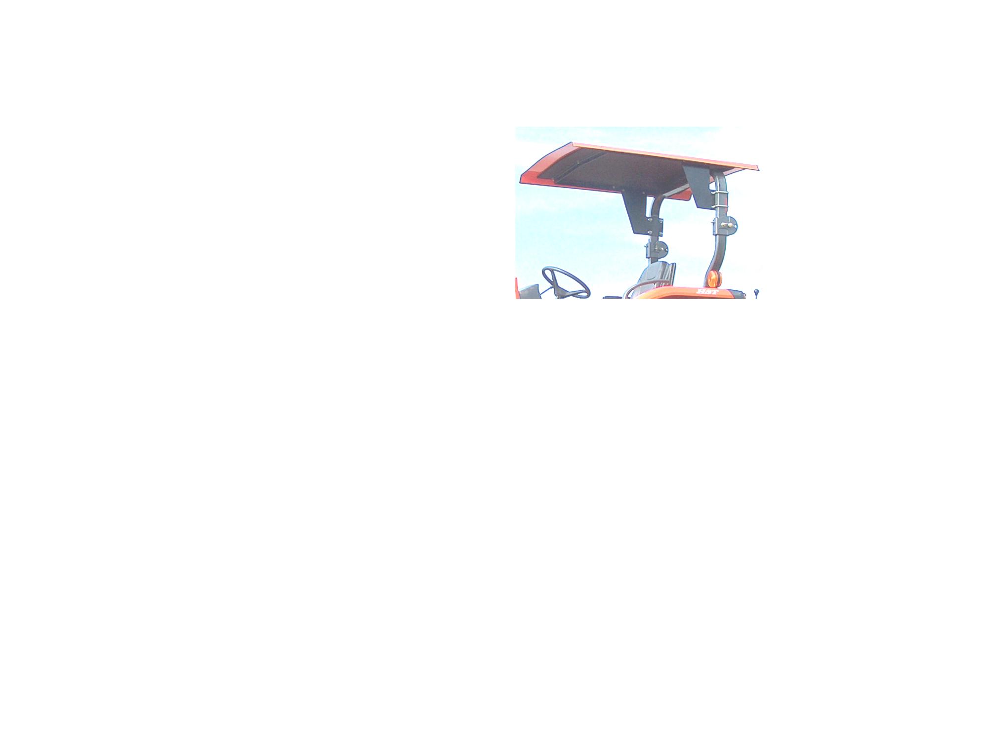

Moeh1, here is a photo of my canopy. The brackets are attached to a metal frame which is attached to the metal top with a layer of insulation in-between.

the diamond plate aluminum is usually pricey here too, but I often slum around a local metal surplus shop, they got some damaged sheets recently. Unfortunately, before I stopped back today, they had sheared them into 48" squares, so my canopy will be a little shorter than many of the commercial ones. I was looking for a 42x 60 piece, but for $20, I couldn't pass one up. Figure another $10 for the steel, and a couple nights of fun in the shop when its warmer, and I am way ahead. Going to think hard about that bow in the cross rails. Thanks also to Don for an alternate bracket shape!
   / canopy support dimensions #20
Way to go Marty. My cross rails look like they just clamped them and pulled. /forums/images/graemlins/grin.gif
