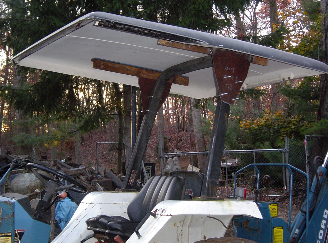

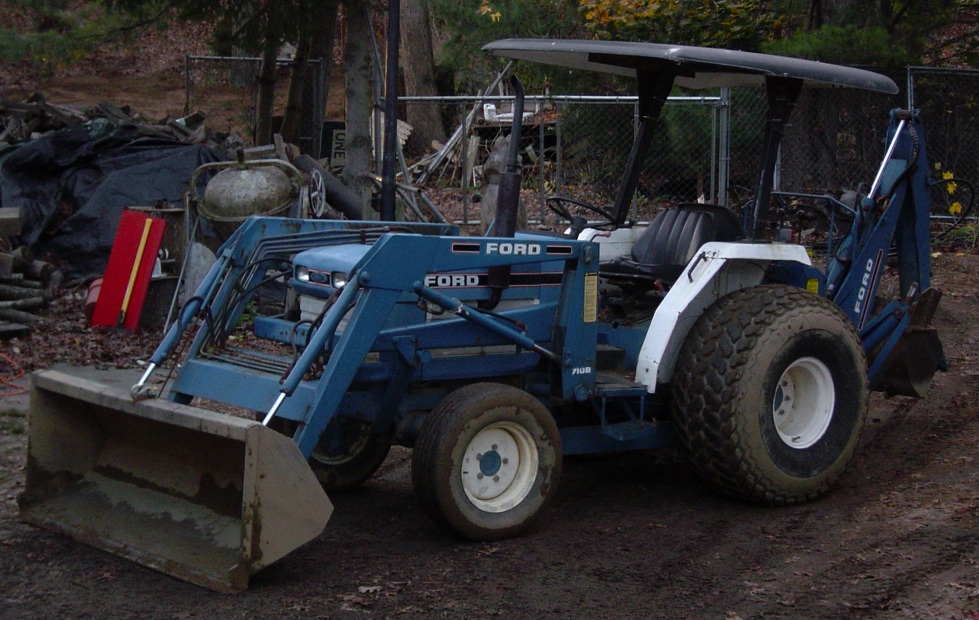

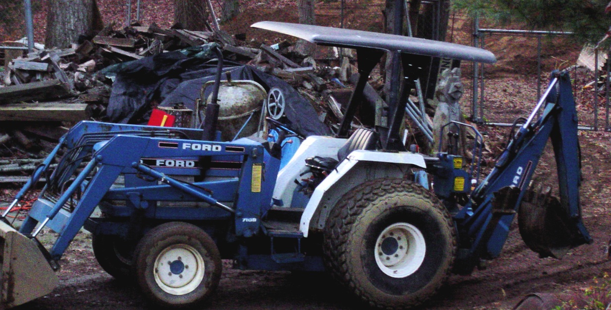

My brother had an old Jeep CJ hardtop laying around.
I cut off the back window and sides.
Made a nice even cut all the way around.
Welded up some brackets.
Didn't take long to do.
If you look at the pictures I think I have the front angled up too high.
I still need to finish welding and paint but it seems to work well and it covers backhoe seat as well

Nice job so far. Promise me you'll cut off those sharp corners on the angle iron before you are done. :D
/ canopy from Jeep CJ hardtop
This is just in mock up form so far. I need to take it off and modify it.
Lower the front angle down, cut off those sharp corners on the angle iron,
hang a rear view mirror-not sure exactly where yet. I guess I could mount rear lights on it too.
This was just junk laying around for years.
I love the extra width- rain from the side drips down over the center of the rear tire tread.
The hardtop is very strong. I feel safer under it.
Not sure if I should paint it blue or white. The metal will be the same as the ROPS

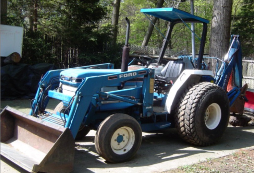

If I have something laying around with no intention of selling I look at it as a raw material. I also have a cap for a Toyota Pickupthat I considered using.
It was too thin in my opinion- good only for a sunshade/umbrella.
I get some real FOPS protection out of this and it only cost $20.00 out of pocket.
I didn't post to get approval just to share and if anyone had suggestions
they would be very welcome!

old canopy --------------------new canopy
