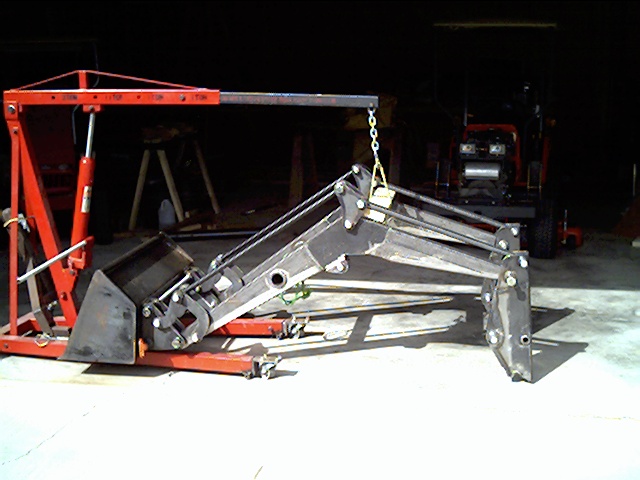

Somebody want a picture of some other projects...attached is a picture of my Home Made FEL. Notice the linkage...keeps the bucket at the same angle throughout the lift cycle. Not too bad for a one-eyed, two-fingered fat boy.

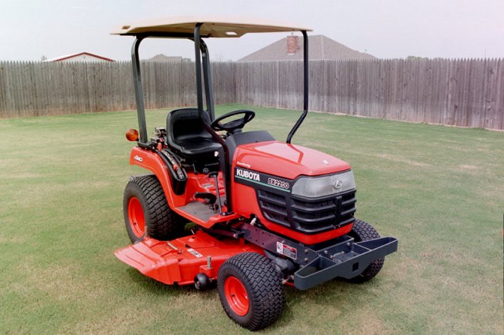

Would like to see a picture of your front bumper. What size tubing did you use? Did you add anything inside of it to give it added weight??
   / Canopies #13
Minioaksmocha, I'll provide a couple of pictures of the bumper....one attached here and another attached to another reply. As you can see, I didn't use tubing...I used 3/8" X 3" flat steel. Did a little cutting, hacking and modifing to produce what you see here. I didn't want the extra weight on the front end all the time and that's the reason I made the bumper/reciever hitch to accept factory suitcase weights.

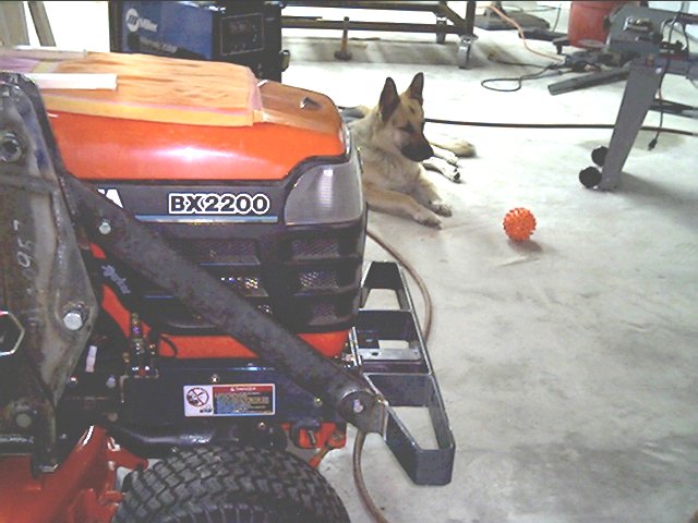

Here's another shot of the bumper.

This might seem like a very silly question but I'll ask anyway - does your front bumper (very nicely done by the way) get in the way with any of you loader movements?
   / Canopies #17
tdenny,
The bumper is not a problem for the FEL. The only thing I had to do was trim approx. 2.5" from the lever that is used to lock/hold the front of the mower deck. The lose of the 2.5" inches has not been a problem either.
