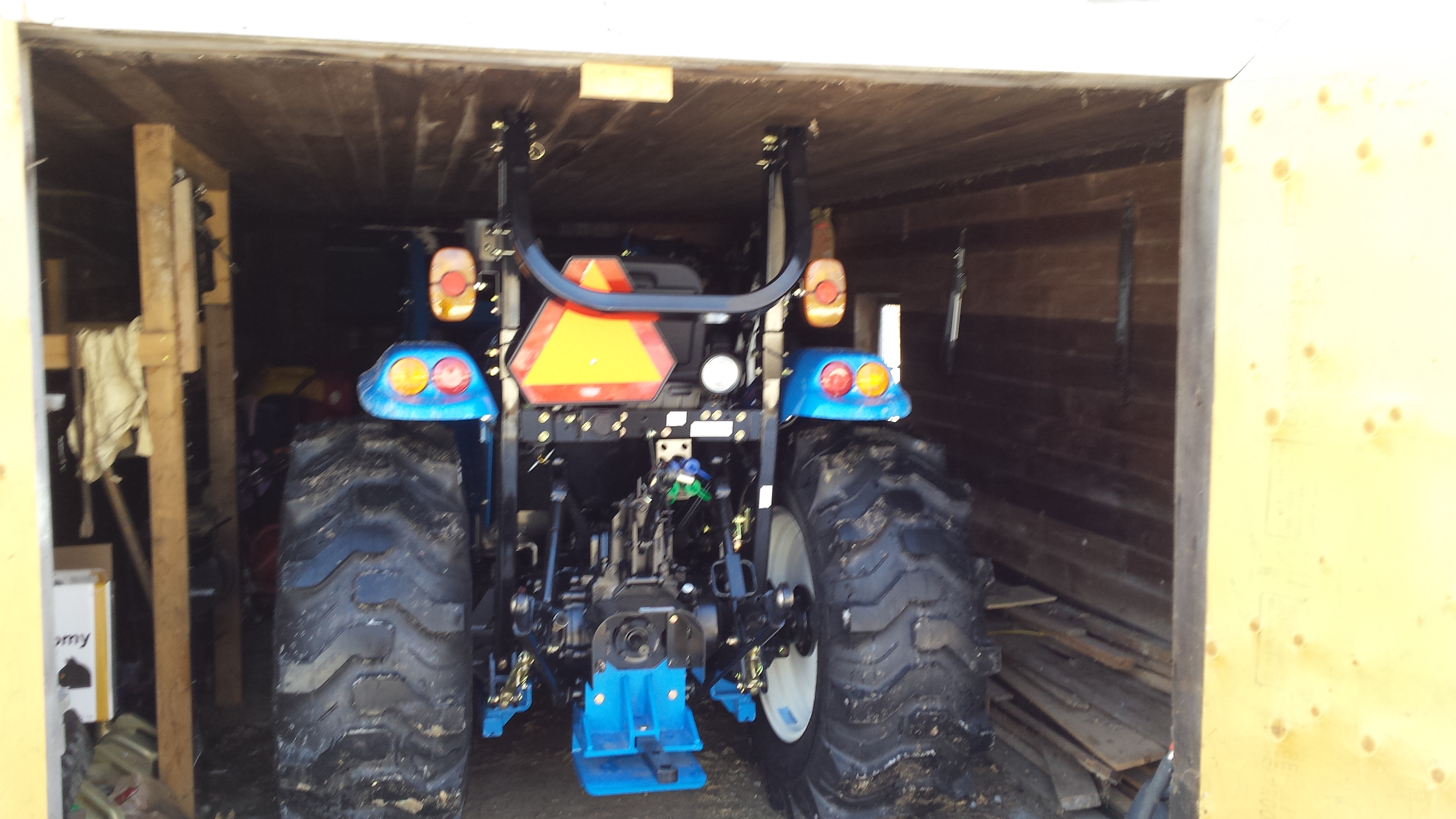

Dealer dropped off a demo unit. I cannot lift the bucket and curl at the same time.
Is this normal or am I doing something wrong?

Does the joystick only move in N,S,E, & West. Most joysticks (not all) also move NE,SE,SW, and NW to allow curl and lift or curl and dump. Maybe it can't be done with the joystick valve on the demo.

Check the manual if they left one or call the dealer but it wouldn't surprise me if that is normal. My TC40DA will only do one function at a time. The joystick only moves left/right or forwards/backwards. I imagine it has to do with hydraulic flow capability.

Non-double acting is a feature on cheaper low hydraulic flow machines. If it doesn't do it now it won't do it after you buy it. Tell your salesperson where to stick it in his sweet spot.
If you plan on a lot of loader work be sure to check the cycle times for raising/lowering the boom and curling/dumping the bucket. If they don't publish it then be prepared for very slow hydraulic cycle times. How much weight a machine lifts is only part of the equation. Cycle times are the gotchya's for less savvy buyers.
There is a LOT of variation out there and you get what you pay for. Manufacturers think that homeowners don't mind sitting around and waiting for the machines do do their jobs because they tend to buy based on machine color and the number of cup holders.

Dealer picked up the Boomer 40 this morning. He could not get the bucket to lift and curl either. I do not feel stupid anymore. Says it is an adjustment. If so, why not get it set up before sending the unit out?
Anyway, moving on. Called the LS dealer today and getting the XR4140. More tractor for the same money. (50% more lift capacity and 25% heavier than the Boomer 40 for $700 more OTD after trade)
I really appreciated the NH dealer letting us demo the unit. Dealer is Don's Tractors in Alpena MI and they are good people. They offered me the most for my trade. I would have considered the Boomer 45 but it will not clear my garage opening so never worked the numbers on it.
