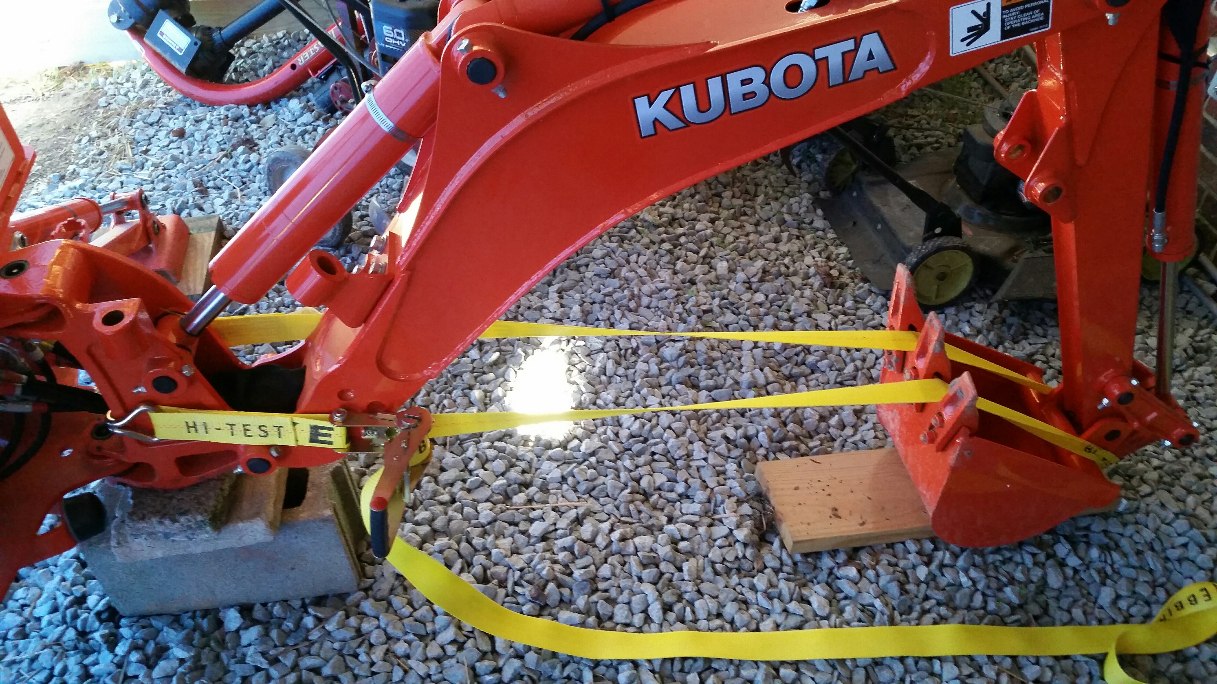

I've started removing my FEL when mowing simply because it was slowing me down as I was trying not to hit things with it - heh. Once I learned how to take off the FEL, it goes pretty quick. The BH on the other hand, is never hooked up unless I specifically need it. Hooking up the BH was always a problem because it squatted over time so I've started using a 3" ratchet strap on the arm and set the unit on blocks to help keep it where I can hook it up faster.View attachment 464555
Thanks, you just saved me for asking the question as to how to store my back hoe when I take it off. I was wondering about that very thing so now I know. I have an old cargo strap that should be ideal.
