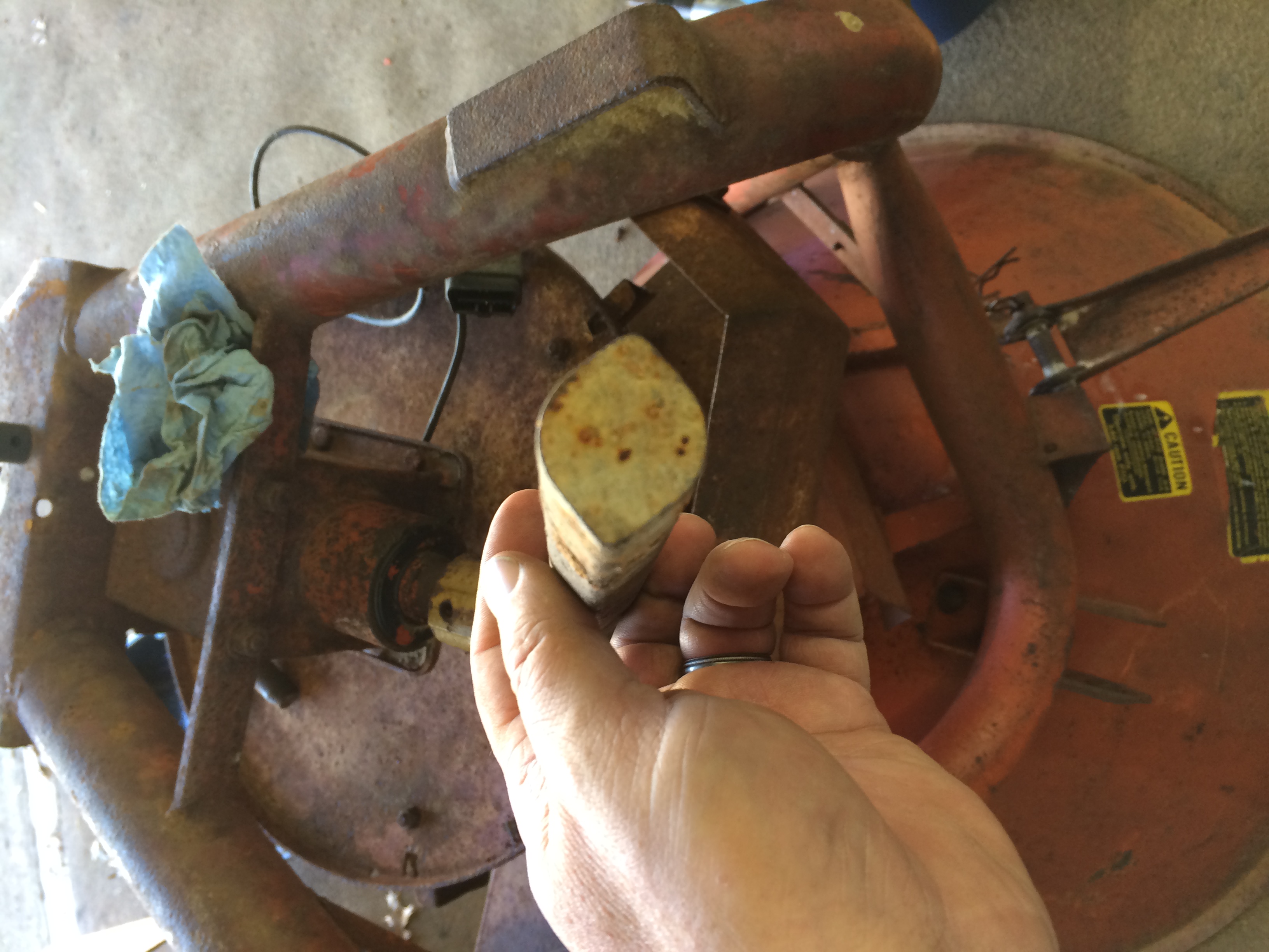

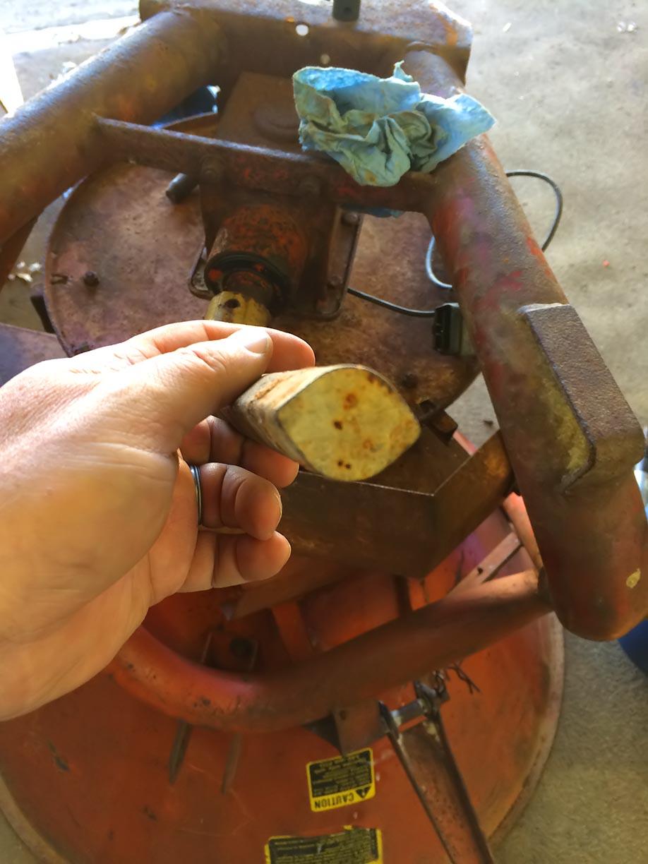

Bought this spreader at an equipment auction. Only has implement end of PTO shaft, which is rusted hard onto gear box shaft. Any idea what this is and where I can get the other half?
Any decent farm equipment dealership or supply house should be able to get that. It is a Walterscheid brand shaft, probably a 2100 series.

I was in the same position but the other shaft had a slight dent and did not telescope smoothly. You can purchase a complete shaft for a fertilizer spreader at TSC if you want to. It was quicker and easier than finding half a shaft. The shaft will have quik connects on each end. Worked for me.
/ Can you identify this PTO Shaft #5
Measure the shaft from ridge to ridge. That will tell you what size. You already have the next step. A picture. Stop in at a Rural King or TSC or a farm equipment dealer. And get your new end. Too bad your not closer. I know a local place that would probably have that new or used.

Remove the half shaft on the spreader, mount the fertilizer spreader on your tractor. Measure distance from base of PTO Shaft on spreader to base of PTO shaft on your tractor. Total length of replacement shaft should be this measurement plus about 20% for good overlap.
You don't need a real heavy duty shaft for a fertilizer spreader.
What brand is your spreader? I have a BEFCO spreader and can measure my shaft if that's helpful?

He will need to get the rusted end off of the spreader first. I had a similar situation on my sickle mower. It was a keyed end with double roller pin. I got the pin out, but the key was frozen. I used several types of break free and what did the trick was heating with a hand held torch running map gas (did several times and added the break free after each and the neighbors slide hammer attached to the end. Im my case the end was obsolete, bu Rowse rakes fab a custom shaft for me as they carried the old ends. Local shops could not help.

powerscol is exactly right - the issue is that I can't get the shaft off of spreader. There has already been lots of penetrating oil, force, cussing, heat, etc attempted.
The idea was to buy tractor side half shaft that would fit the one rusted on. My local TSC does not offer a shaft with the same cross section as this one (thus the reason I asked for help identifying the shaft).
I have 2 other alternatives:
1) Take the u joint apart and connect another shaft that way (will require some research to see if the yoke will fit the shaft).
2) Cut the yoke off and replace - research to see if a replacement PTO shaft will fit the shaft on the spreader.

One other thing you can try as a last resort. Get a cutting wheel on a grinder and slit the shaft lengthwise at the connection. Be very careful not to cut into the spline on the unit. Then use a cold chisel and split the outer casing - or find a shop willing to do it for you :thumbsup:
