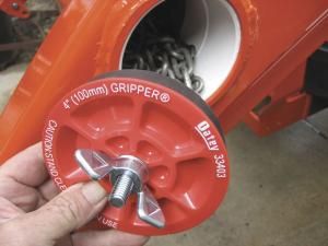

You need a good place to store your chains. I have two on my G3038H. First is an open "cage" made of expanded steel and mounted to the left side FEL mast between the mast and the hood - there is a surprisingly large amount of space there and it's handy to the getting into the cab, chuck the chain and climb aboard. Next is the round cross support on the FEL - it is an open pipe. I drove a length of 3" ABS pipe into the tube (it fits great) and then use those red plumbing pressure test caps (the ones with the expanding rubber gasket and wing nut) to protect both ends - I have two lengths of chain and hooks in there, some rags, and a few regularly used tools (two larger adjustable wrenches and screwdrivers wrapped in shop rags. Like this - obviously not my tractor, unless I got wild with orange:

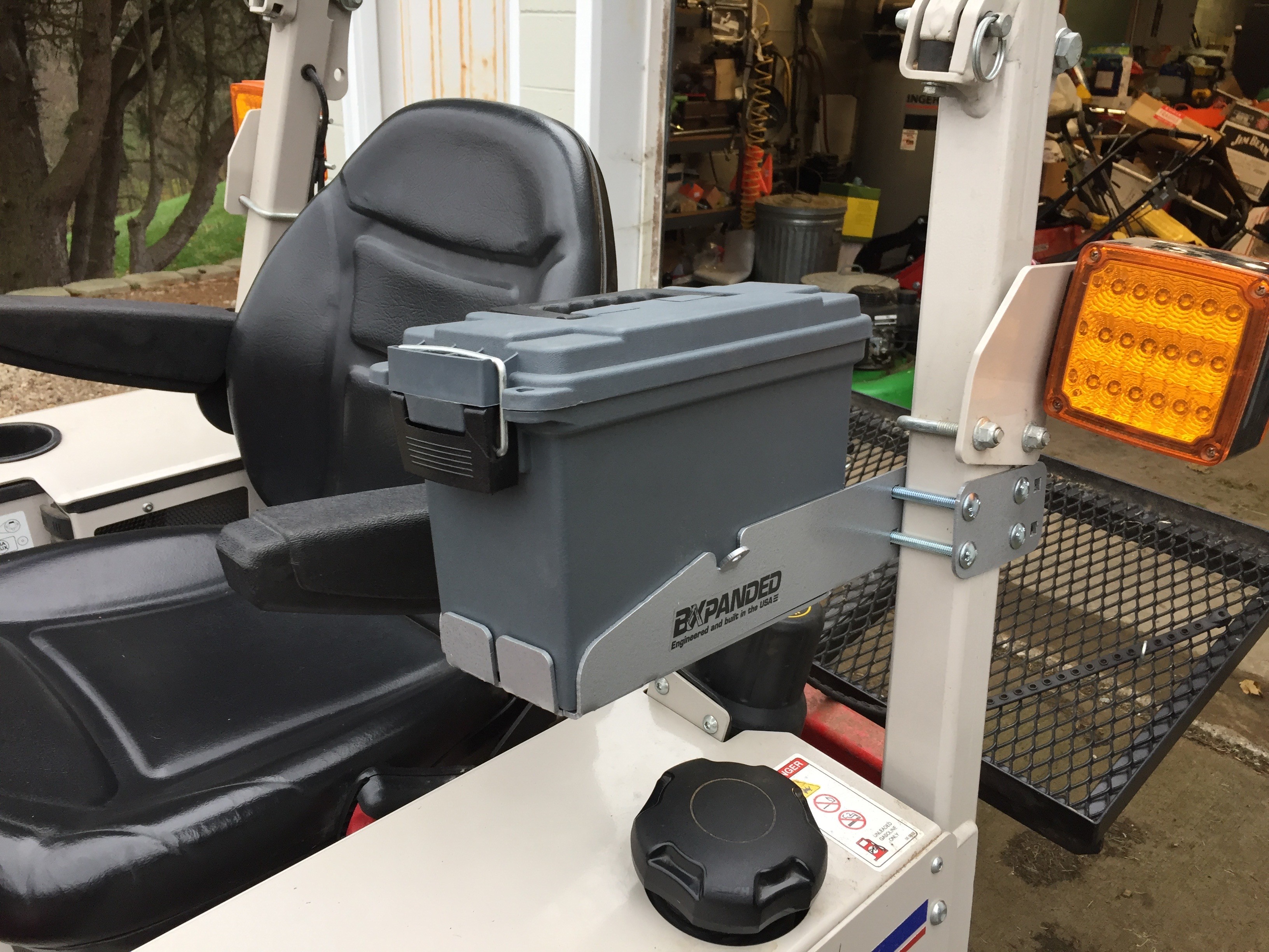

I will be adding tool boxes to a platform I will be putting onto the ROPS uprights with u-bolts. Kind of like this

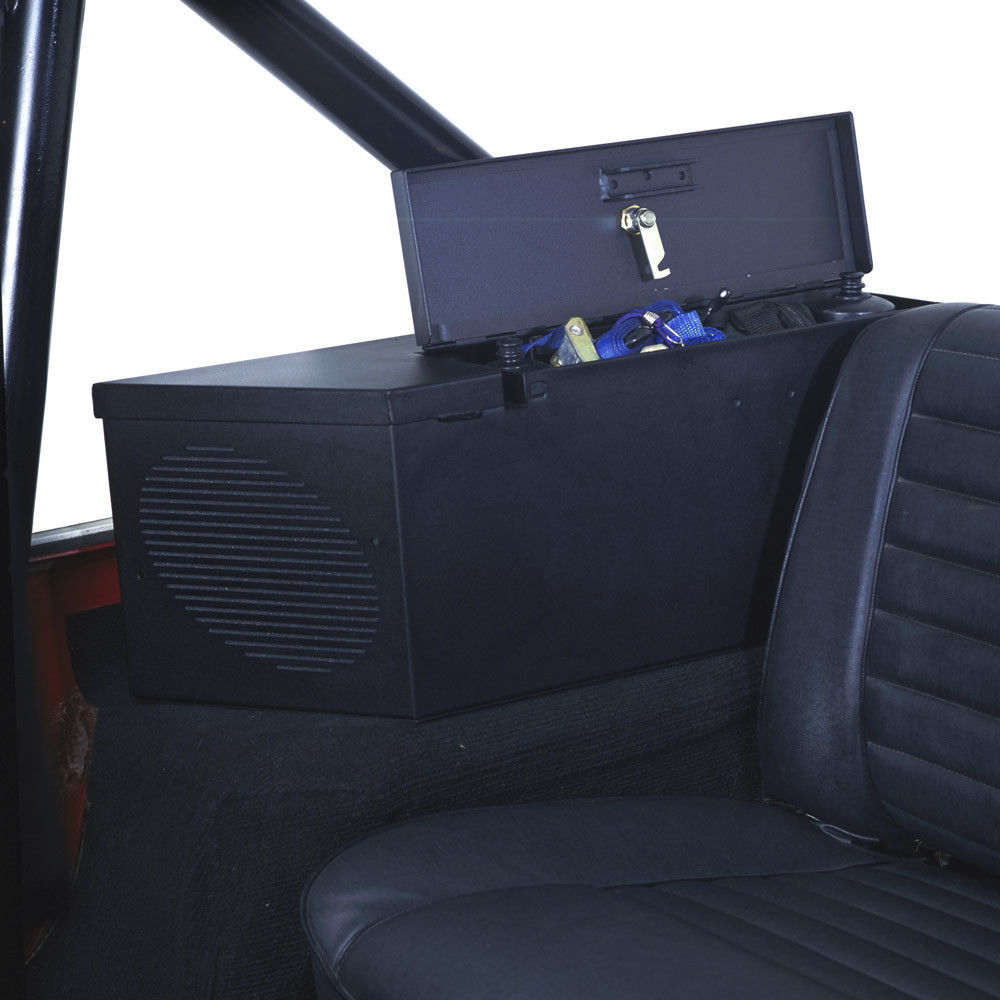

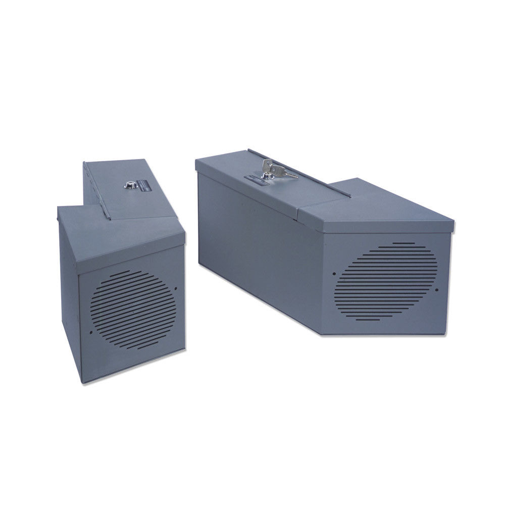

I have already moved my flashing lights up on the ROPS and I will be mounting two TUFFY Storage boxes (one each side) onto the platforms above the fender and hand hold and below the lights. The Tuffy boxes are made for Jeep CJs and have a cutout to clear the roll-bar in the Jeep. They are waterproof, spacious, and they lock. I already have a set and would not be inclined to buy a set for around $300.

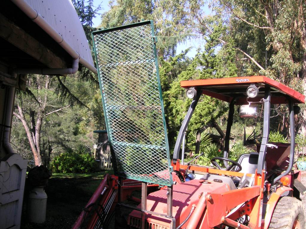

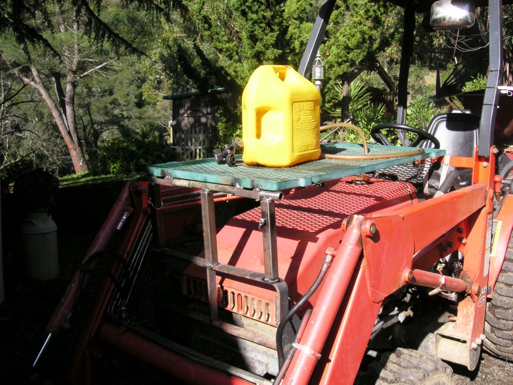

Lastly, if you regularly carry large items like chain saws, fuel cans, small generators, etc., you know there is no place to put them. Here is what I did with my previous tractor, a Kubota B21 TLB with a FOPS. I am adding a FOPS to my G3038H so I will again have two uprights forward of the dash so I may do this again. This tray was used VERY often at my ranch where I had a mile of mountain road to maintain and ditch well away from the barn. The hinge is simply round tube inside square tube - strong and simple.
