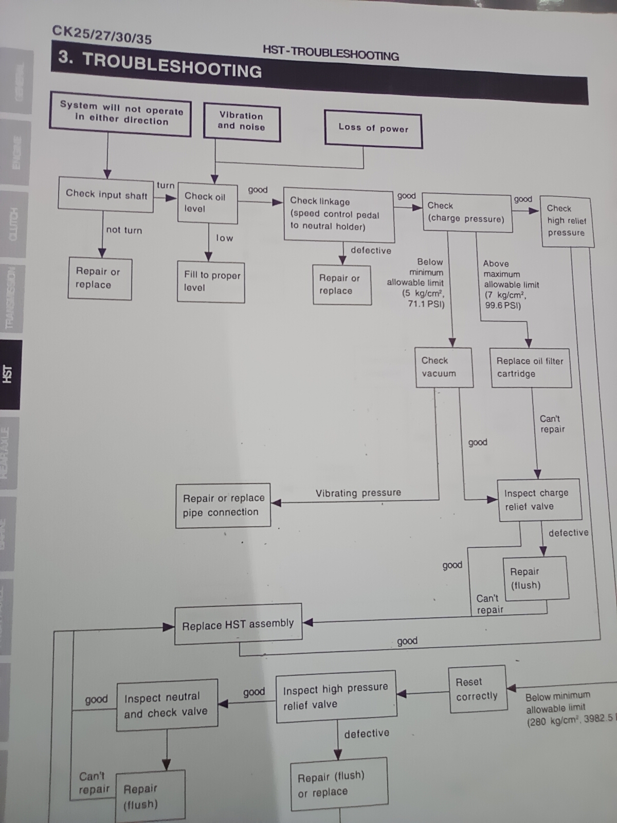

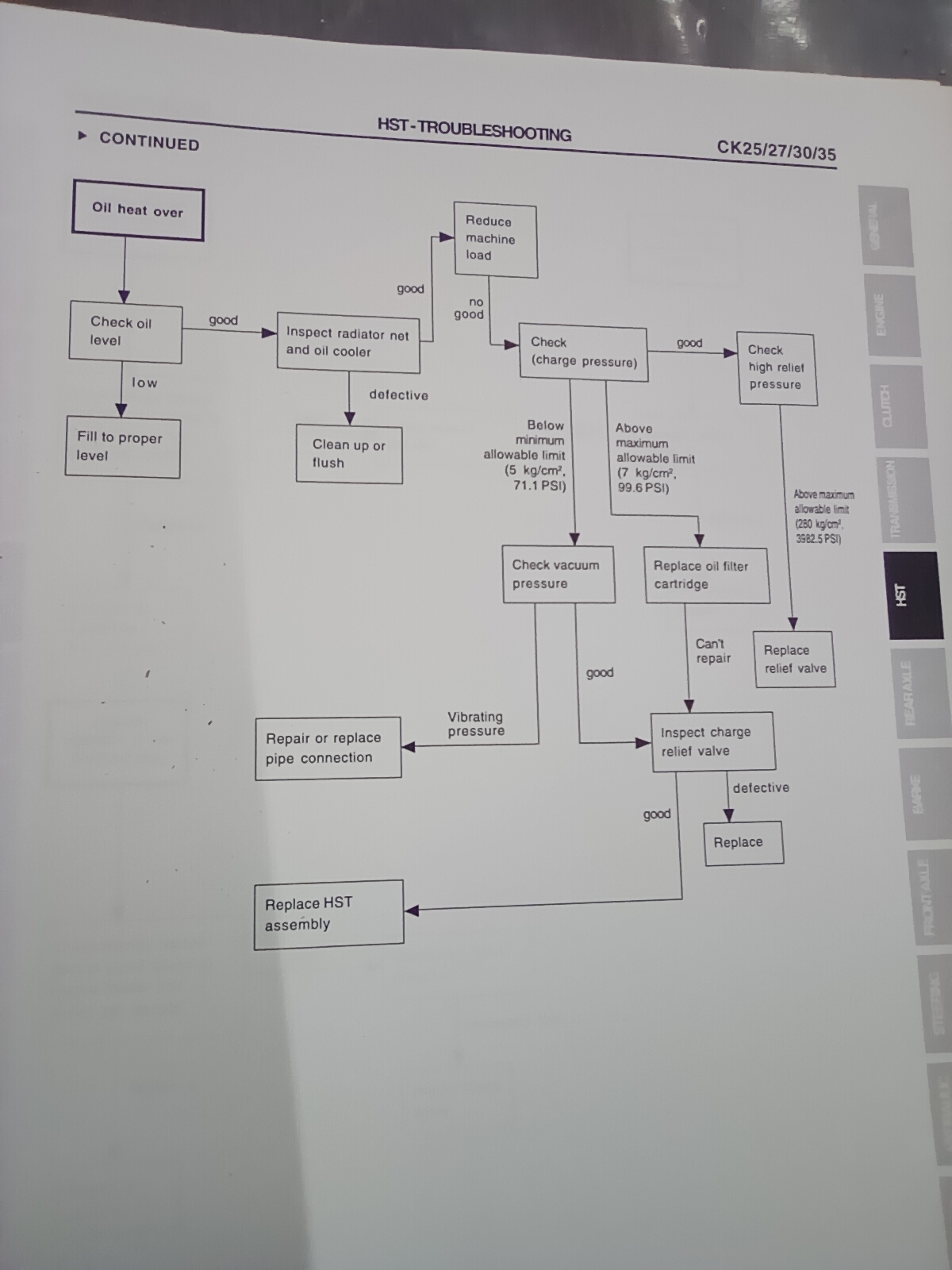

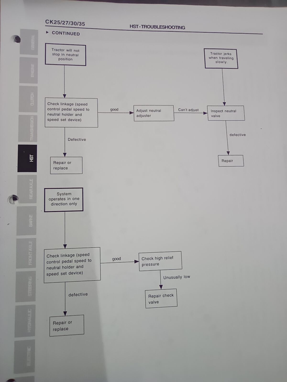

Trouble shooting section

The tractor will move forward and reversefor a short distance and then it is like it is in neutral. Rocking foot pedal back and forth a couple times and it will move again.there is a noise like a stomach growling and then it starts to move.

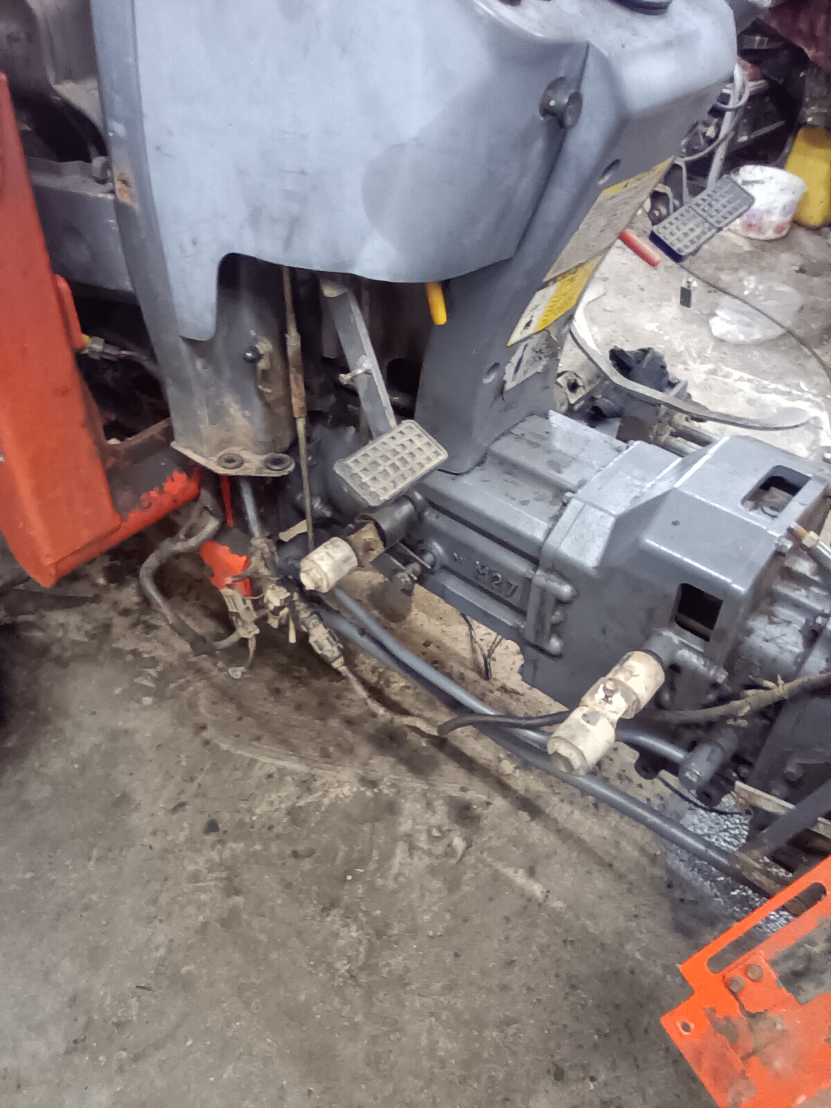

Today I removed wheels,fenders,floor boards etc to be able to get a better look. I found the pressure test ports and relief valves. Ordered a hydraulic pressure tester from amazon.I also found a couple of things I wasn't aware of. A small leak in the remote hydraulics but only when they are activated. The tractor has a form of cruise control and the lever to activate it does nothing.where the linkage enters the housing seems to be seized.I don't know if this could have anything to do with the problem.Any input much appreciated.Thanks,Len

The leak in the remote tube was at the but not the coupler. I tightened it and stopped that leak. The main hydraulic filter seems to be leaking very slightly. I cleaned it completely and checked it after a couple hours and it was wet.

I'm not sure either. But at least it is in the right system. What did you ever figure out on the Kioti clutch? Does it have one? If so, can it be locked or adjusted?
