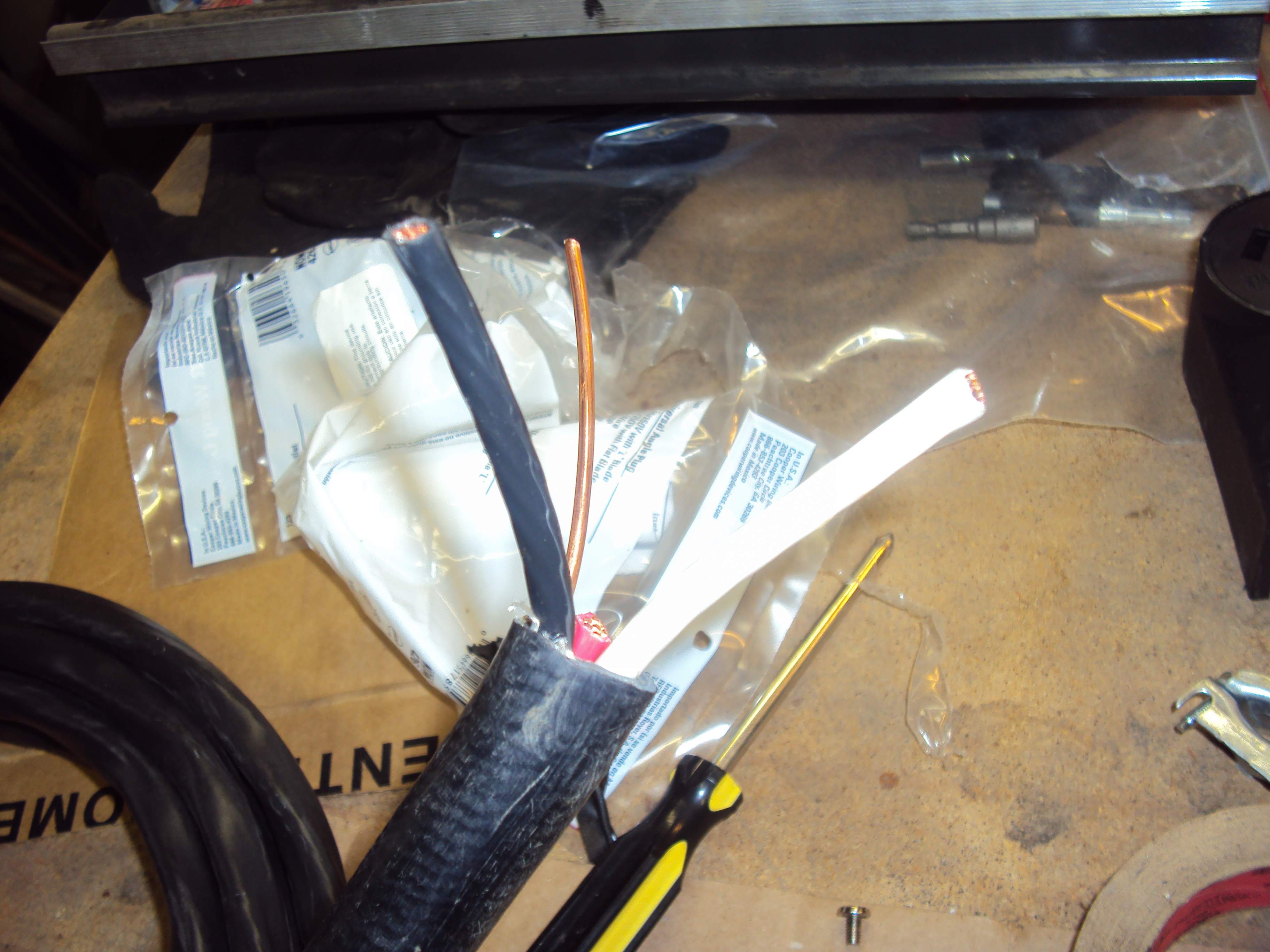

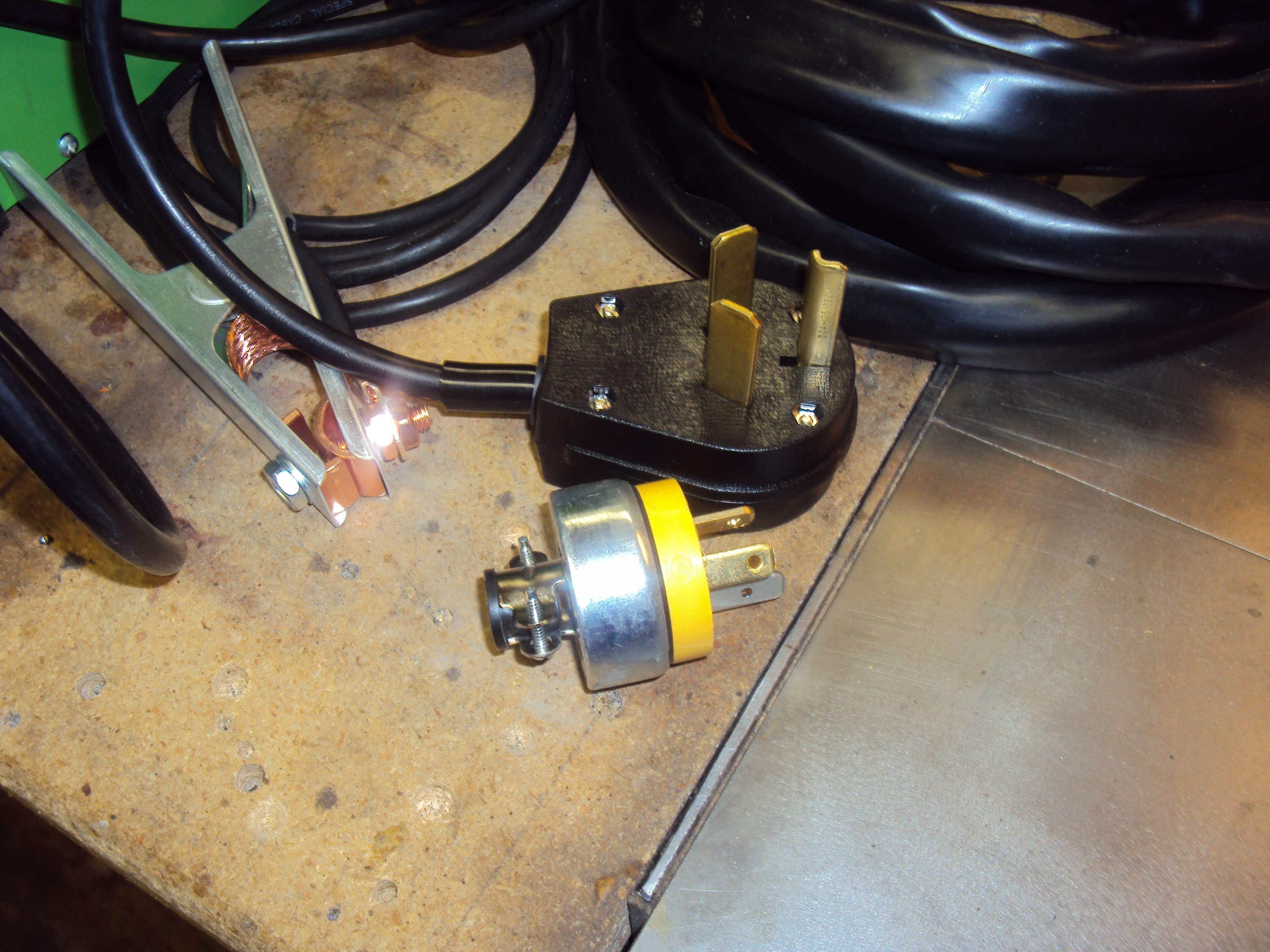

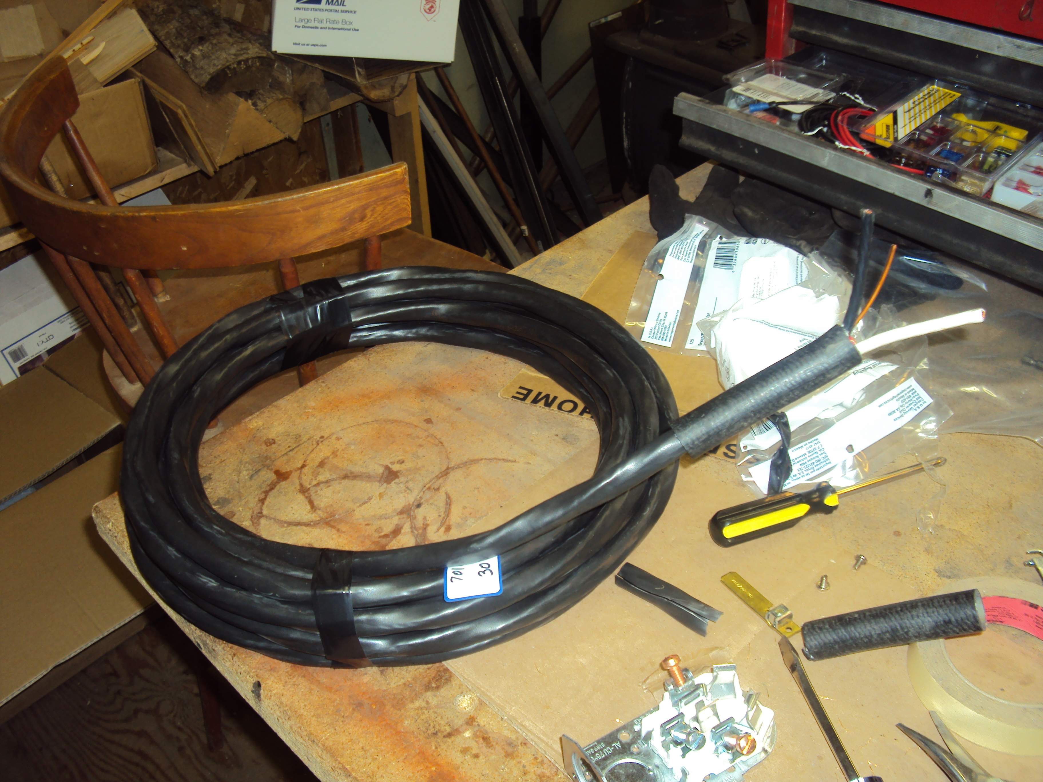

I made my own 30' extension cord, out of 6ga 3 wire service cord. I did this for a couple reasons. Number 1, is the fact that I could not find an extension cord that was 6 gage. Number 2 is that I had a couple of dryer plugs on hand, ( this type of plug was what the shop was already wired for, so I stuck with them.) Number 3, I can use this cord to hard wire the 50 amp outlets, on my new shop addition. I am convinced that to get the most out of my welder, or plasma cutter, I want the 6ga. So in my opinion, get the largest cord you can. Even if it is impractical to have a 100' 6 ga cord,get, or make a 50' cord, and if you have to get closer, then step down to a smaller ga cord. The closer you get to your work, with no voltage drop the better.:thumbsup: Just my two cents.
