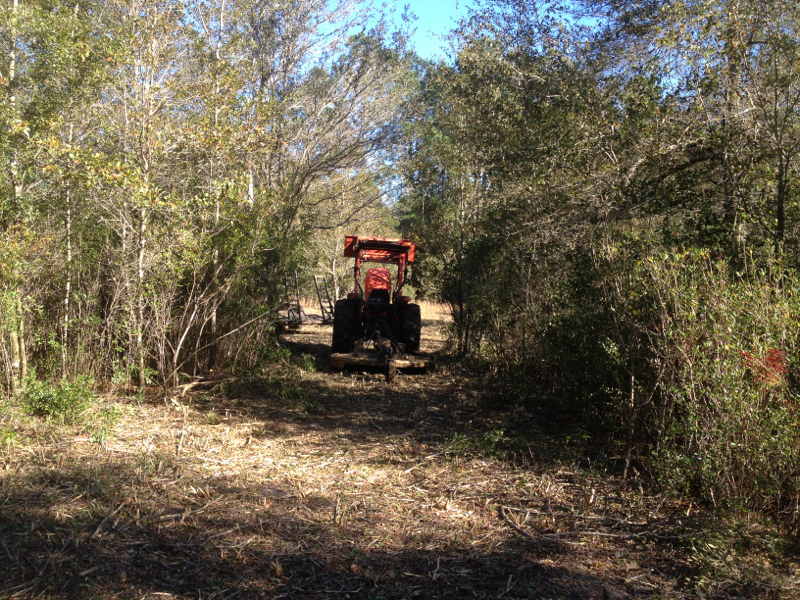

This is some heavy brush I cut with a Landpride RCR2672, as you can see I had stopped to clean out screen.It was a 10 acre property, I give that cutter a hard time and it has done very well.
