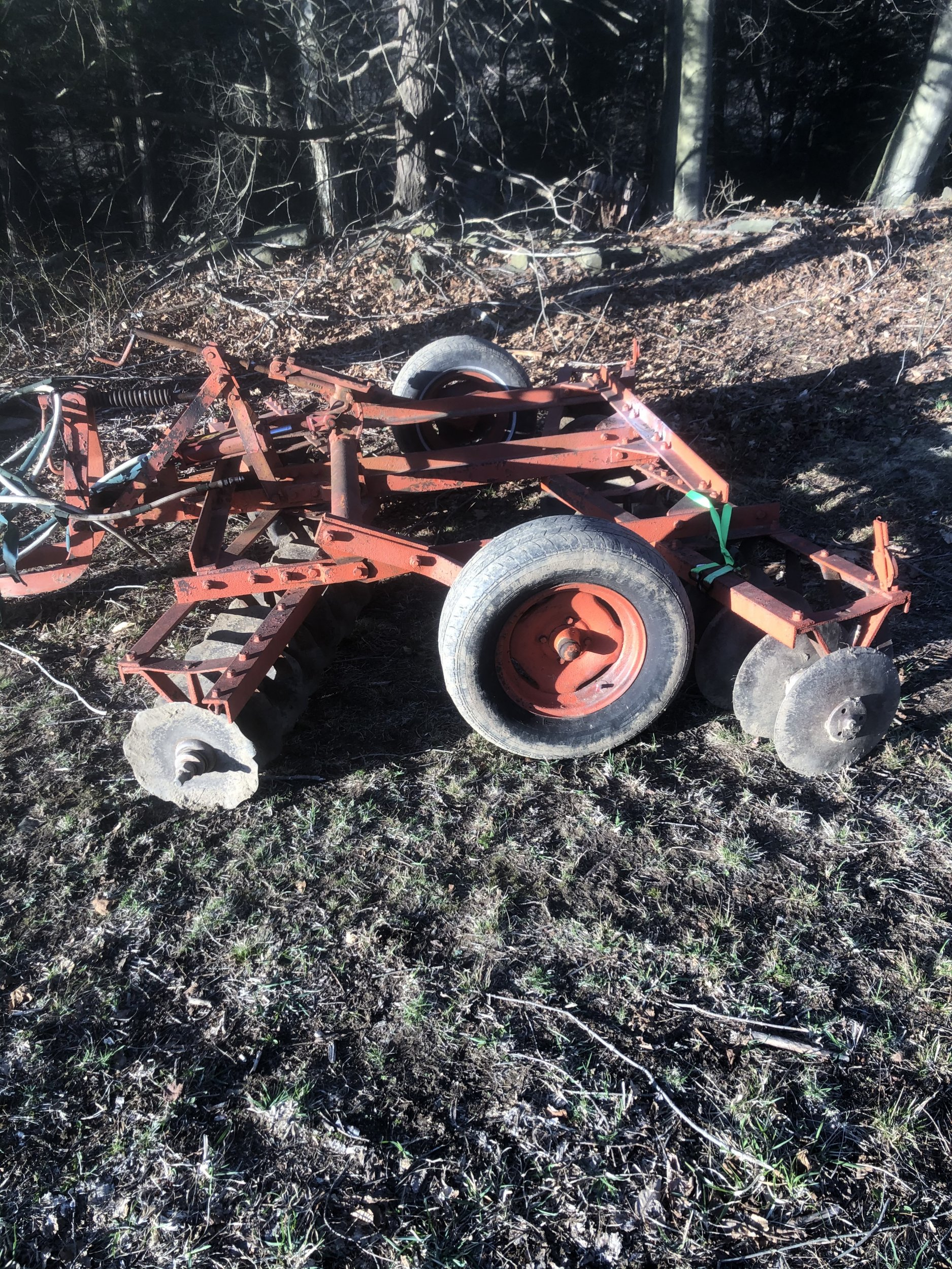

Can anyone identify the manufacture and model of this disc I recently purchased it and need to repair it and the previous owner didn’t know the details

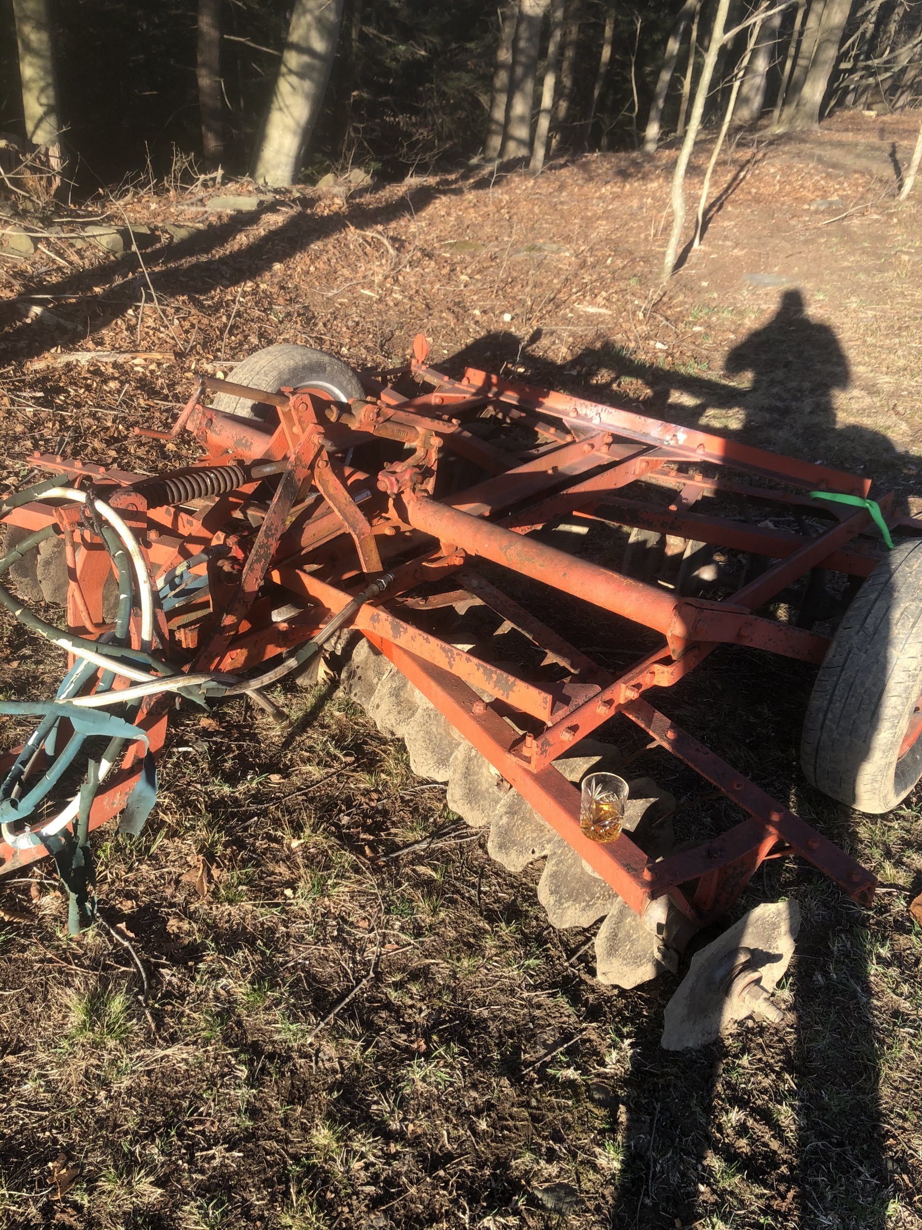

Don't know, but I like the ratchet straps and the Whiskey. What parts are you needing?

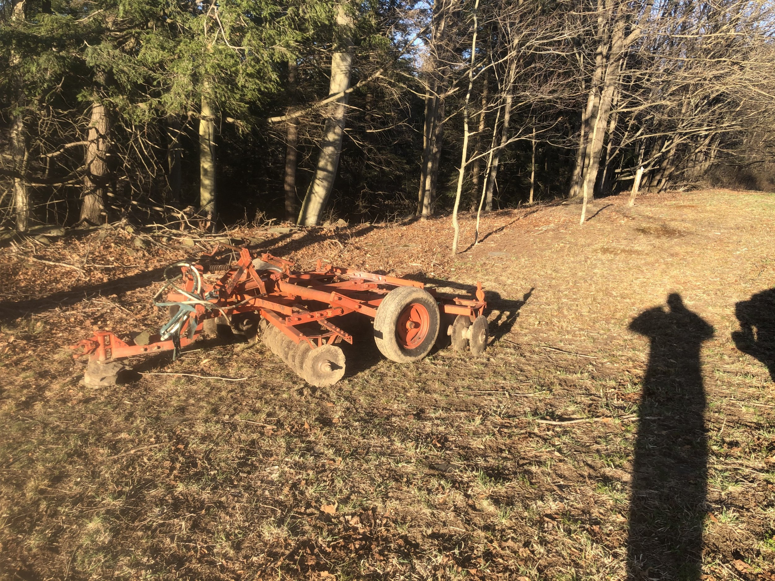

I need snap ring to hold the discs themselves in place that’s why the strap is there and then a couple discs are loose
   / Can anyone identify #4
Is it a snap ring, or more of a spacer? Maybe if you could post a couple of pics of the good part and the missing part, others could help.

It doesn't look like the Massey or International discs I've seen, or deere or most others, fixed angle wheel discs aren't common from what I've seen at auction unless they're cover crop discs...
That said, I'm not sure what's going on, if it's loose where the strap is and if discs are loose you likely need a new bearing housing, from the looks of it it's plain bearings. As crazy as they look they're pretty common and cheap at I think Messics and Steiner or something, I don't remember... Most discs don't have "snap rings", everything is held together by the nut at one end of the shaft, if discs are loose that nut has worked loose or something in the middle is broken like a chipped spacer or bearing casting. Usually the bar the discs are mounted to is square, finding that square size is the key to ordering replacement parts, most of them are generic...

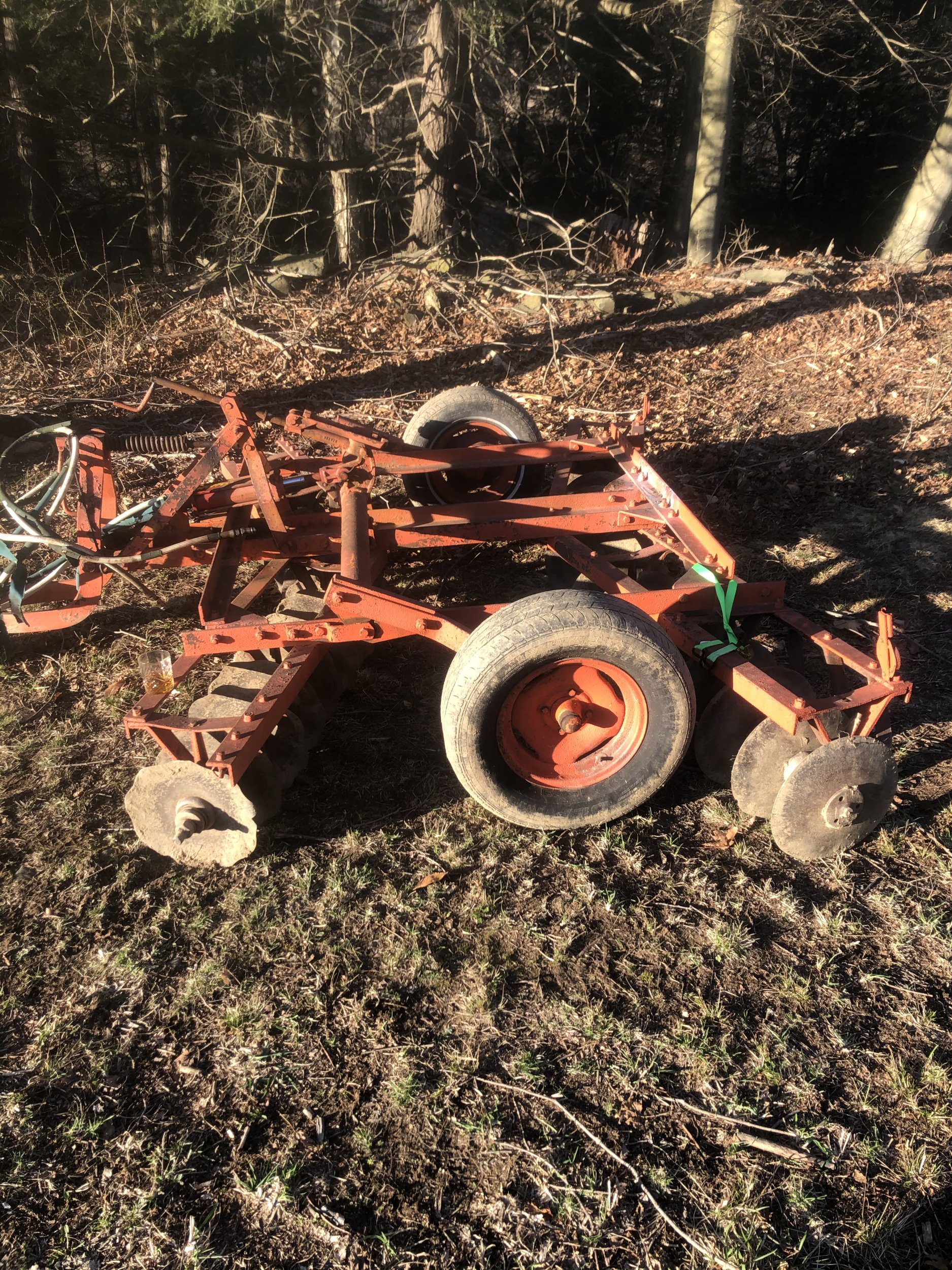

If it's a spacer, you could make one out of wood, saw it in half longitudinally, and clamp it on the axle as a temporary fix that would probably last for a long time.

That disc has several similarities not the least being color, to an Allis Chalmers disc a neighbor had. I think his was made in the 1960's.
