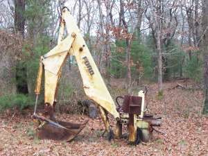

Anyone know what size this hoe is from the picture? Yeah I know it is asking a lot.

Kind of looks like a FORD. :D
Send a Soundguy a PM. He seems to have a lot of info on older model tractors.

Besides the obvious that it's a FORD, I'd say it's off of a 1970's era 455 or 555 TLB. There should be a serial # plate on it or some identifier that you can take to a Ford / NH dealer for positive ID.
I spent a few hundred hours on a 555 back then. At that time they were the strongest backhoe / loaders on the market. I could outlift and out dig any JD or Case in the same hp class around. They were harder to run because they had 4 lever contols instead of joysticks.

I think it's strange how the dipper and cylinder attatch to boom. Compare pics

I think joe48 has probably come as close as we are gonna get untill the sn tag is read. Deffinately looks like a ford industrial hoe.
Get the sn data plate info and we can go from there.

Thanks guys for the info. The seller emailed me back finally stating that the hoe stands 9 feet tall as seen in the picture. I think the 445, 545 or 555 may be correct. I was thinking of getting this for my tractor but it is wayyyyy too big for my little machine. I should have know the yellow color was industrial use. For $650.00 it would have been a steal if it was small enough.

NO.
It's either a 713 or 723 hoe. Each hoe came in 3 flavors. 10, 12 and 14' depth. That one is either a 12 or 14' hoe. I am pretty sure it is a 14'er if it is indeed 9' tall. That would make it a model 19-301. If you measure the boom from the swing post to the end, a 14' unit will be about 9' 8" long. It would weigh in about 2600 pounds without the bucket. If it has been plated up, it could be over 3000 pounds. The "FORD" should be in script and not block lettering.
They are very powerful hoe's. The 14' unit has 8000# digging force with the boom only. (that's a lot). They can take a 30" high capacity bucket that holds 10.6 cu ft, but most often are found with 18" or 24" buckets. They made bell hole or grave buckets too, and were popular in graveyards. Units from cemeteries are desirable as they weren't abused and damaged. Lift to load height is about 1500# for the 10', 2000# for the 12' and 2550" for the 14'. Hydraulic pump capacity requirements varied from 16 to 23 gpm. Pressure was 2000 psi. The 14' unit operates best at the 23 gpm, but honestly lift times are still slow with the 4" cylinder for boom and dipper.
The original design was by Wain Roy and was bought by Ford and turned into the 713 hoe. It was made from the mid-late 50's to about '60. The 723 was an improved model with some changes to the hydraulic cylinders mostly. At some point, I think still with the 713 series, the swing post was changed to a more robust design with a much larger horizontal pin. 1.5" going to 1 7/8"
Biggest knock on the units was (and is) the boom tends to drop extremely fast. It can be modulated, but a very light touch is needed. The 4 stick controls are also non-standard and some say bass-ackwards.
I don't know how big your tractor is but you would want to be about 10,000# for the loader, hoe, tractor and weights. Ford recommended 1200# of filled tires and 1400# wheel weights.
Any more detail needed? ;-)

Thanks for all the info. It is WAAAAAY too big for my tractor. All the info here saved me a 120 mile trip to go look at it. Of course the seller could have done that with just a better description of it.

I sure am glad I found this site. We have one just like it and couldn't find out what it was. It is on a Ford 801. We are looking for a boom cylinder with 1 1/2" pins, or if anyone knows where there might be some for parts for a poor farmer in TN.

That is a Ford 723 Backhoe from the early 1970's. It was the predecessor of the 750/753/755 models introduced in 1965. It was manufactured in Royal Oak, MI in the former Sherman facility as the 723 had actually been built by Sherman prior to them being aquired by Ford.
John Bud gave a very good history. Waino Rajala was the father of the WainRoy bachoe.
The 4-lever controls were said to have class (Crowd Lift Actuate (bucket) Swing). The system really was easy to use with just a little practice.
