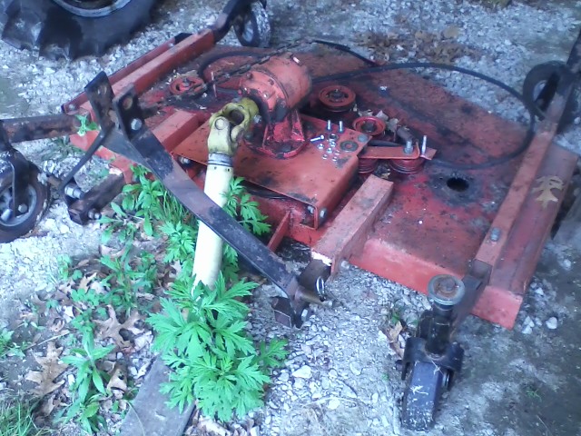

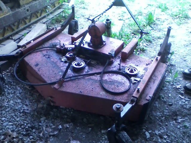

Hi Guys, I bought this finish mower (see pics) at a farm auction and need to replace one of the spindle assemblies, the problem is there are no markings on the machine at all. I'm hoping one of you guys can help. Thanks.

Someways it looks like King Kutter.

I'll 2nd Thomas. It looks exactly like a KK just a funny color.

I think you guys nailed it. Thanks for the help. I'll be calling gulf south equipment tomorrow.

Yep, the wheels were a give-away for me. More specifically, the mounting and tube arm. KK is my vote.
What is wrong with the spindle that you need a whole assembly? Could it be just the bearings are bad??? If that is the case, take it appart and get the #'s off the bearing and/or the size of them. PRobabally a pretty common bearing that can be had for a lot less than the KK mark-up. Same goes for seals IF it has them.
