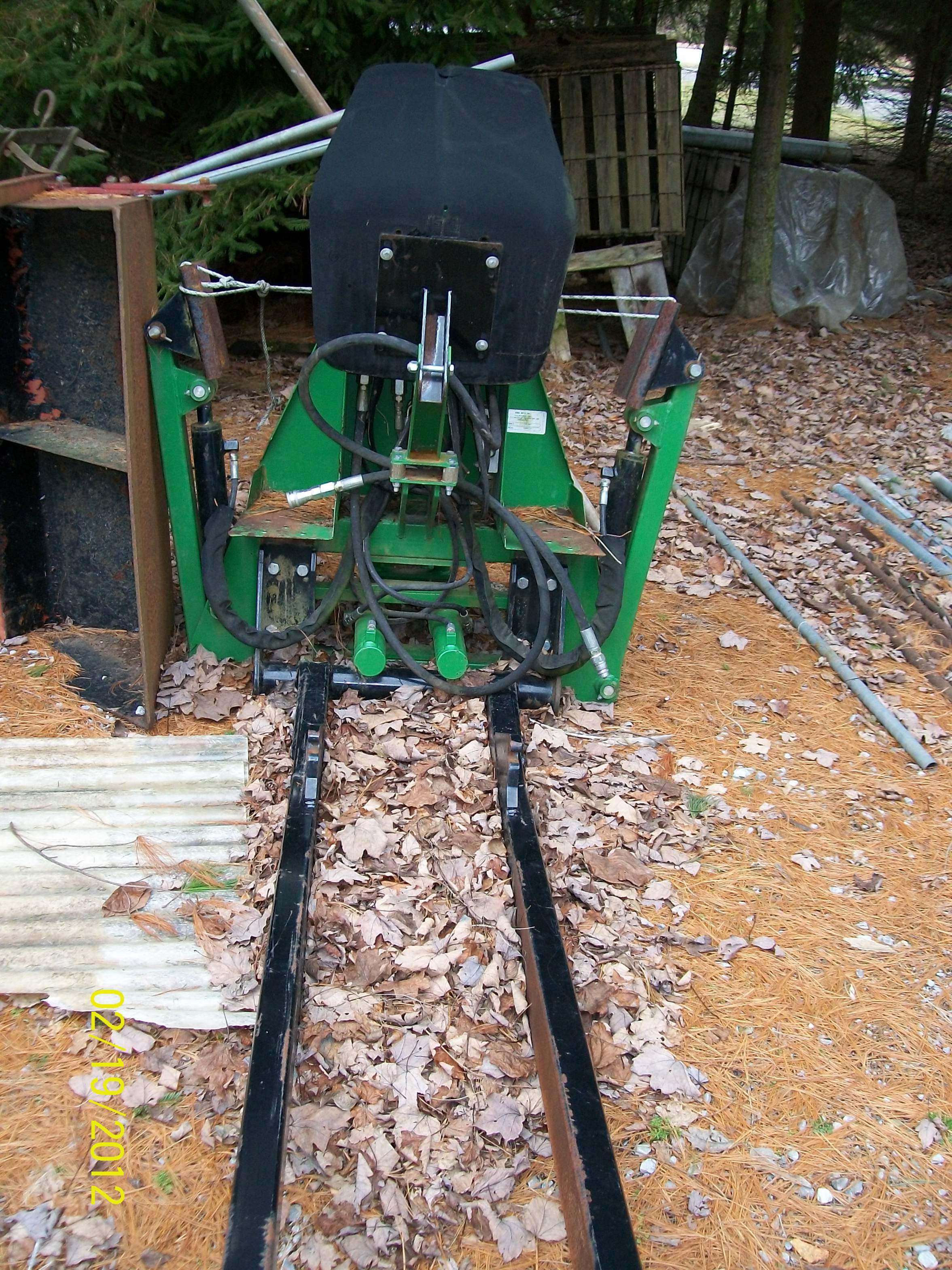

I have a Wallenstein backhoe GX 600 on a John Deere 4310 subframe! Can it be attached to a John Deere 4110? Any helpful advise would be appreciated. Thanks.

Cannot say for sure, but I believe the 4310 is a larger frame than the 4110.
Not exactly sure what you refer to when you say "subframe".
Others may be a lot more help.

Thanks. This is new territory for me (Forums & tractor attachments). Sub-frames are generally bolted on and can be interchanged to suite the model correct?:confused2:
   / Can a SubFrame JD4310 attach to a JD4110? #4
The picture of the frame that you added does help. ;)
I'd suggest measuring it and see if the frame has a place to bolt it onto the 4110, or if not then how might it be altered to work.
Still would be sure that this backhoe is not too large for the smaller 4110.
That said, a search turned up this thread that just may be very helpful to your decision.
http://www.tractorbynet.com/forums/...29428-picture-wallenstein-backhoe-jd2210.html
Some pics there showing the hoe on a 2210 with some warranty comments.
