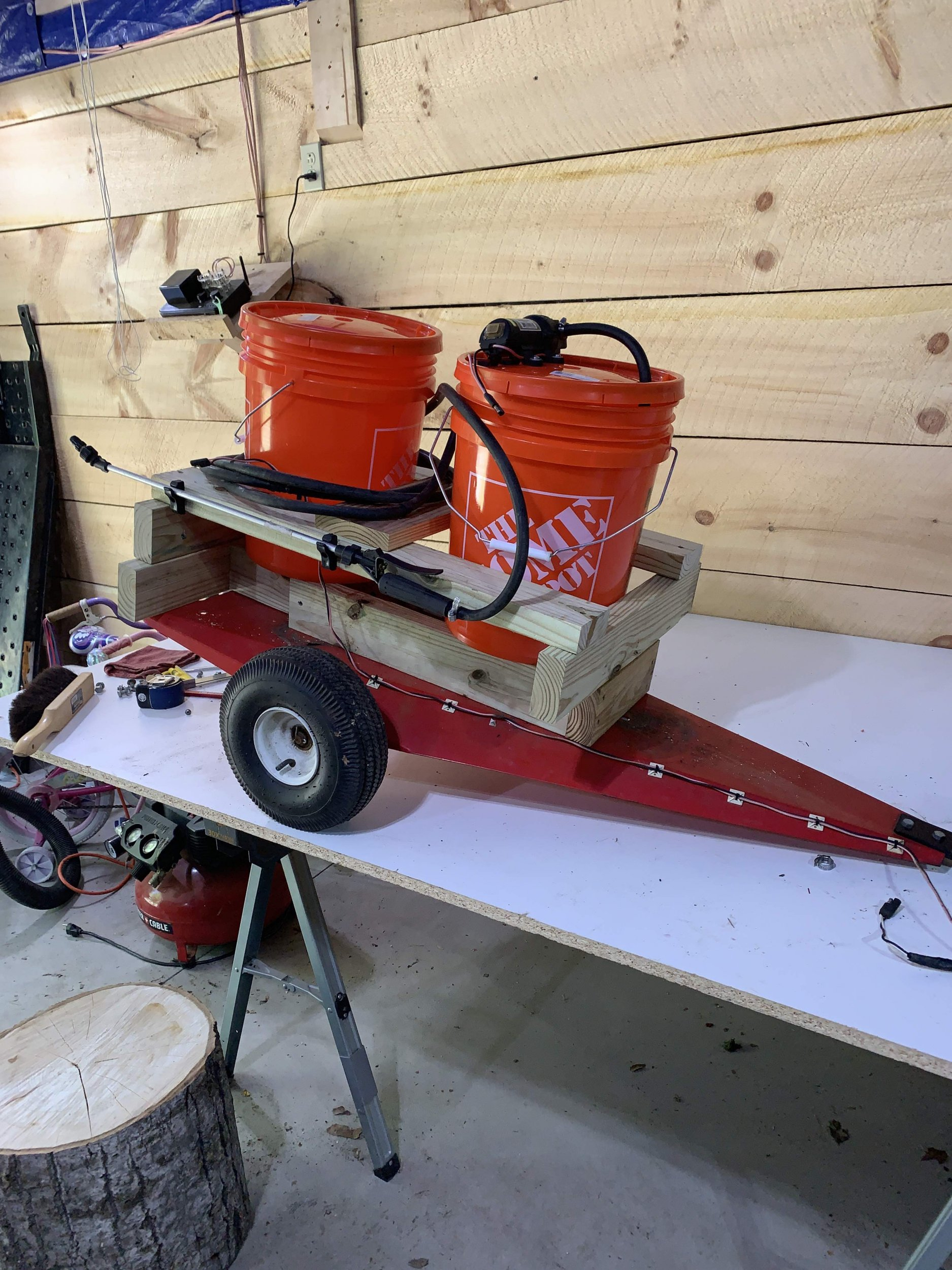

I had a small fimco. Replaced tank. Broke again. Then the pump went. Reused the trailer and hose, got two 5 gallon buckets and got a cheap pump on amazon. I'm happy.
