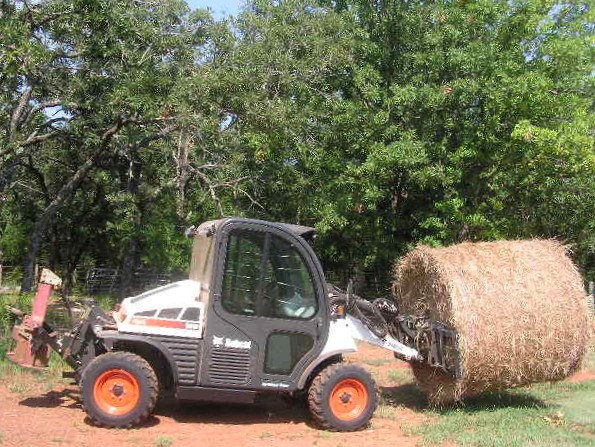

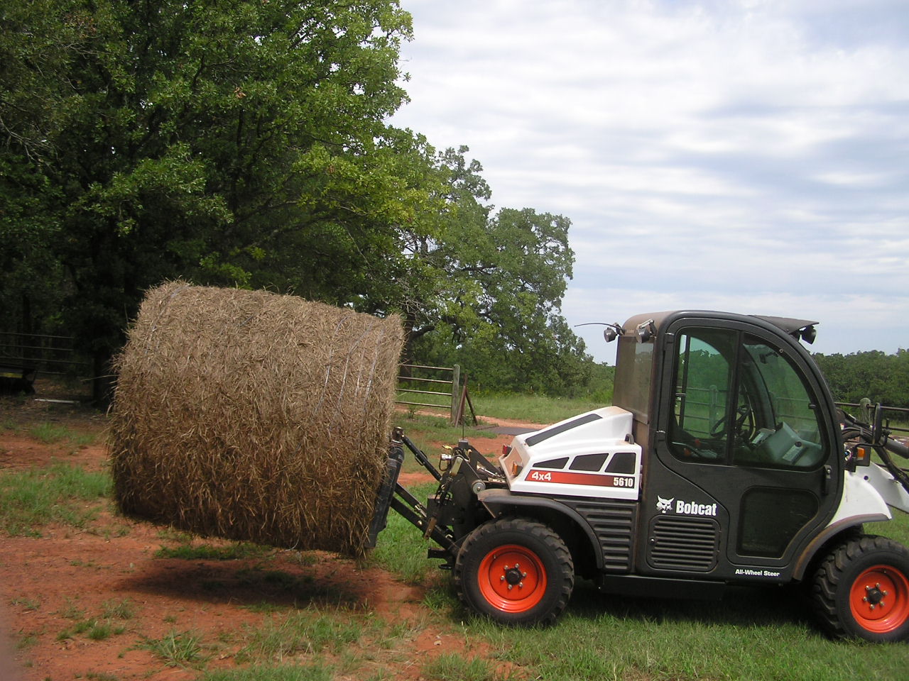

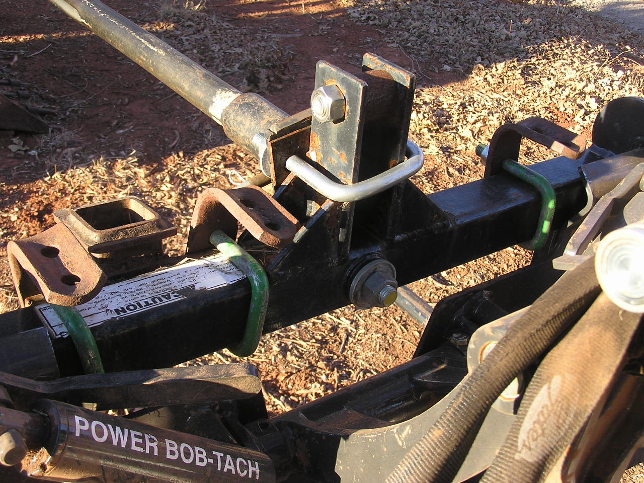

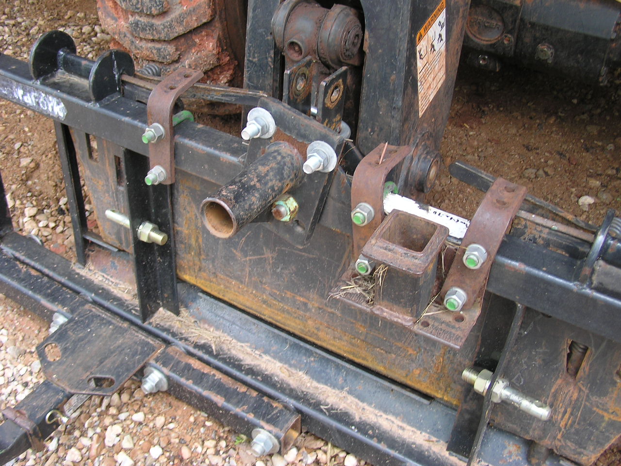

I added a bale spear to the Speeco Ultra Fork. The base is designed to bolt on and the spear is held in with a pin:
With a 5x6 bale, front SSQA or 3 point:

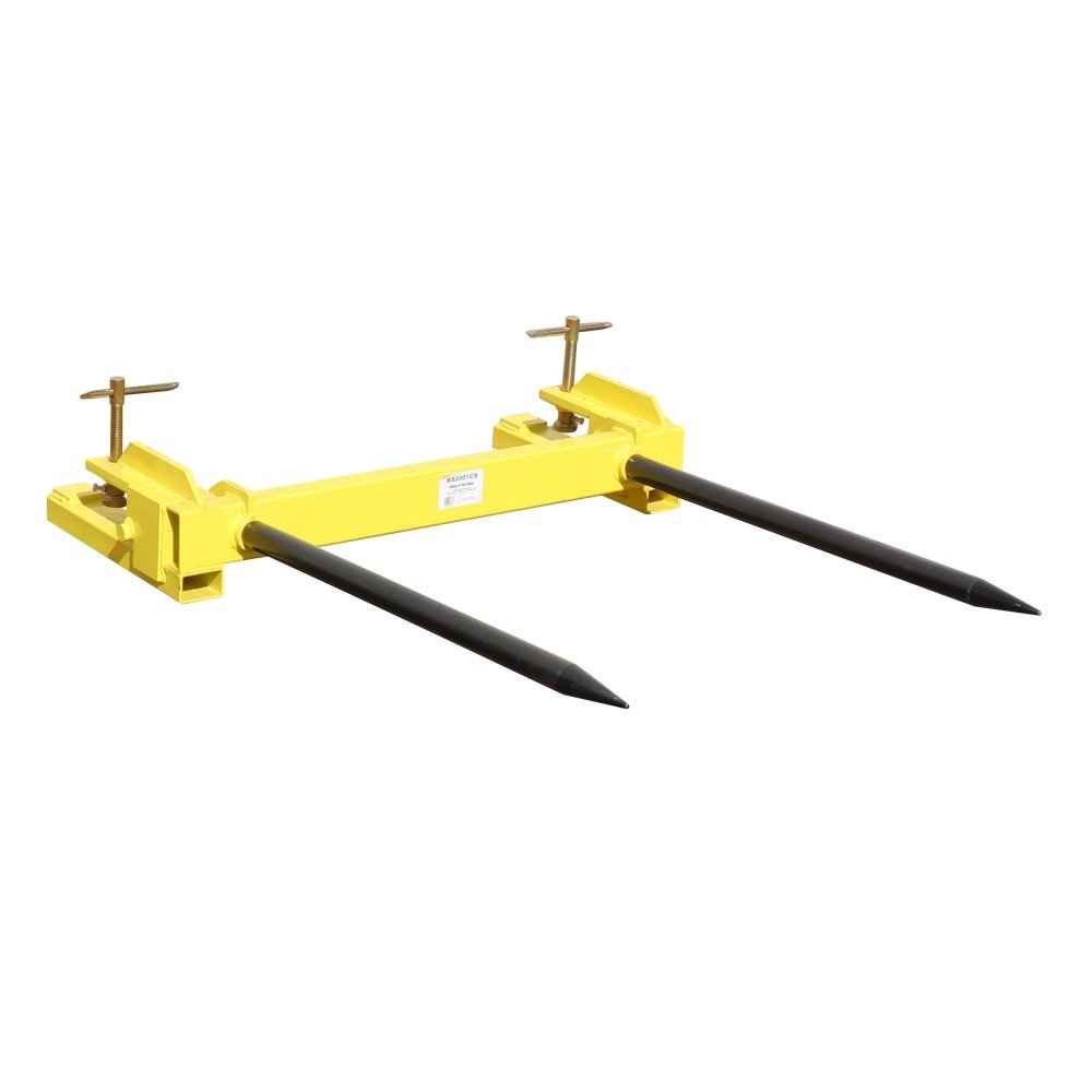

I am thinking of something like this one, but as a loader attachment:
Titan Clamp on Hay Spear Attachment | Dual Spear
Either using dual spears (but they are closer to $100 each near me), or 2 forks.

The spear that I have now is a commercially made 3-point hitch spear with two spikes like you mention on the sides. That works very well, but it does not let me stack them high enough and if I'm going to be building a loader attachment, I would rather put two spears or cut down forks on it so that I can use it for moving pallets as well.
