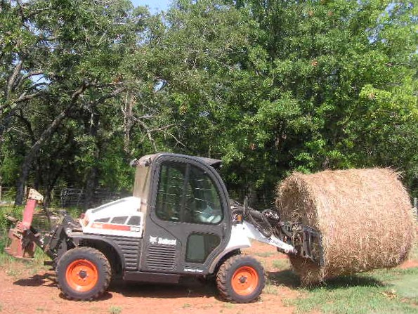

I added a bale spear to the Speeco Ultra Fork. The base is designed to bolt on and the spear is held in with a pin:
With a 5x6 bale, front SSQA or 3 point:

Axles do fine but hard use they will bend . My spear will not bend . That's why I built this one .

Your spear is a lot better design than just cutting the fork into a V. The OP only has a medium to large compact tractor. I think a big truck axle would take all the abuse it could offer.

Its a bad idea to cut down a fork, the jagged edges are crack initiations.
I bought extra strong bale spears for 15 euro a piece, put four of them in a fork so i can also stir trampled bale plastic out of the field when im out there putting a bale out.

A single spear will work OK but having a few short (10" or so) spikes under the spear and off to the sides will help you control the bale when you lift it. If you pick up a bale with a single spear it will spin unless you get it dead center very time (and who is that good?) and sometimes will spin anyway. Double spear is the best although I dont own one I have run a skid steer that had one and if you're going to be stacking these bales consider biting the bullet and buying a 2 tine.

The spear that I have now is a commercially made 3-point hitch spear with two spikes like you mention on the sides. That works very well, but it does not let me stack them high enough and if I'm going to be building a loader attachment, I would rather put two spears or cut down forks on it so that I can use it for moving pallets as well.
