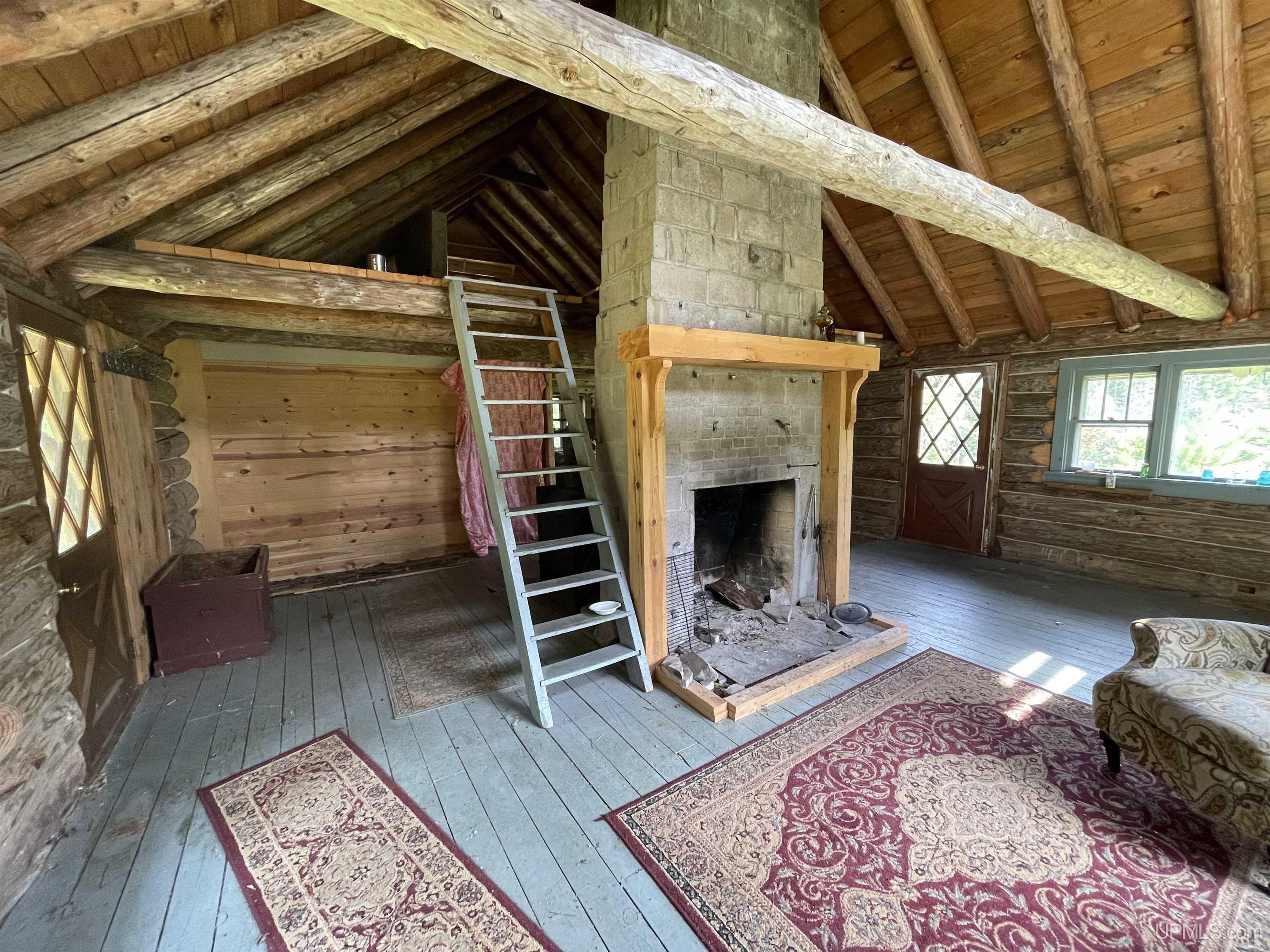

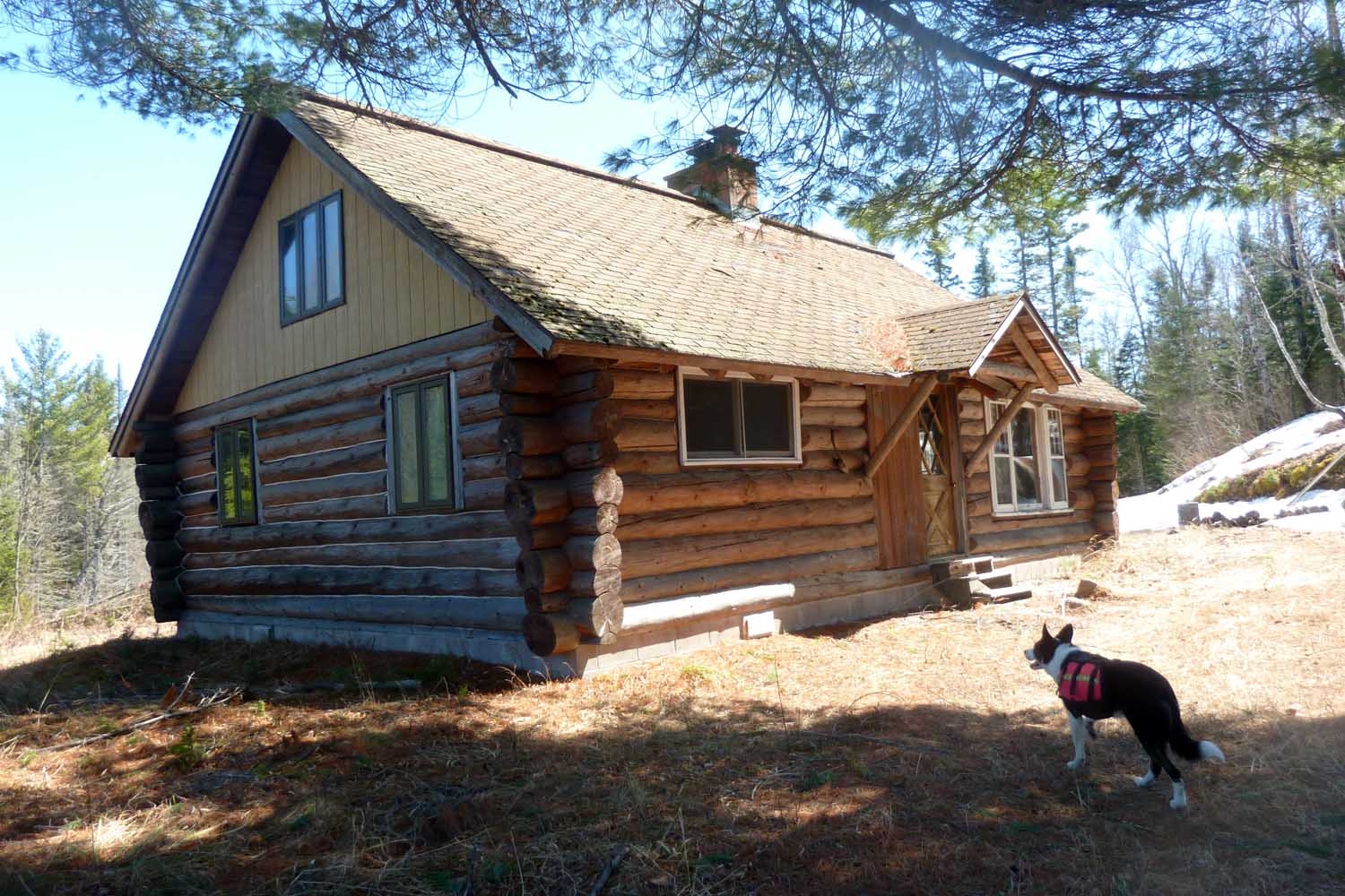

I'll try address the many comments and questions.
No well or septic. The owner claims that its sold rock just below the surface but we will confirm this in time. They gathered roof water for showers and washing, then carried in potable for drinking.
There is a outhouse now.
The road in is a logging path
that has deteriorated over the years from the lack of maintenance and that mean heavy haul were using it then. So we do not own it but can repair it which might be costly. Nonetheless we will check it better after weeds are cut back making it visible. Today, no one is using it other than atv type machines. Actually, there are no other cabins out there and surrounded by state forestry land.
We can not bring power in so will remain off grid and we do not plan to make it into a year-a-round residence.
They used two wall-mount propane heaters in the cabin plus a cook stove. Looks like we'll get gas in via 40lb tanks but in the winter, primary heat will remain wood stove. Again, all the wood stoves will be replaced with higher efficiency, safer ones.
