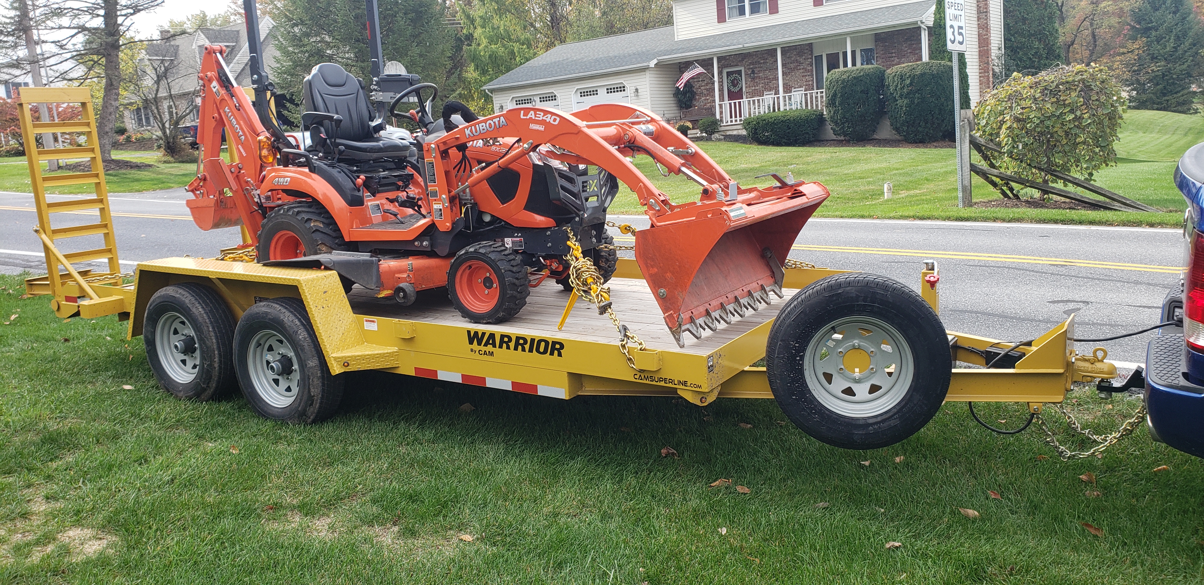

I got to tow my friend's BX about 10 miles today with the new trailer behind my Ram 1500 w/ 5.7. The trailer towed very nicely. Truck did fine too, never really broke a sweat.
