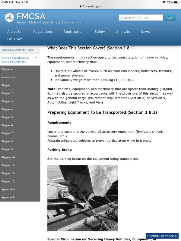

Everything is required to be secured even a bag of dog food. Two straps or chains are legally good for things up to 10,000lbs over that you need four. Pickup sides, side rails, dump beds etc make no difference. Most cops will use some common sense enforcing the law but per the law even little things should be strapped down in a pickup bed.

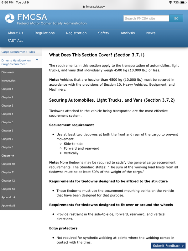

Legal requirements is a WLL of at least half the actual load weight. You only need 2,500 lbs of securement. Four 1k ratchet straps is more than adequate.
Grade 70 1/4 chain has a WLL of 3,150. Two 1/4 G70 chains would be much more than your entire load.
The legal requirement for two up to 10,000 and four from 10,000 and over us for vehicles and machinery, not other loads. Their securement is outlines elsewhere.
I stop a lot of people for improper securement. Mowers and ATV’s, are especially problematic.
