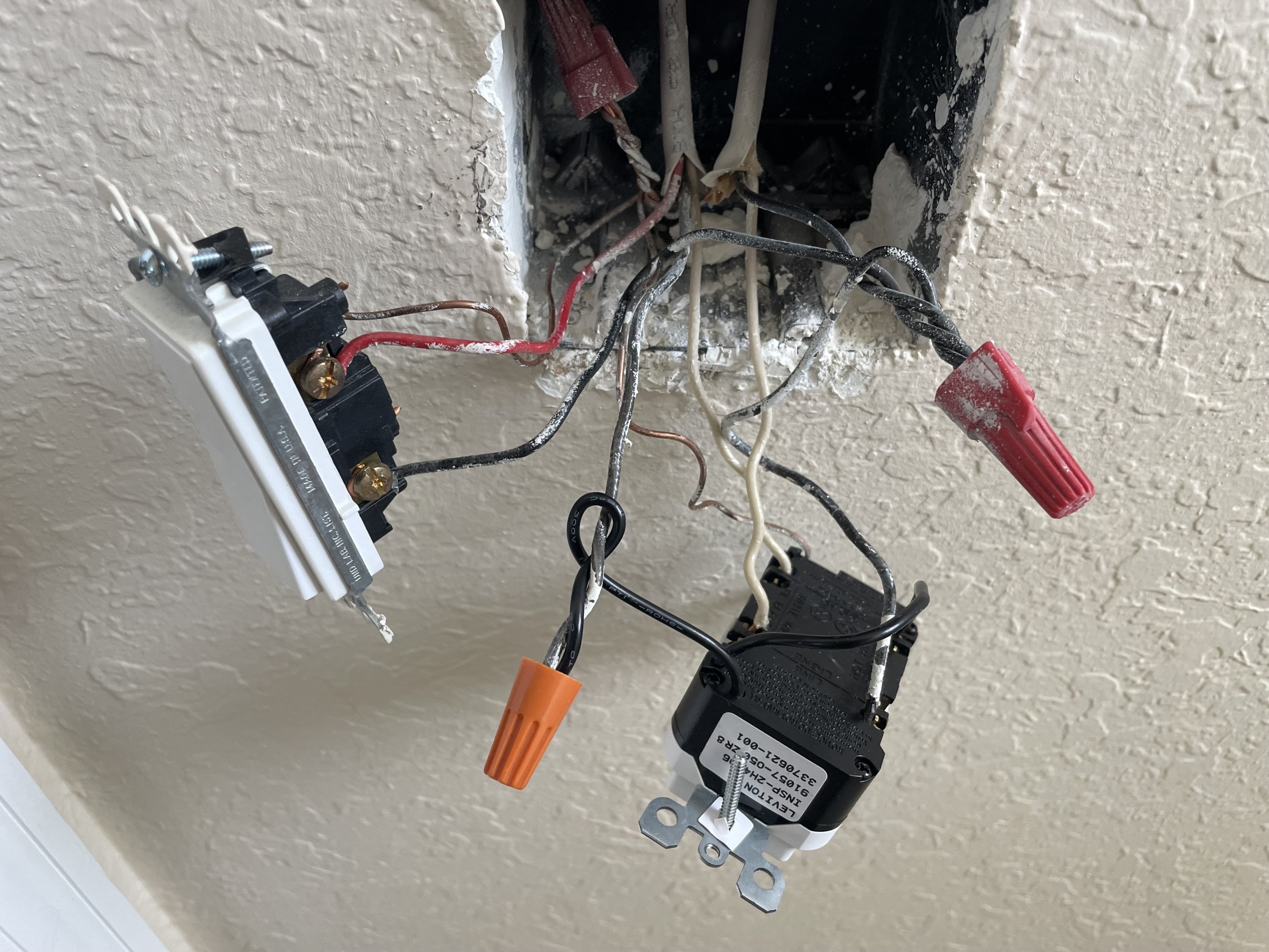

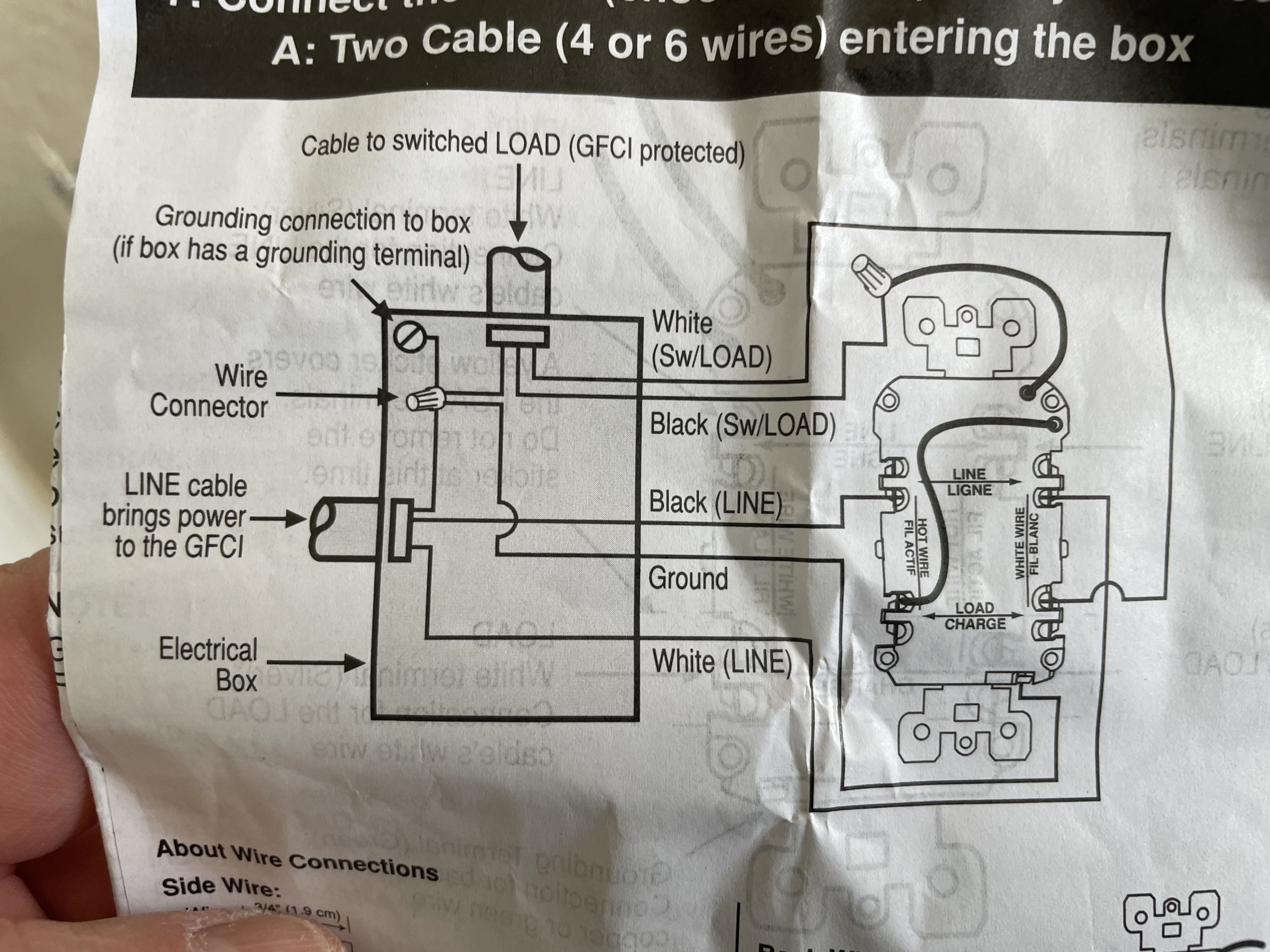

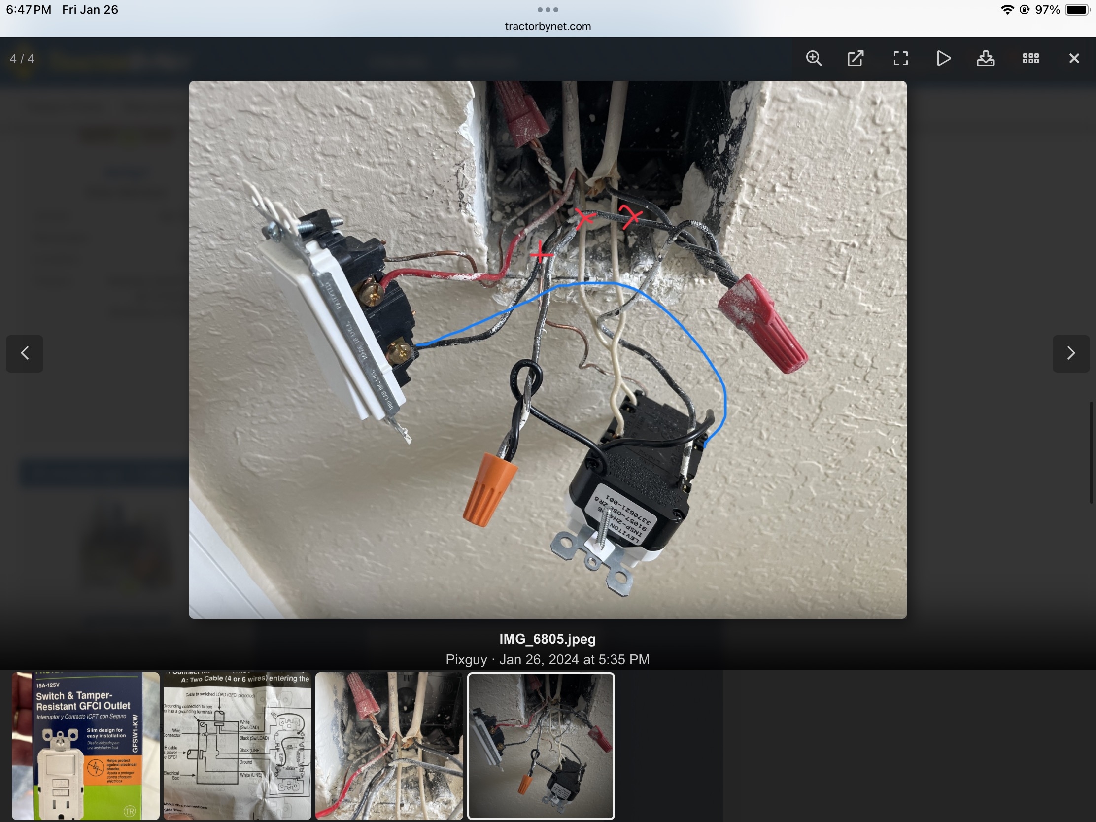

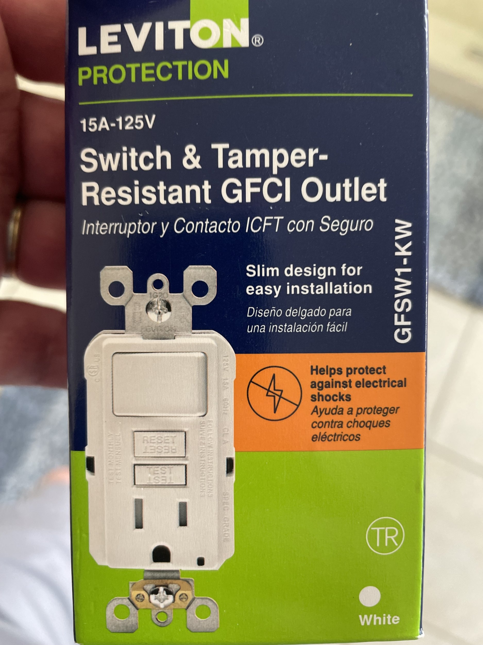

Hi all, I'm looking to add an outlet to the double switch plate I have in this toilet room so my wife can get in a nightlight. I knew I'm supposed to use a gfci outlet in a wet area so instead of adding in an old construction outlet below, I decided to put in the combo switch/outlet shown below. There's two sets of wires coming into the box, I don't have my volt meter here in Florida and the wires are 14/3 and a 14/2. It appears obvious to me that the 14/2 wire is power coming in and the 14/3 goes up to the light/fan. I followed the instructions but the gfi pops each time I turn power in.
What am I doing wrong?

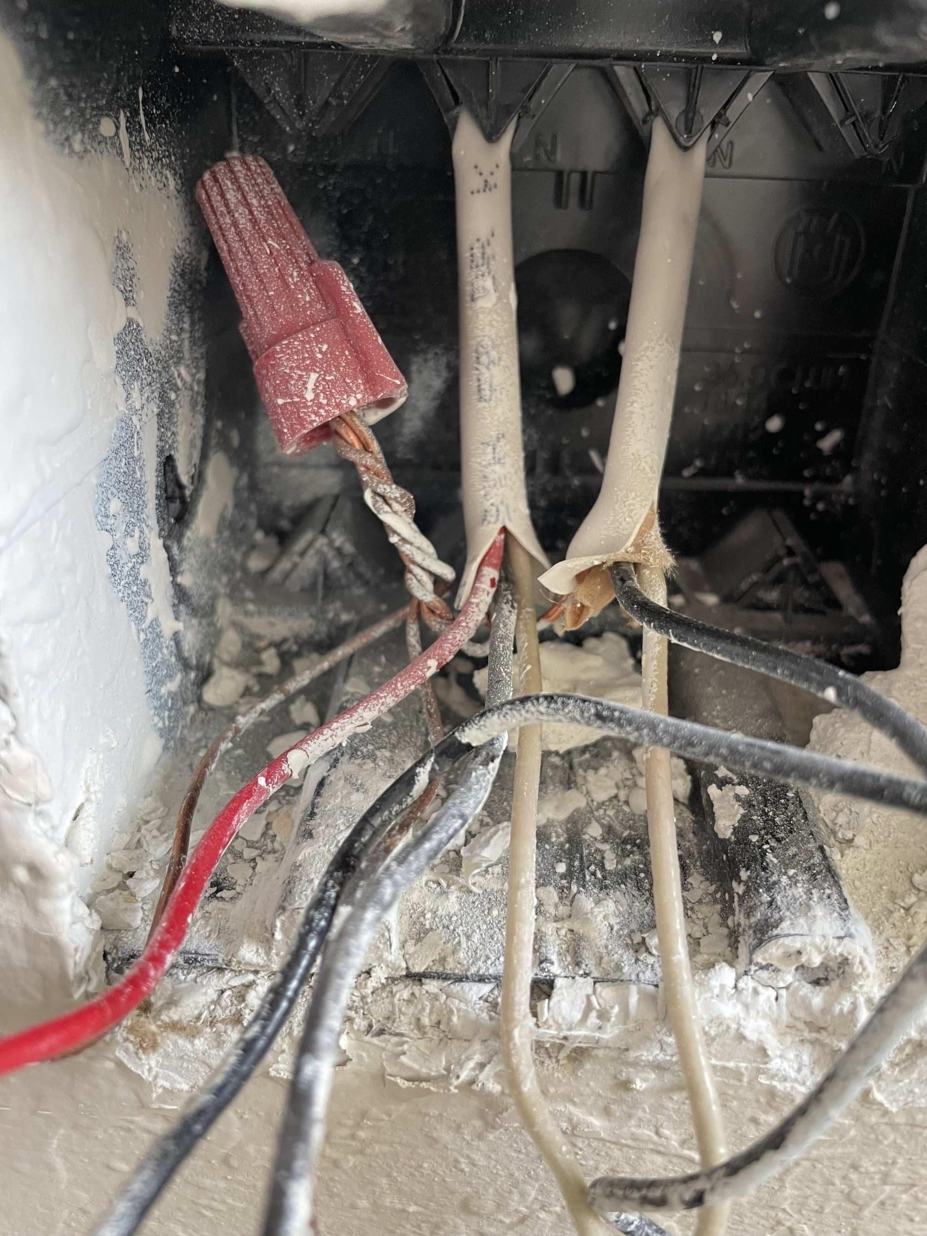

That's not a 3-way switch, and the presence of a red wire (the 14/3) indicates it may well be a 3-way circuit. Is there another switch controlling that light?
Also you really don't need a GFCI there...
My $0.02

Also, looking at that gfci. I think you need to power the fan switch from the load side of the gfci, not the line side. Ive seen gfci issues before where you split off a line to the device that receives its neutral from a gfci.

The 3 wires lead up to the fan/light
Please explain to me a bit more

i think you may sharing the neutral with both the light, gfci and fan but not having all the power going through the gfci. My money would be to splice the 2 whites together with a tail to the line side of the GFCI plug. Then the fan and light are not on the GFCI, only the plug.
