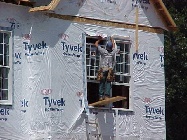

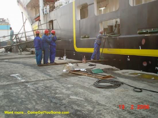

What's wrong with cantilevers? :)

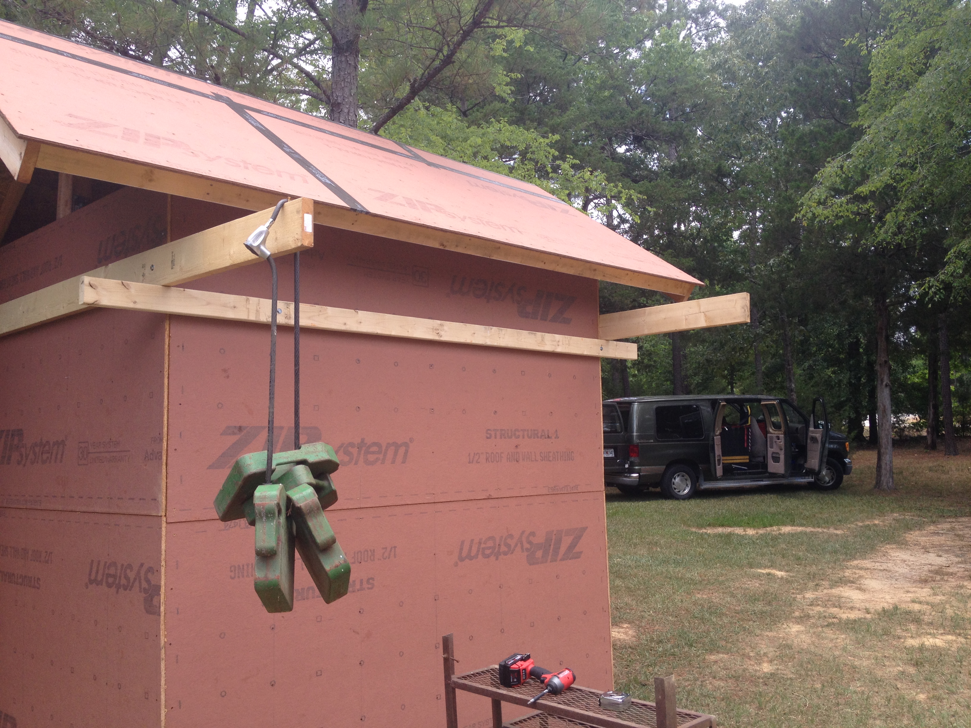

S219 - Your picture is almost exactly like my setup with the exception of the angled supports, I was going with a second board bolted directly under the extension but I believe your method would provide more stability even if the load bearing isn't a consideration. Taking the roofing out today and if it is not 100+ degrees I may do some testing.

Here you are ladies, empirical evidence
250lbs suspended 28" from the fulcrum. Placed marks on the siding and no movement or snap-crackle-pop for over an hour. Granted this is a static load but considering the weight will be suspended between two points I do not see this failing. So what do the naysayers have to say? If the best you have, is you can never be too safe, please crawl back into your bomb shelter and await a safer world. The rest of us acknowledge living is not a risk free endeavor.
   / Calculating Cantilever Load Limits - Rule of Thumb? #19
I think you are just fine.
That's just a temporary platform for doing roofing correct?
If so, I'd probably just stand in my loader bucket and be done.:eek:
