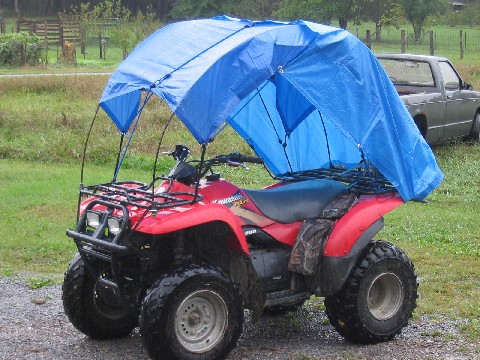

You can make one like this one Pretty cheep.
/ Cabs for the 425 #11
Sorry I don’t know what happened to the pic. I was just trying to be funny anyway.

/ Cabs for the 425 #12
The poor man's canopy! /forums/images/graemlins/tongue.gif
Hey, whatever works when you need it, right? /forums/images/graemlins/wink.gif
/ Cabs for the 425 #13
Thanks Moss I really am quite proud of it. I’m filling in a basement now and I will soon posts some pics of that work.

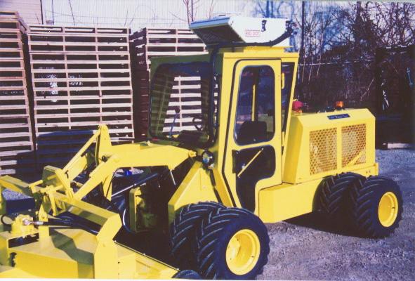

/ Cabs for the 425 #16
Hi Jaymar, when I talked with the Martin Cab company they told me that they had not made any for the 425, but they would be willing to do so. Tehy offered to make it and let me instal it or they would make it and instal. Hope this helps.
