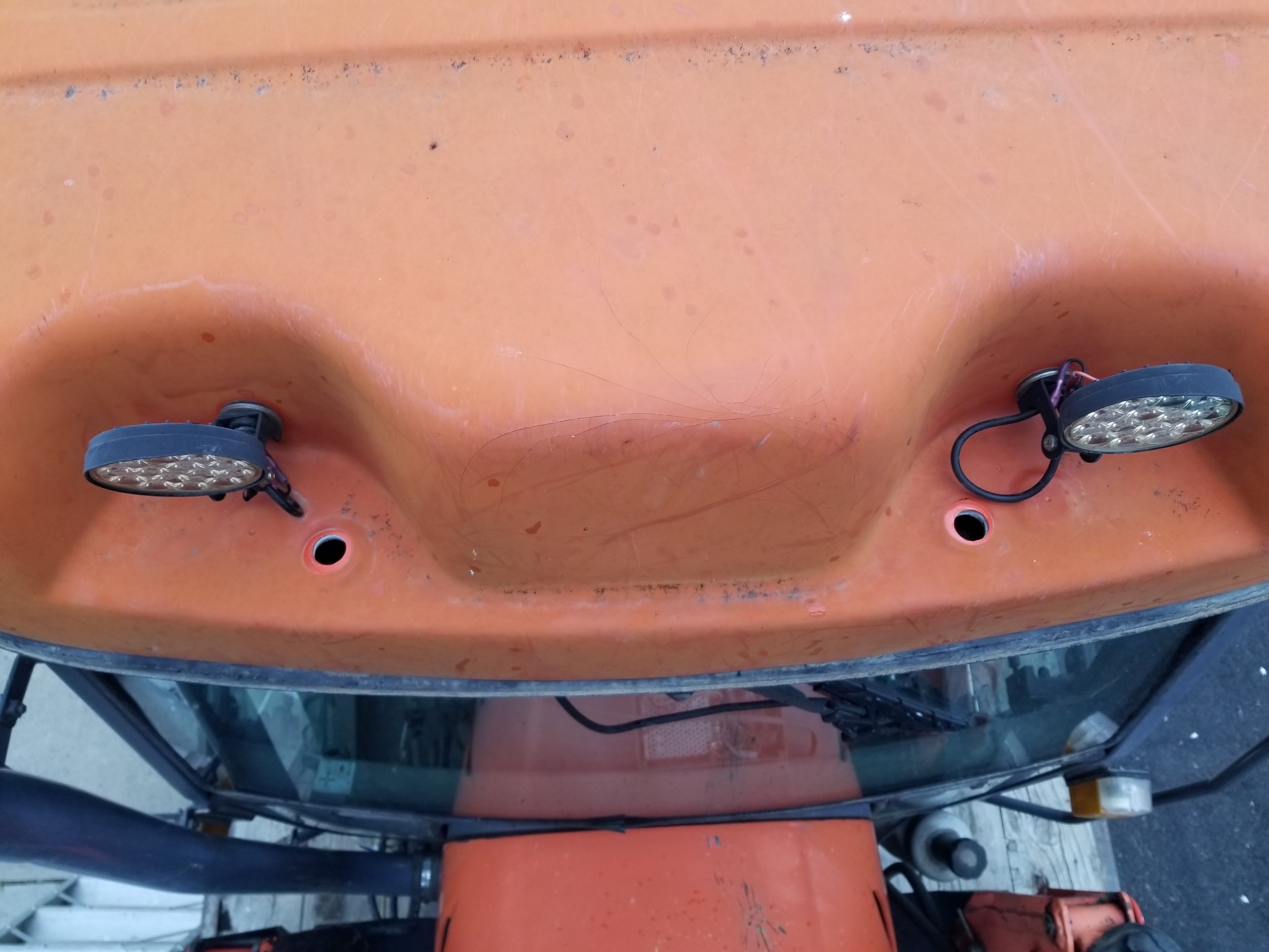

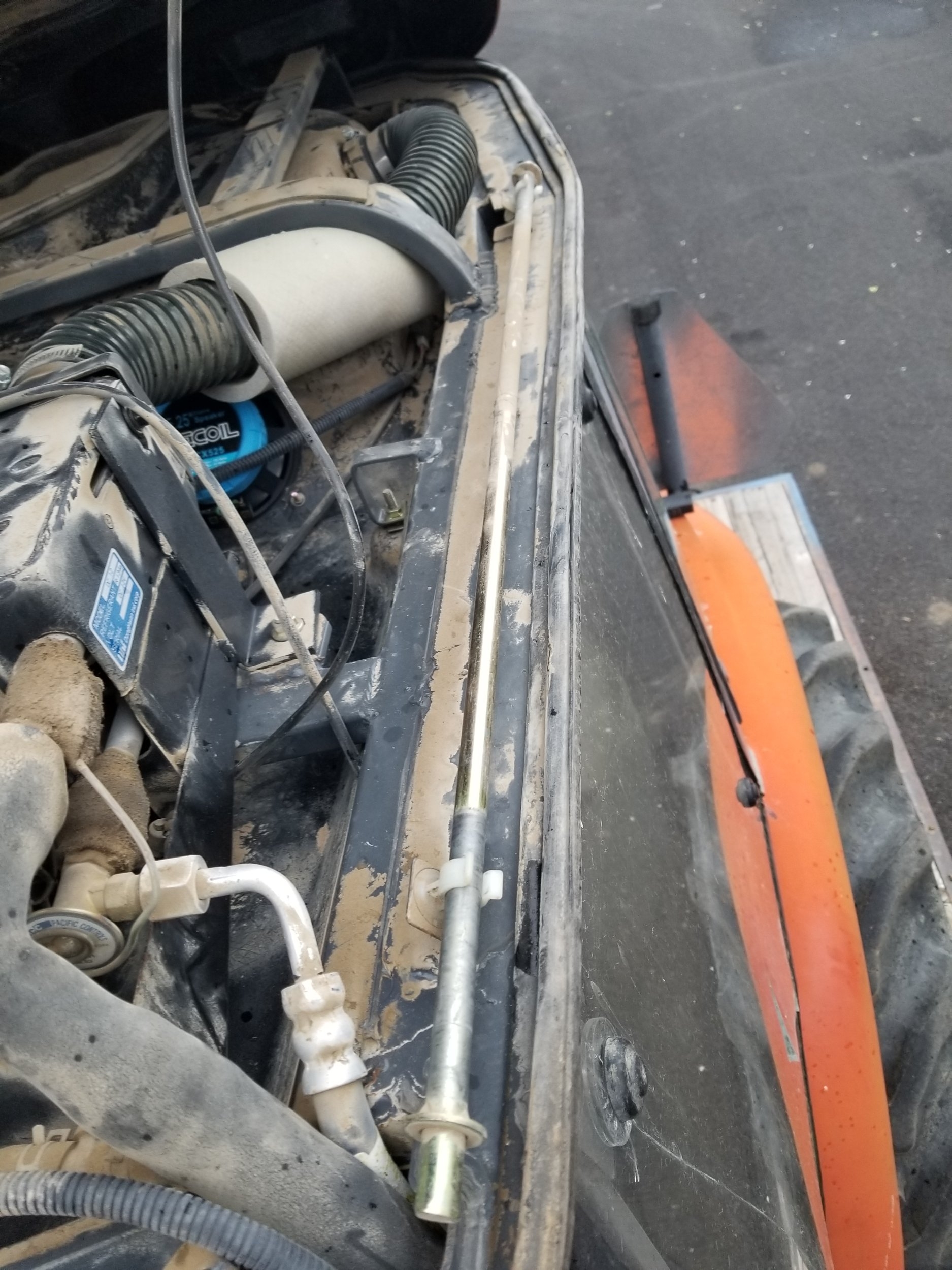

So I climbed up there and started pulling bolts. Irritated I didn't find this in the manual. Next to the front work lights is a bolt by each light. Pull those and the rear is on hinges. On the side is a prop bar in clips that fits between the bolt hole in the roof and a hole next to the nut. Nice and simple. I ended up standing on the loader arms and I could reach everything. Filter are held with a single clamp to the outside that needs unbolted.
