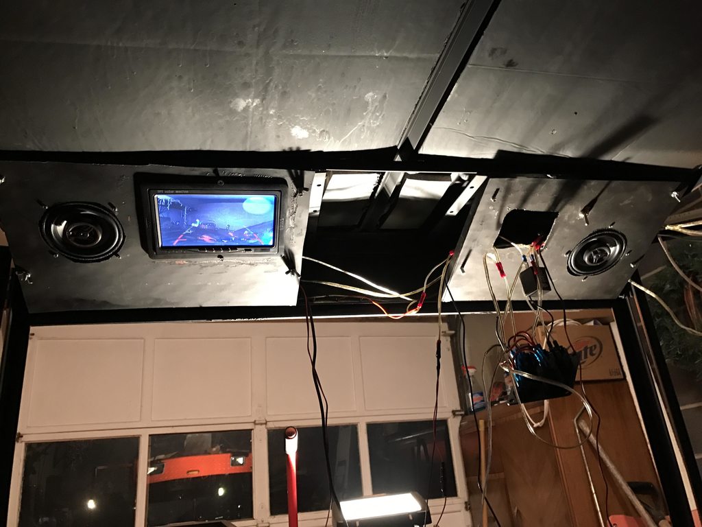

Got the flasher working! Turns out I had a bad ground on the chassis, so even when hooked up, it only partially worked. It does have an annoying click, hopefully I wont' hear it when the tractor is running, or I might just replace it with something else.
Got the speakers mounted to the top panels along with the rear camera, and working on wiring in that switch pod for all the lighting and heater. I ended up being short one switch, so I had to put the rear red running lights on with the yellow flashing lights. I don't hate the idea, but I would have liked them separate. I may add a switch for that later.

Busy day today. Wrapped up the electrical minus the head unit. Have 4 posts waiting for jb weld to dry so I can attach the head unit holder. Flood lights, flashers, backup camera heater fan, voltage meter, usb ports, phone mount are all in place. Wires are mostly cleaned up, still working on that.
