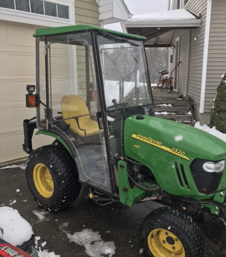

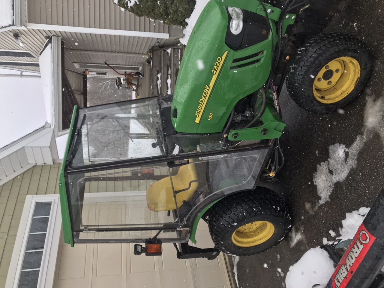

Finally got around to replacing the Original Tractor Cab soft cab that came with my 2320. Used 1-1/4 square tube for the frame, safety glass from and rear and lexan on the sides. Retained the top and wiper motor.

Very clean job on the cab. What did you do to curve the door metal for the fender?
Post more pics of the cab. We all love pics.
/ Cab build: Deere 2320
I found a Baleigh R-M10 roll bender for $300 on FB marketplace. It was about all it wanted on the 1-1/4” x 1/8 wall. I think the open/cantilever design gives up some capacity for the convenience.
/ Cab build: Deere 2320 #5
That's a lot of visibility.
/ Cab build: Deere 2320 #6
I'd like to build something like that for my BX2230.
Now you have me thinking......
