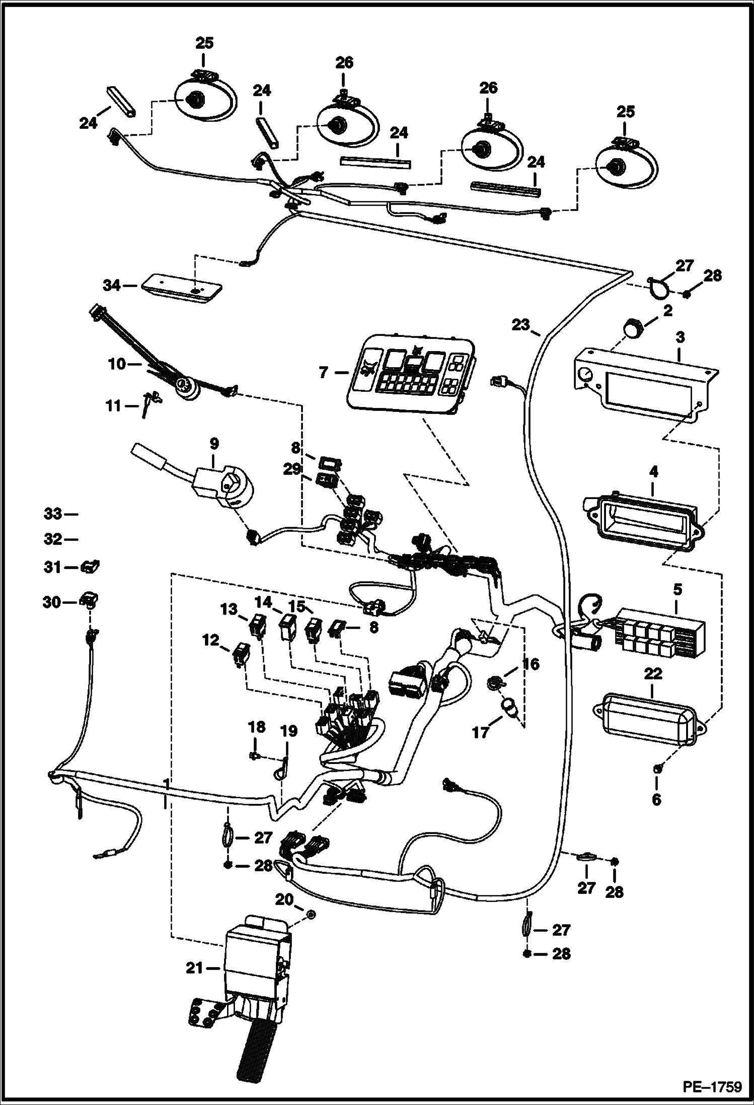

The alarm is located on fuse bracket near accelerator.I wrapped it in seat repair material and it is a 100% better. Alarm is number 2 on diagram below

Thanks, I will muffle ours a little. Still need to hear the low fuel alarm, it saved me from running out today while mowing. :thumbsup:
