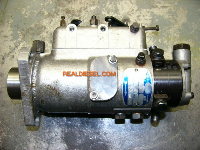

#15
Here's that pic of a Pump somiliar to mine. Banjodunn is correct about paying attention to where the gorvernor springs are. This pump is on multiple machines, from CAT to Allis and so on. The spring location changes a lot of the function. I hope nobody minds that I took this pic from the net. Found it with a google search.
   / C.A.V. Injector pump problems?
#16
BTW, the two odd nuts kinda centered are the only two that you need to take off. That whole cover comes off, look at the spring location, then you take off the nuts above the throttle linkage and the kill knob linkage, the linkage comes off, then all you do is punch the remaining parts from the top. Change your seals and gaskets and there you go! A dry injector pump. On the 165, its really easy to do.
