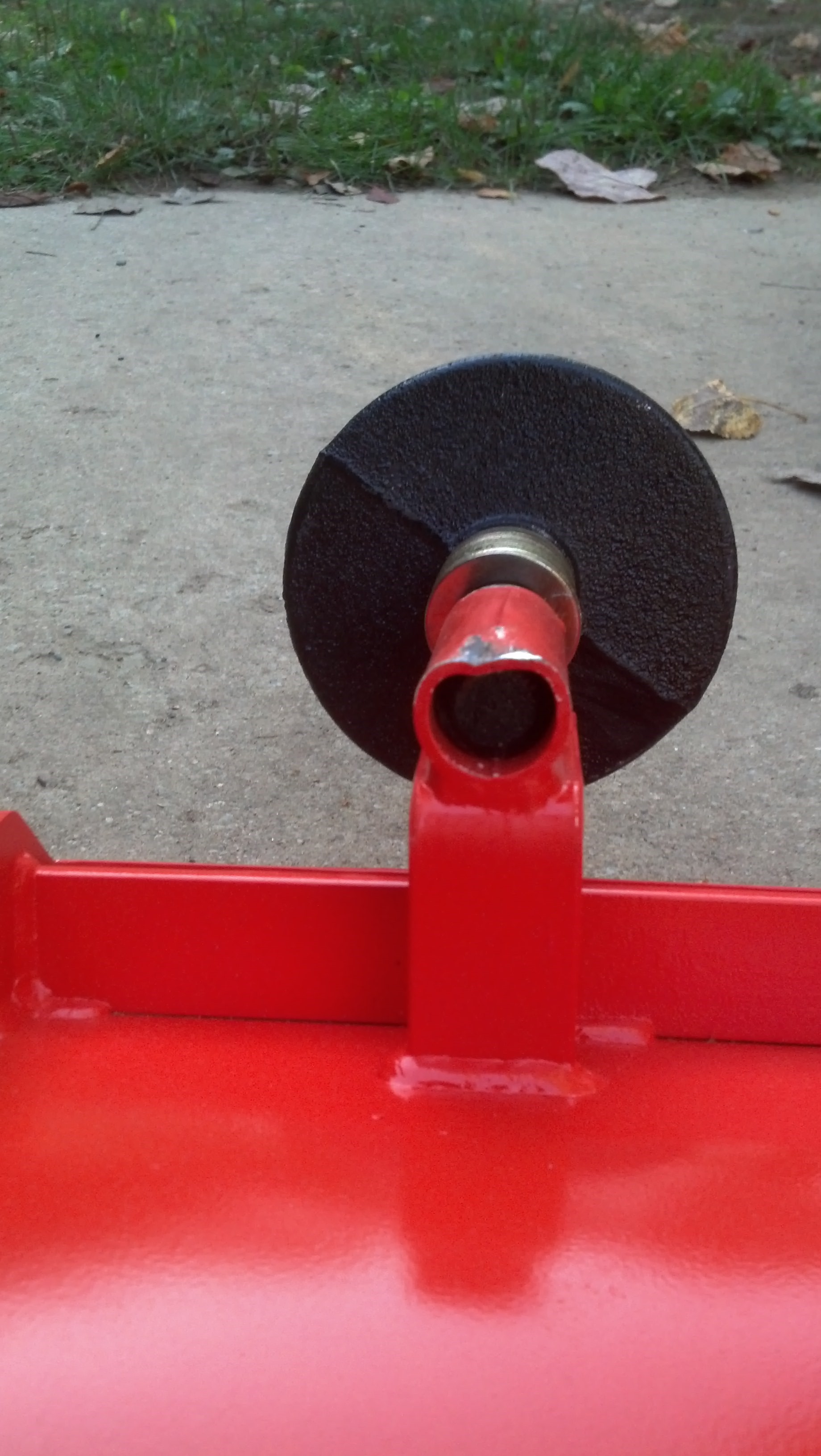

Don's snow plow was damaged slightly in shipping. The tube that a skid shoe shaft slides into, was flattened slightly at the end. I've attached the picture he sent to me. He emailed and asked for suggestions. I mistakenly thought he would prefer to avoid the hassle and delay of a UPS damage claim. In an honest effort to help, I suggested to Don, that we could send him a tapered tool that could allow him to straighten the bent end of the tube in about 5 minutes. Don didn't take me up on my offer, but he went ahead and made the repair with what tools he had on hand. The tube was repaired, but it left him with the feeling that I was taking advantage of him.
Shipping damage happens occasionally. If it didn't, carriers would not have the complex systems in place to deal with damage. UPS claims require that the customer be contacted for an inspection of the damage. That usually happens in 2-3 days. Next, a pick up is scheduled and the item is returned to the seller for repair. We would have repaired the item and shipped it back. Total time for the inspection and shipping back and forth would have been about 2 weeks. The repair would take minutes. BXpanded would have been reimbursed for expenses so there was certainly no reason for us to avoid filing a claim.
The shipping company had obviously dropped the blade from a considerable elevation onto a hard surface and had done the damage. Although BXpanded had done nothing wrong and I had done nothing but try to help, Don's frustrations were boiling over and his feelings were that the whole situation was our fault. I even offered to replace the blade or to accept a return.

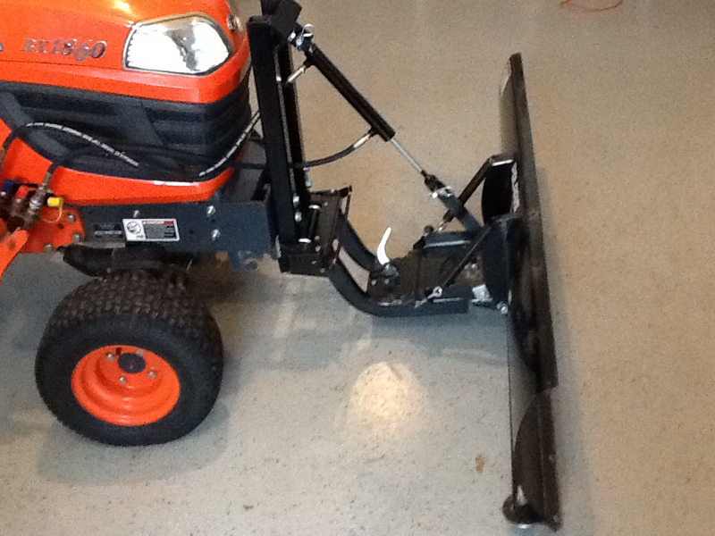

I made a Polaris Glacier II mount for my BX 1860. Had the plow left over from my ATV, made up a mount for the Kubota and added a hydraulic cylinder to raise and lower it. Actually works a lot better on the Kubota than it did on the ATV due to power steering and the hydraulic lift in lieu of a winch. Figure I have about $600 into it including the Glacier Plow. The hydraulic cylinder was the biggest additional cost at $80.

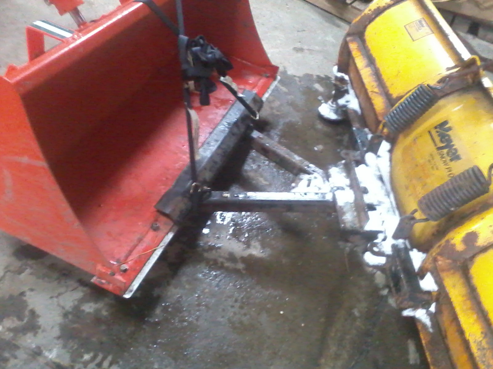

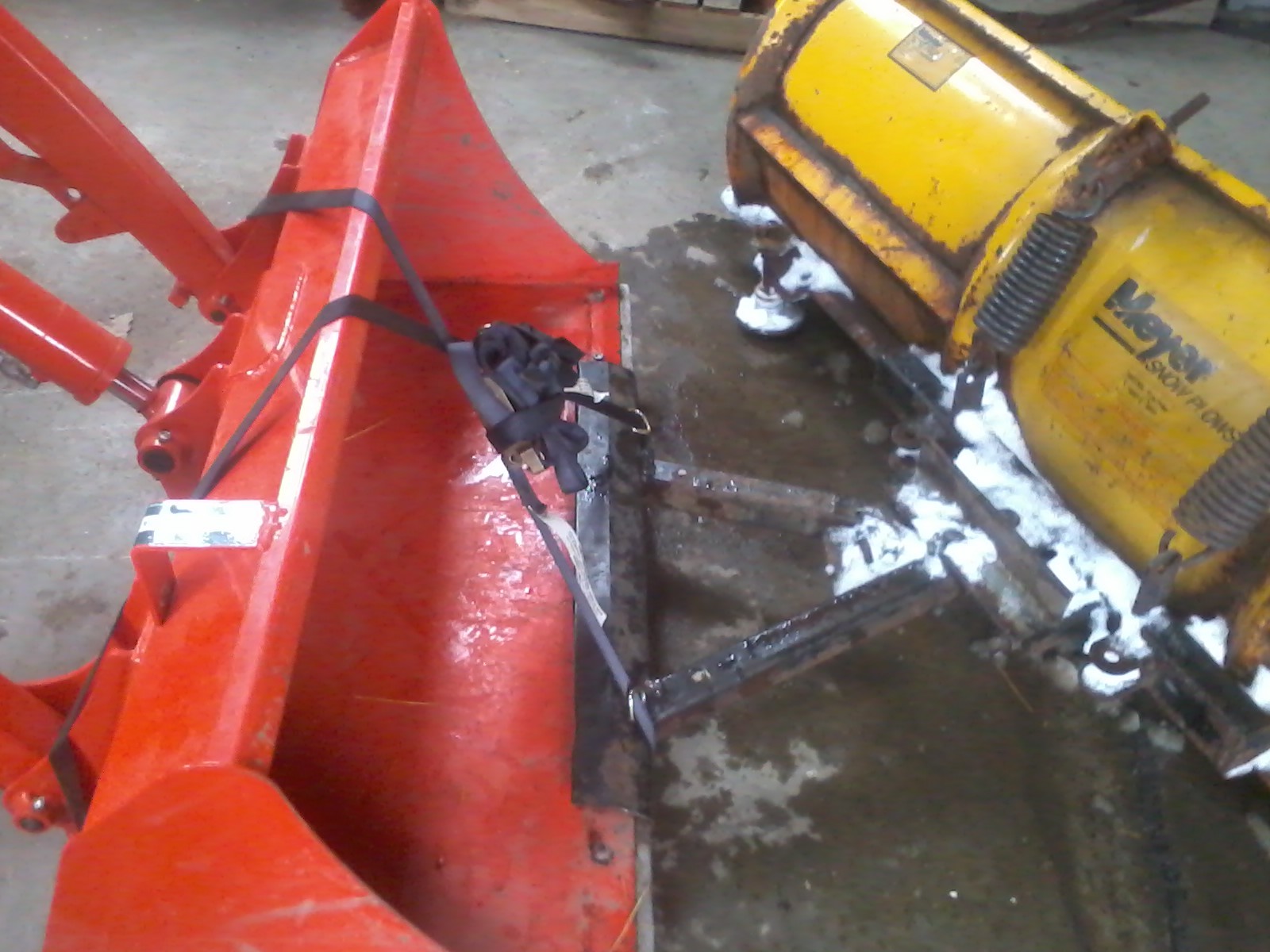

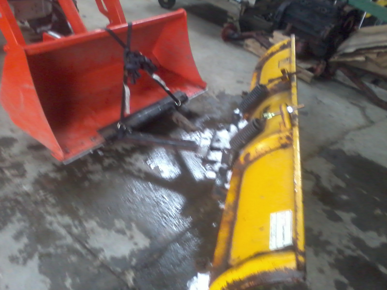

Would you show some close up pics of the base mount to the bucket lip? And I don't see any mechanism for lifting the plow when curling/lifting the bucket. Could you explain your design and how effective it is? TIA
/ BXpanded snow plow? #100
I will try n get pics for you later not home right now but I used a frame rail I had off my old 2002 ford truck that I had to take off to mount a plow just cut the side off to make a u channel welded it to the frame were the loops were for the cyl lines were the rachet straps on hooked on to the spot were the cyls used to be n I crossed them so it don't slide works great I have a 180 ft driveway with a 3 car turnaround the only thing is if we have more than 8 inchs I take my time I will get more pics thanks for looking
