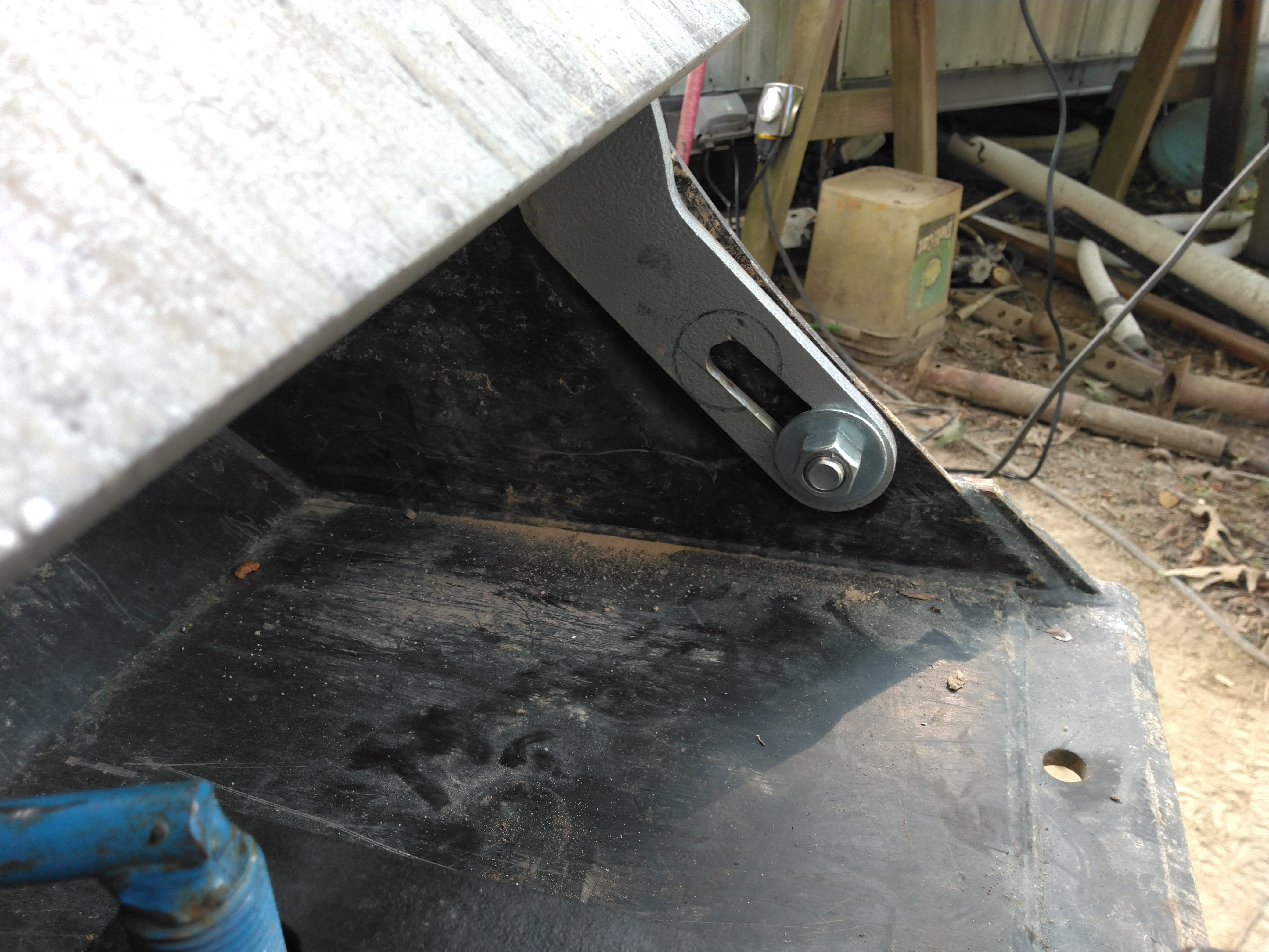

Ordered Piranha bar on 8/14, got it on 9/09.
Installed it, decided that I don't want to wrestle with
the weight of the bar every time I don't need it, so I
cut the slots longer, now I can loosen the bolts, slide
it forward and flip it up and out of the way.
View attachment 620924View attachment 620925
That is a very good idea! I haven't had a reason to take mine off since I had it but this adds the option without of the fuss of lifting it and cutting the **** out of myself trying to reposition it back in place.

Yeah, I dropped it during the initial install, luckily I was
able to get out of the way, or I could have lost some toes!
Was gonna post a quick video clip showing how easy it is to flip it up, but I couldn't attach it...
I'm sure you all get the idea.
Best part is that when it's up, you can use the original edge again if needed

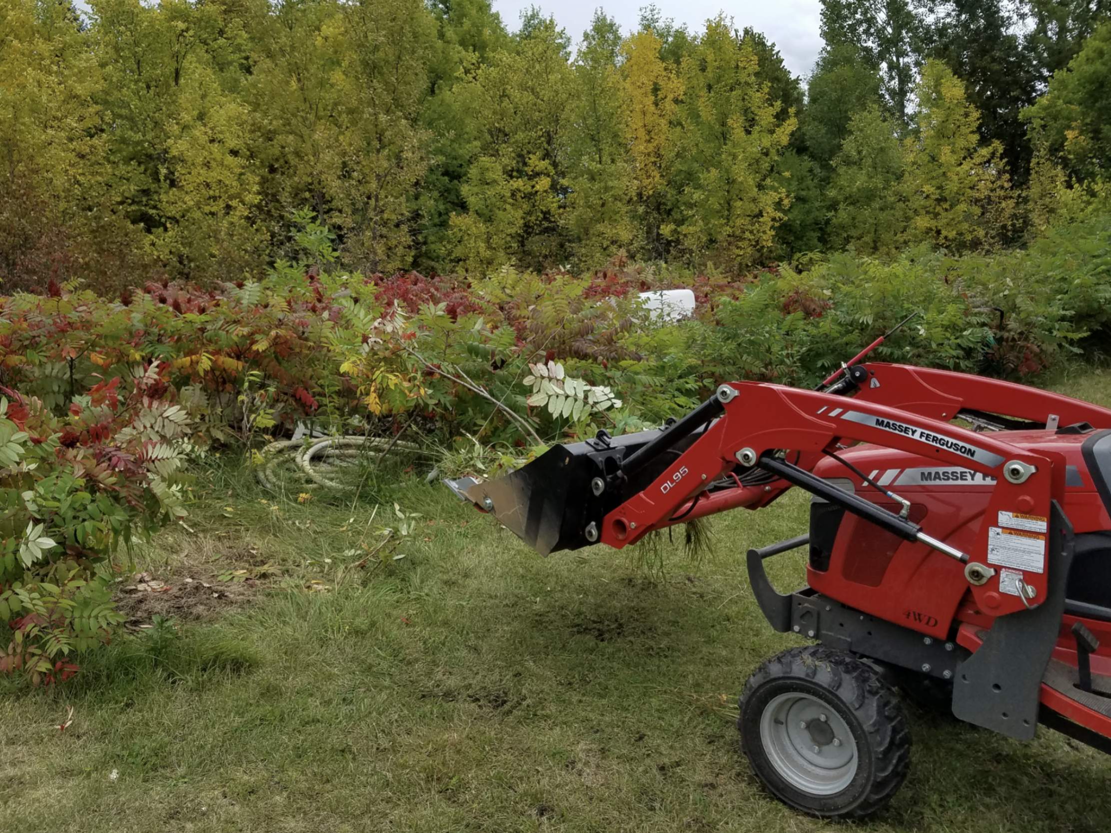

Guess I got lucky. I ordered my Piranha Bar on September 1st and received it on the 4th. Playing with the tractor, I was able to pull up a 4" tree from our yard, roots and all. This thing is great.
/ BXPanded contact? #139
Think I will make it out today now that it is not raining anymore and it is drying out, will give the PB a good first workout this afternoon on that area of briars/brush or as I call it thatch.
Jim.

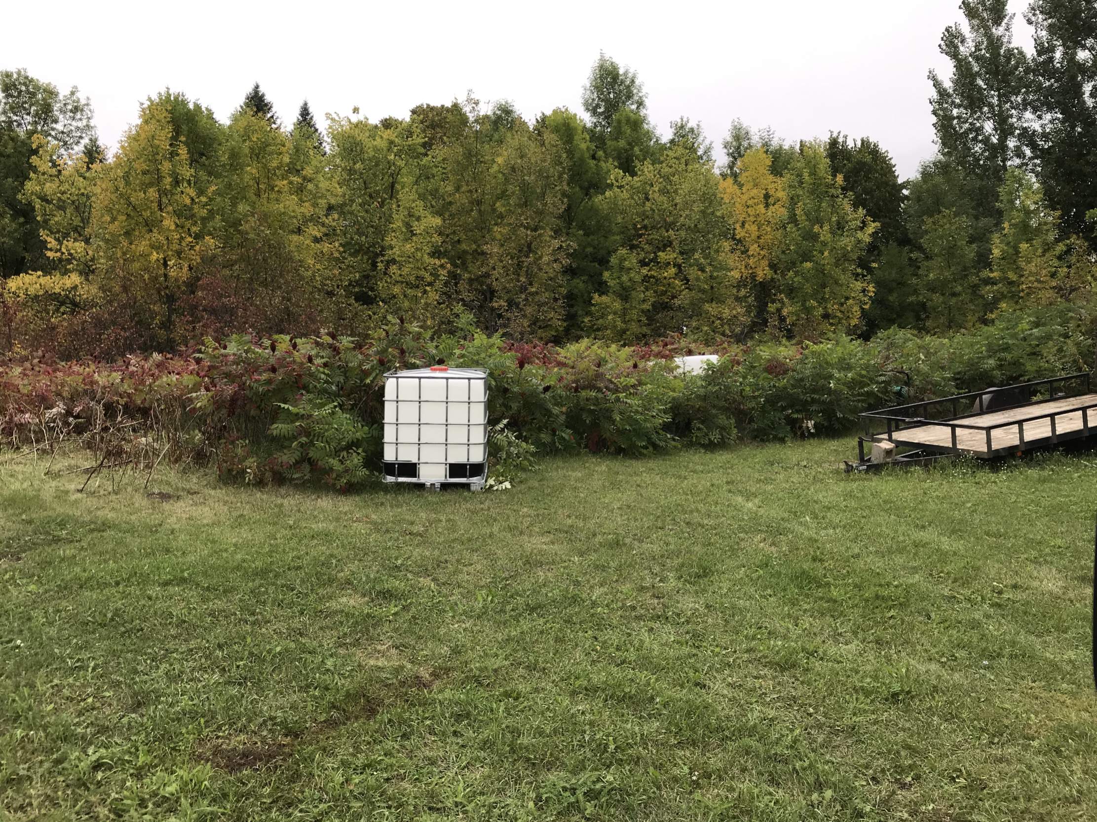

/ BXPanded contact? #140
Well I got out for a bit before it started to rain.
Just starting.
Jim.
Will not let me load two other pics at this time.
