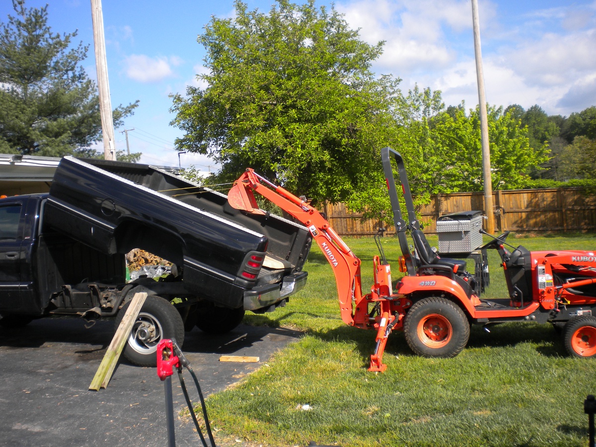

Yup, cult following, I'm a convert! That little thing is unholy powerful FOR IT'S SIZE. It is NOT a full size excavator, and yes, it may take you a few minutes, but if you're not putting in Septic systems commercially, it'll do anything you ask of it.
Of course, you don't have to use it just the way it would APPEAR you would use it:
Kind of useful around here anyways! :D
