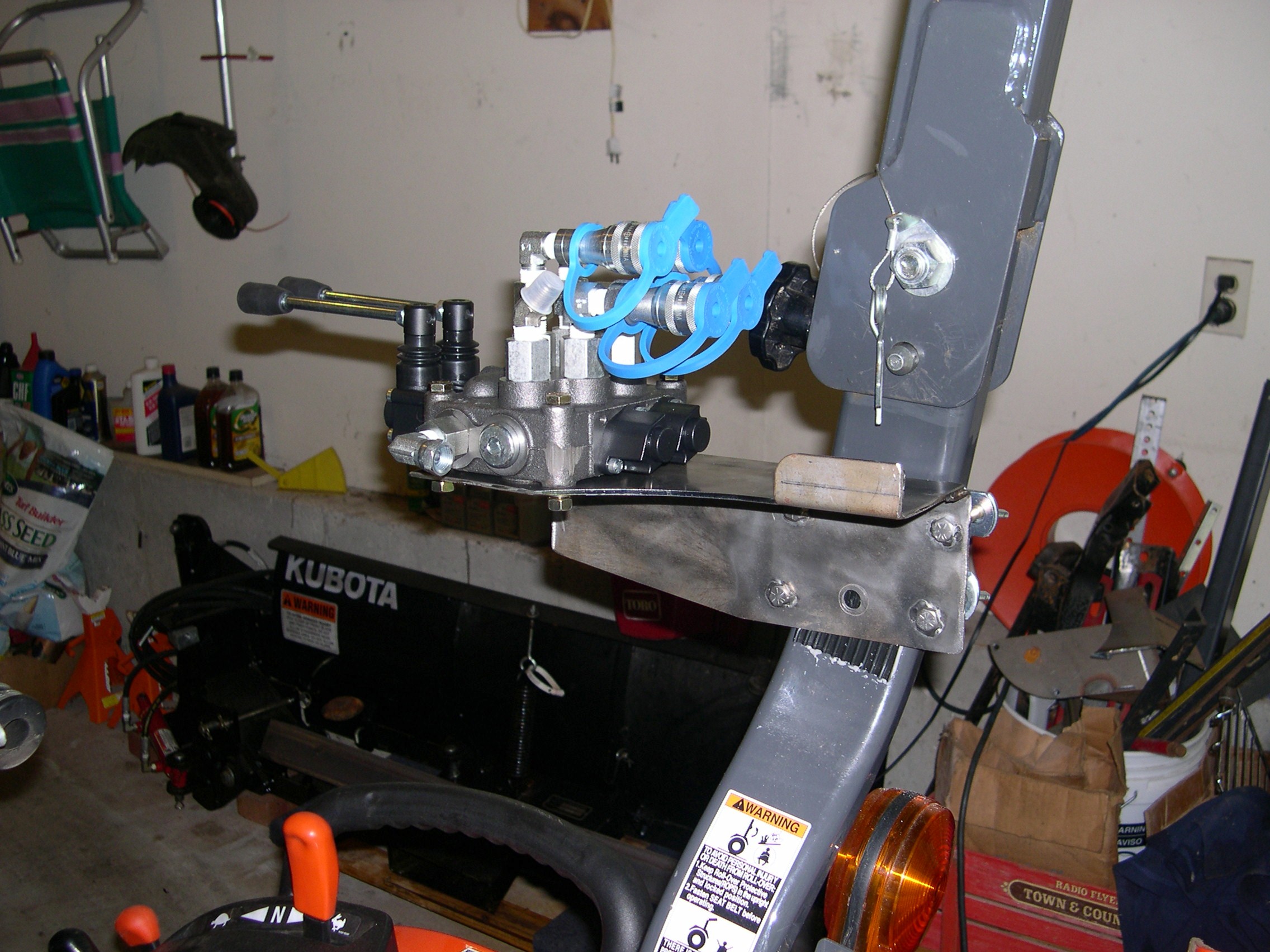

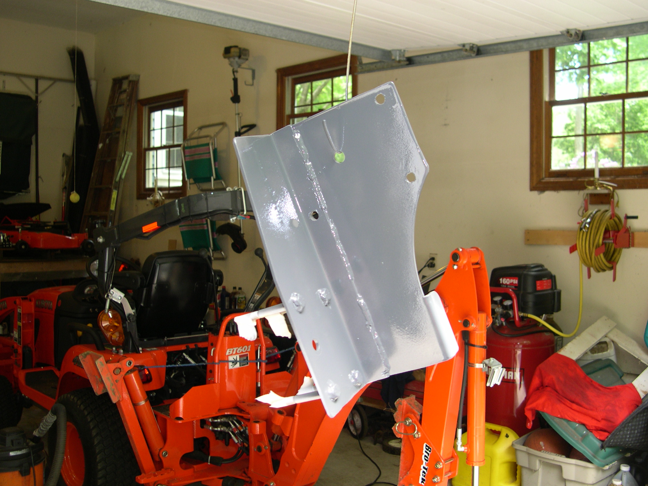

Been a while but I finally made some progress on my BX25 Valve Project. Ordered and received the detent kit, additional fittings and hoses to hook up my old hydraulic top link and to run the BH off of the new valve. The detent kit was not quite what I thought it would be but should work fine for running anything that needs continuous flow. I had thought it would just add a detent to the existing spring-to-neutral spool, but it ends up removing the spring so you can only lock the lever in either direction. So, it really can't be used for running a double acting cylinder as is. But I do have the old parts to convert it back if I need to. Should take about 5 minutes to change it out.
I did make one mental screw-up (so far :laughing:) and ordered one too many male QC's and one too few female QC's so I couldn't make the last connection to try running the BH off of the detent valve spool. I think you can see in one of the pic's the two unconnected lines (near each other). I will pick up the missing QC locally this weekend, hopefully.

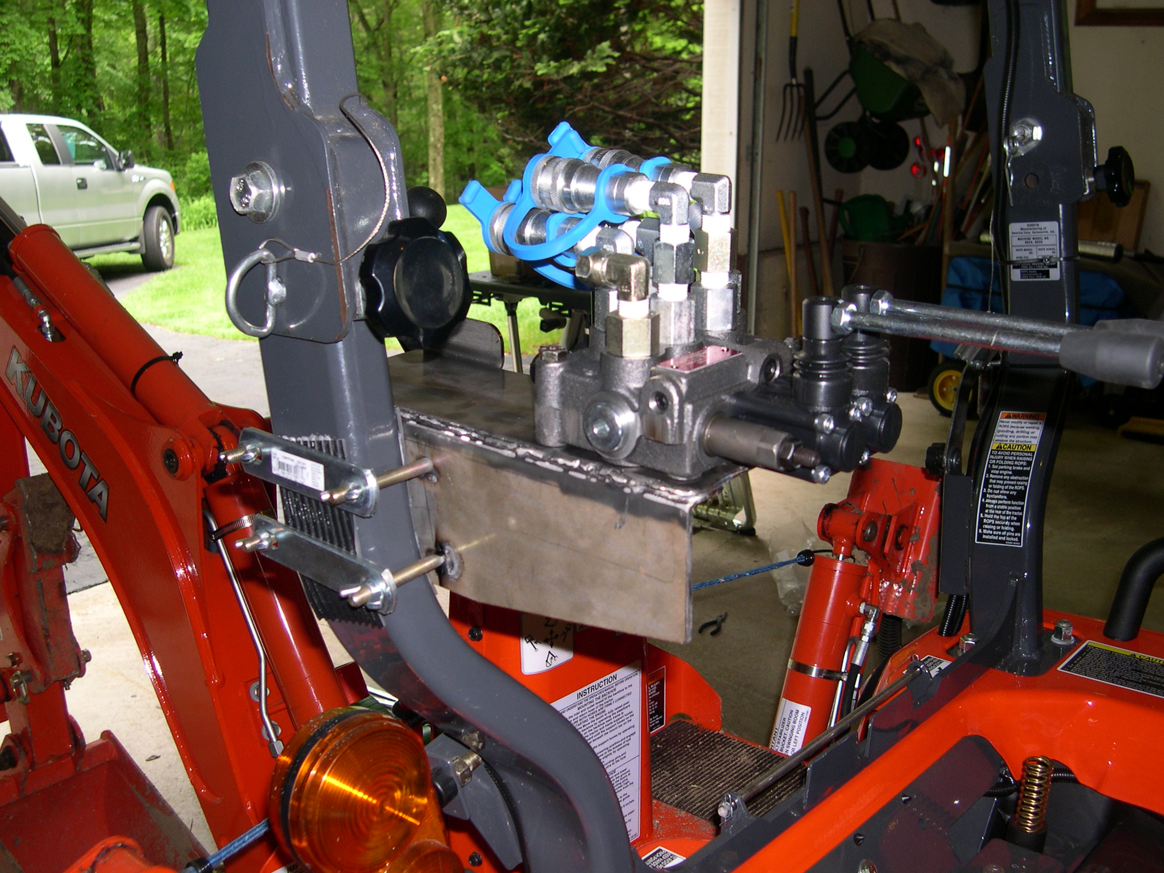

I did check out the valve as it is now (i.e., BH not hooked up) to check for leaks, etc. I started the tractor and first listened for any loading of the engine with the valve in neutral in case I somehow deadheaded the pressure, but it ran fine at idle. Added some RPM (about 1700-1800), and tried operating the FEL. After a short pause to purge the air I assume, the FEL seemed to work fine, though I didn't do anything to cause the pressure to max out. It did seem to run a little slower than before the valve was spliced in, which would not make much sense if the FEL valve is the first in series, so it could just be my imagination.
As you can see in the third photo, I hooked up my old hydraulic top link to trial it and it worked fine, though noticeably slower in the extend vs retract direction. The valve is rated for 8 GPM, which is about twice what the BX pump delivers to hydraulic attachments, but maybe all the QC's have some impact on the speed?? At some point I will time the FEL up and down with the valve in and out of the system to see if speed is impacted. If it is, that won't be ideal for running the BH off the valve.
For anyone interested, I have about $400 invested in this set up so far with the valve (+ detent kit) not quite half of the cost. The steel for the mount was scrap I had, and I was able to reuse the old top link hoses and male QC's. The grapple thumb should be about another $400 when I add that next year (assuming prices don't jump much). Everything is hooked up with QC's and the valve is mounted with wing nuts on the bracket, so I can put everything back to OEM whenever I need to.
Once I finalize all the hook ups and test out the BH operation via the valve, I will organize the hoses a little better and get some hose protection fabric. So, more to come in a few days, hopefully. Looking forward to adding the grapple thumb by this time next year. :thumbsup:

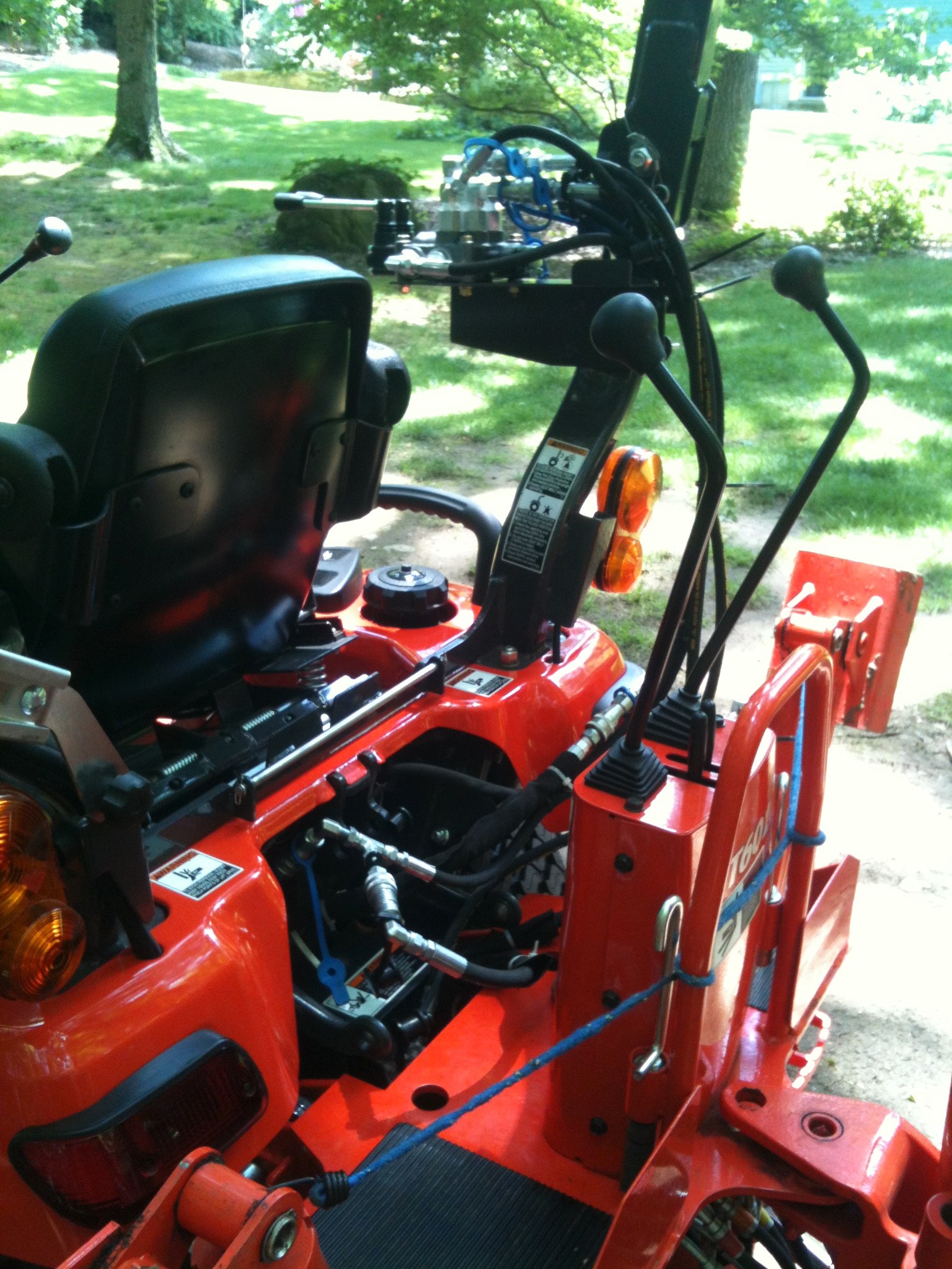

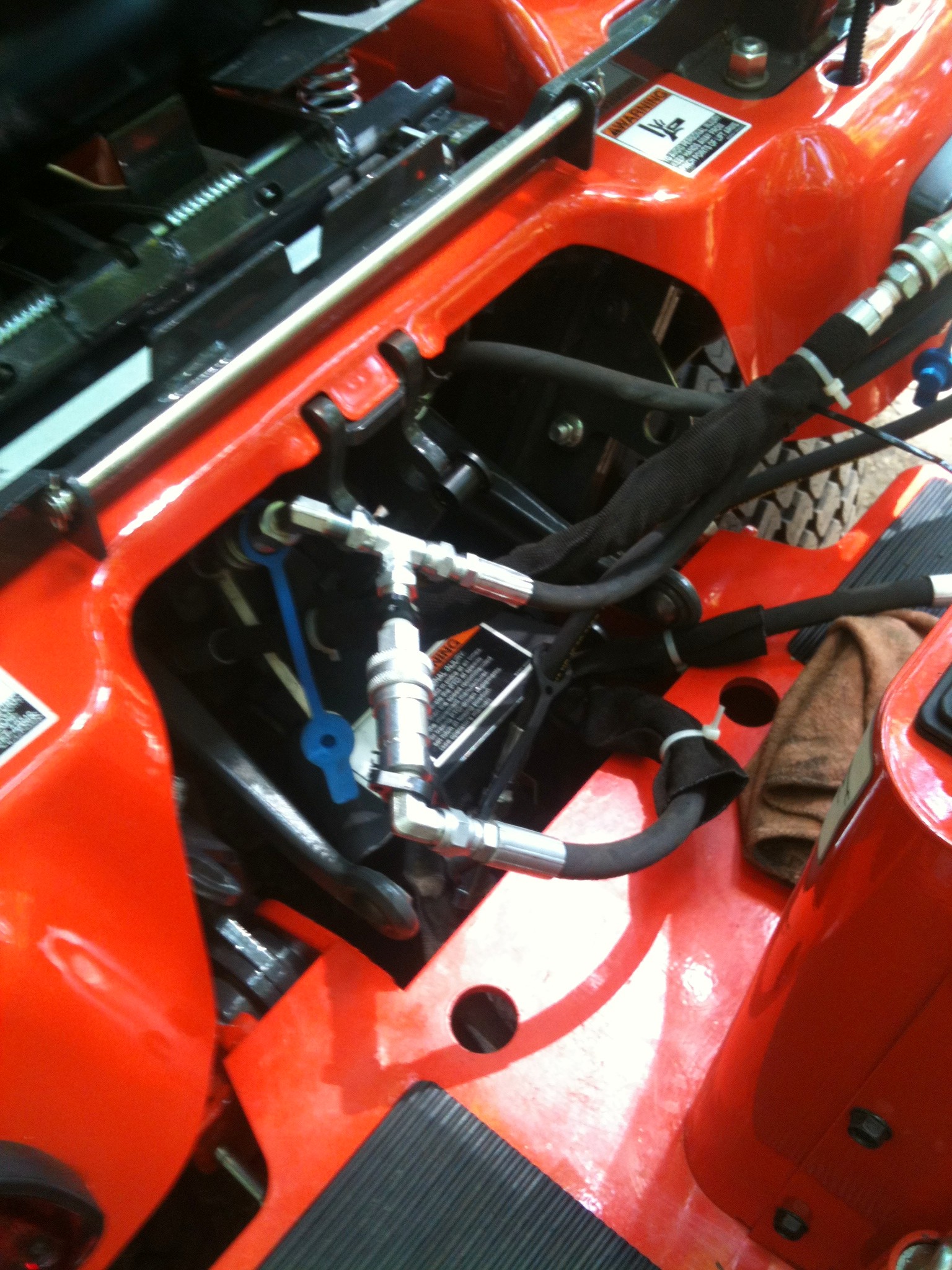

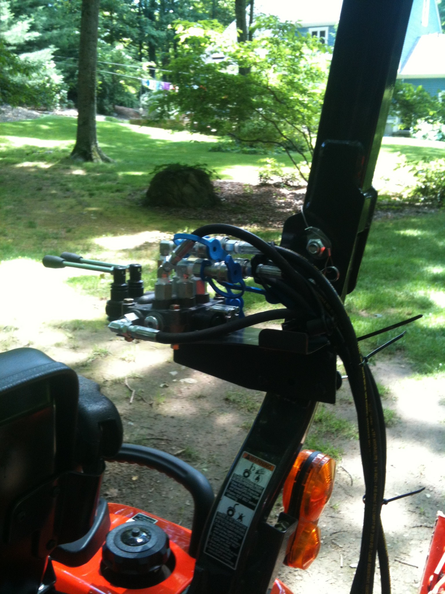

A couple more pic's. I have since added nylon hose protection. Ordered 20' of 1.75" ID nylon hose protection from McMaster Carr. Plenty left over for my eventual grapple lines.
Copy of BX25 Valve Addition 010.JPG BX25 Valve Addition 008.JPG BX25 Valve Addition 007.JPG
/ BX25 Remote Valve Project #29
Hmm, not a bad idea. Not sure why I didn't think about running it in series, but I'll give that some thought. That set up would leave both circuits open with the backhoe hooked up, though I can't see when I'd need both. How do you hook yours up when the BH is off - did you leave enough hose length to plug in to the tractor side BH connections?
View attachment 273549 View attachment 273550 View attachment 273551
When the back hoe is off, the power beyond return hose is plugged into the power beyond port on the joystick.When the back hoe is on this hose plugs into the power beyond of the backhoe, the pressure in hose from the back hoe is plugged into the power beyond port on the joystick and the tank return line from the back hoe goes into a quick disconnect T'ed into the Joystick tank line. When I use the back hoe my 3PH arms and hydraulic top link are removed so there is no real need for the joy stick but the option remains if needed. I did have to make sure all the hoses were long enough to facilitate taking off and putting on the back hoe. I'll post some pics later if you like.

"T's work well in the "return tank line"...
Before I read that I had already noted to ask perhaps J_J about this. My
question is; "If you put a Tee into a return line you will pressureize the
other return line sending fluid backwards at the tee yes? Is, or could this, be bad?"
Wouldn't it be wiser to add 2- check valves?

Artisan, I'm only planning on rolling if I do, to the left :laughing: But seriously, if I'm belted in, it shouldn't be a problem, I think. The valve is actually a little behind me though I suppose it's possible I could hit it with something in a roll. Any roll should be slow, unlike a, say, a car at 50 mph, so bodily damage should be minimal if at all.
As far as the hoses getting in the way, it really isn't a problem. I will take some pic's when I can from the backhoe seat so folks can see what it looks like from the operator's perspective. Again, I did add hose protection and used velcro straps to cinch the lines up to the ROPS, etc.

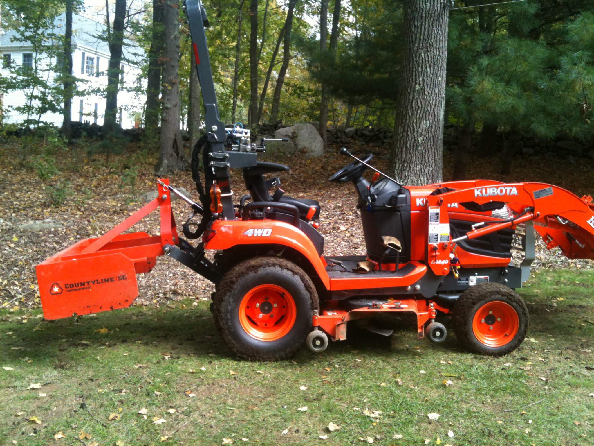

I don't think I ever circled back on this to show the finished hydraulic top link installation. Got that all set up now and really enjoying the ability to tilt my rear implements at will. Just had to extend and re-rout the tank return line a little to avoid interference with the top link.
Used my box blade and rake a few weeks ago and it made things much easier. Also came in handy when I hooked up my carry all to move some firewood (hat tip to Wrooster and CTF for the carryall idea). Anyway, here's a few pic's of the top link fully extended and retracted. Plans are still to add the grapple thumb to the FEL next Spring.

/ BX25 Remote Valve Project #40
CHDinCT you are to be complimented for starting this excellent thread. My compliments also extend to other members for their valuable inputs.
I would like to install a remote valve on my BX25; however, I am having difficulty figuring out how those hydraulic lines attached to the backhoe actually work. Might some members be able to shed a bit of light on a few questions please? For example:
1) Is there a diagram available that illustrates how the oil flows through the three hydraulic lines between the BX25 and the BT601?
2) Might there be a diagram that shows to which ports on the remote valve the above hydraulic lines should be connected to?
3) Finally, is there a diagram showing which ports on the remote valve would be connected to two hydraulic cylinders on a new attachment (other than the BT601)?
