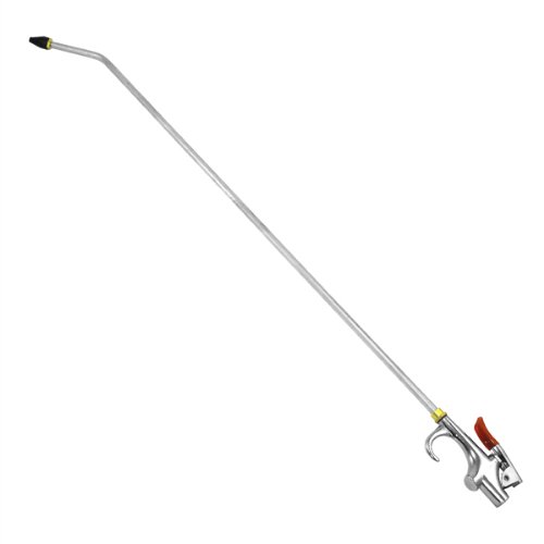

My '24 started really pushing the red while hogging this season. Main problem was a slipping fan belt. Worn too far to adjust. Fan was spinning, but not pulling enough air. Replacement made a big difference.
As to cleaning the radiator, this helps.
