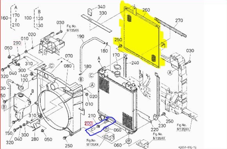

I'm quite sure you will find that the screen that slides up and out just in front of the radiator will have a bunch of larger stuff collected, and the radiator itself will have a bunch of small stuff collected.
I agree about using air compressor for cleaning out the radiator fins - that works the best for me too.

So I went out today and checked all the items suggested here; screen, radiator, HST fan etc. The fan was fine. The screen and radiator were a little dirty, but just barely so I cleaned them both. Last night I dug through the manual and realized I was wrong about the rated RPM. I thought it was 2500 but the manual indicated 3200. I took the tractor out and ran the bush hog at 3200 rpm. When cutting the rpm dropped to around 3000 under load. I only used about 1/2 to 2/3 throttle so as not to be so fast. It ran pretty good. I noticed that when I got a little too fast it did hit the red line but dropped back down when I slowed down the driving speed while cutting.
Also, I noticed that at about 1/2 throttle the temp would get high but not really hitting the red. When I would hit thick stuff it would almost redline but just barely and I mean barely stay out of the red. When I would get past the thick stuff and into the thinner stuff the temp would drop back down. It was cycle as I made passes around the field. I will also say that yesterday when I kept over heating it was near 90F with high humidity. This morning it was around 75F with lower humidity and a breeze. Could be a factor, maybe not, worth mentioning though.
All in all, everything seems to be running pretty good now. Lesson learned - ensure screen/panel/radiator are clean, run engine at 3200 rpm, drive about 1/2 throttle.

Z. I got him in the right vicinity. If he kept cleaning the battery cover screen, that wouldn't help much.

I hear ya slim ;) Must have got up on the picky side of the bed this morning...
It always seemed odd that these tractors blew cooling air from back to front until it occurred to me that the other way around would cook the driver.

My BX only overheated once, and that was due to a dirty rad. I pulled the battery out and cleaned out the rad fins and now its so much better, the prescreen metal filter was a little dirty , but not enough to make it hot, but cleaned it anyways. Due to the nature of the fan direction - it pulls the heat from the rad and pushes the hot air OVER the engine. I can understand why it can get hot fast due to direction of fan blowing.
