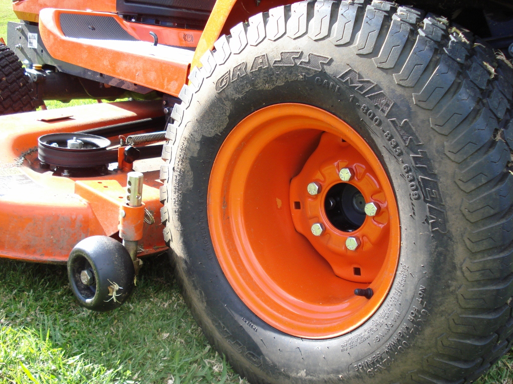

I got the spacers after a recommendation from a fellow TBN member "OrangeRidge" .. thanks mate!
got 2" rears as my mower deck gauge wheels prevent going any wider .. I don't mow very steep, but its good to know they are there .. spacers01.jpgspacers02.jpg

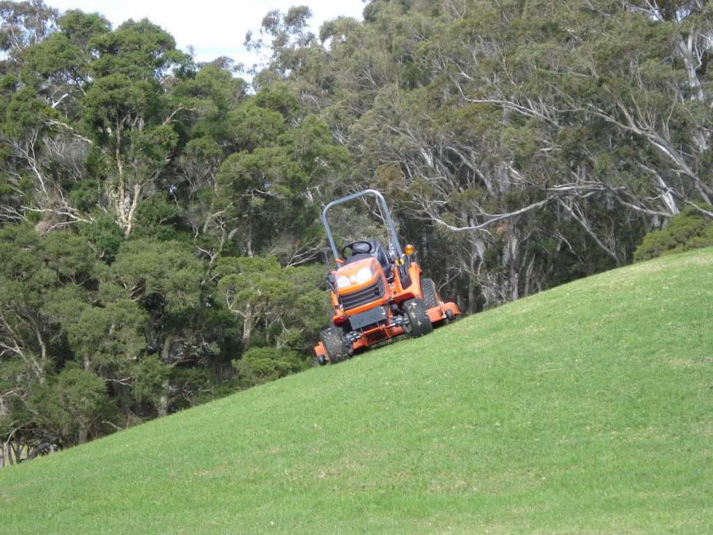

I bought the Bro-Tek rear wheel 2" spacers a couple months back and it's made all the difference in the world to me. My property is pretty much on a 15 to 20 degree slope for the full 5 acres I have. I do have some areas with more slope, however I'm still uncomfortable sideways in those areas.
