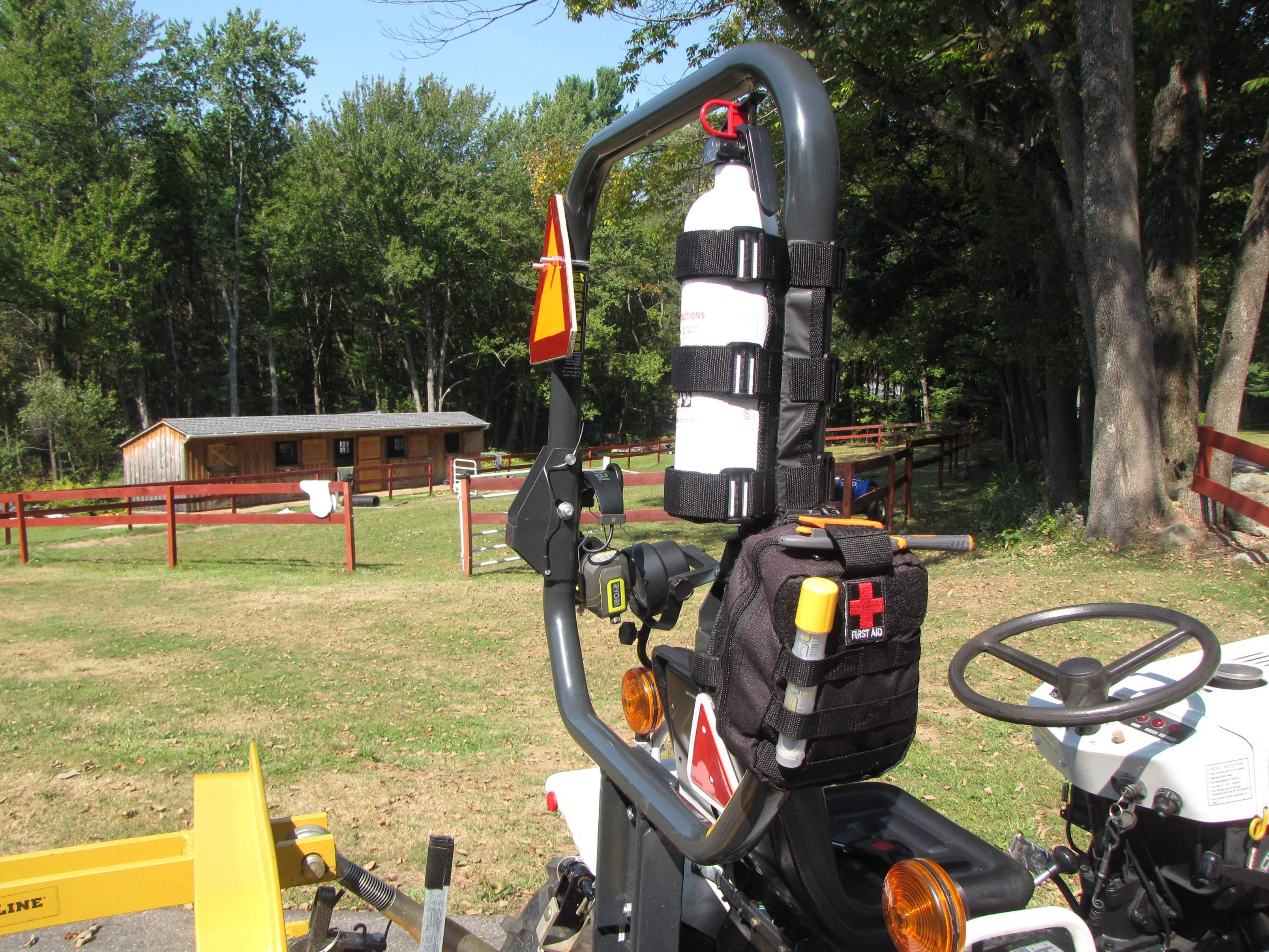

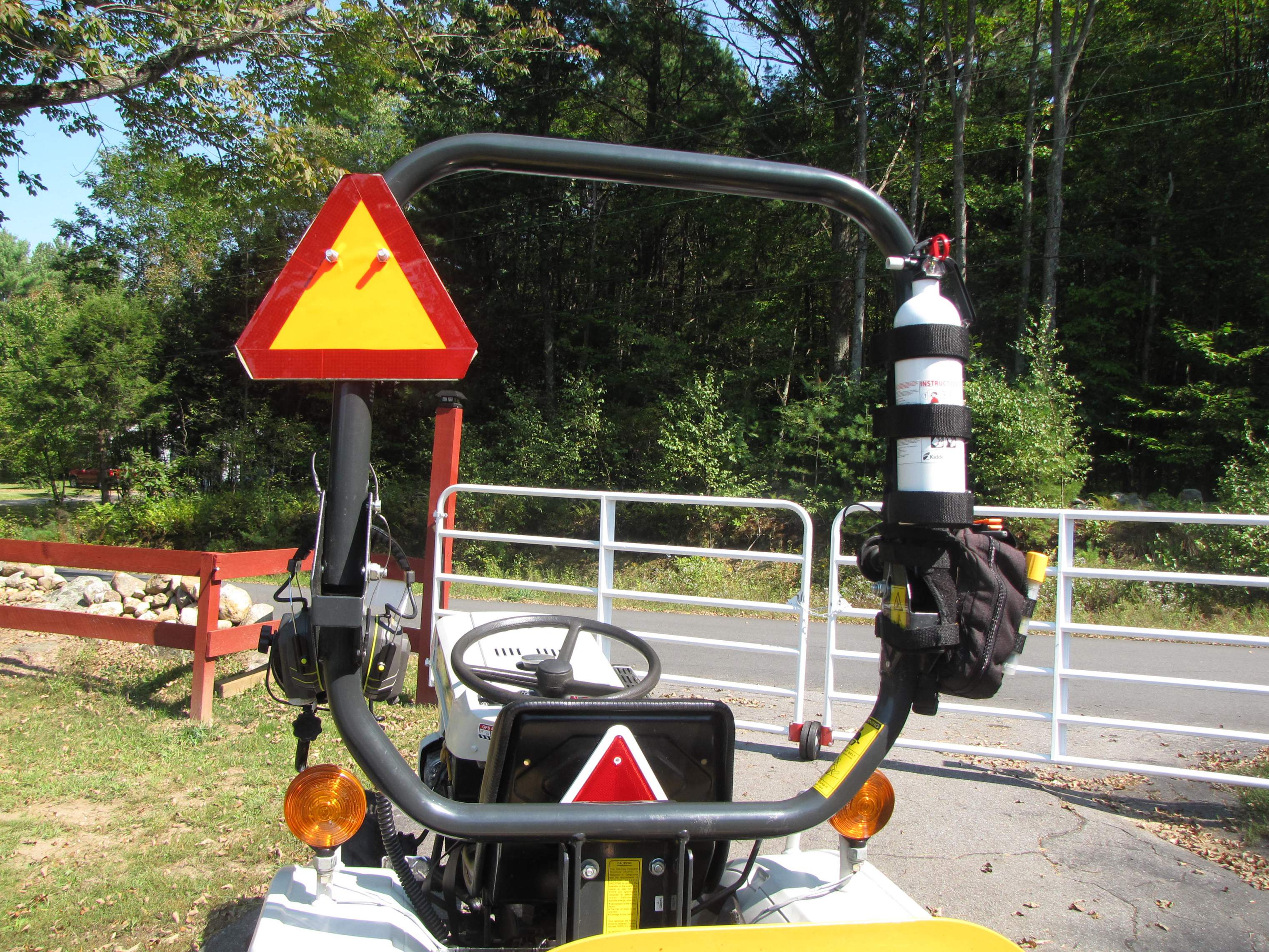

VIOLA! Ask and ye shall receive! Great minds think alike ehh? Very nice LeeJohn,
good job! So am I right here, you can unlock the front pins and then
Lower the MMM mount w/ controls? You gotta do a YouTube!
Do you have an IPHONE? Easy to do w/ an IPHONE. Very cool!
Thanx for posting the pics. I didn't see this till this morning.
I have another thread going, on second thought I probably should have
keep it here regarding my Enclosure / Cage? that I am building.
Seems a couple children wish me to fail, HERE.
I will move it back into this thread.
No I can't do a youtube. I downloaded a 4min clip and it took 4 1/2 hours so can see why no youtube for me. I can't even get that thing they call high speed. You have it right how it comes off and on. I do put a 4x4 block wood about 6" long under it at the back so it's easer to pull the last pin.
When going on I also set it on the block to make the rear pins ease to hookup. After it is up I move the MMM knob to top and let the 3pt down just a hair then it does not hit the frame. I have made 4 of them for people and the later one have sides on back part and also on the front it turns up. The front has to be a little long and back sides have be shaped right. You well hear that it isn't get enough air for the trans, but that hasn't been the case on the ones with the sides. The gaps is big enough the fan gets enough air.
