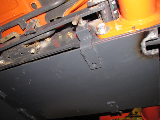

Agent Blue, indeed ballasting down low would be smart and I
think I eluded to it in prior posts. I have a few thoughts, a good
heavy skid pan, maybe attached to the MMM lowering arms,
so maybe I can hinge it and lower it to replace my trans filter
would be good. Or some bars. I have another thread where I am
looking at receivers front and rear, great spots to hang weights.
That rear cross bar is heavy, maybe 22lbs, I "may" lighten it w/ a whole bunch
of .625 holes...I dunno...we shall see.
Here is the skid plate you need.
/ BX25 Full Cage Rollbar #94
Thats a great idea, and should help lower your center of gravity a bit as well. I am going to have to look at having one made for my tractor, thanks!

VIOLA! Ask and ye shall receive! Great minds think alike ehh? Very nice LeeJohn,
good job! So am I right here, you can unlock the front pins and then
Lower the MMM mount w/ controls? You gotta do a YouTube!
Do you have an IPHONE? Easy to do w/ an IPHONE. Very cool!
Thanx for posting the pics. I didn't see this till this morning.
