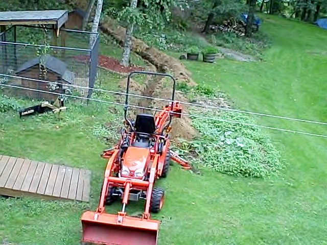

Unless you are in ledge or trying to move boulders, you'll have no problems. You have to use your head and maybe a good chain to haul any stone out of the hole you can't get the bucket around. I'm in an area called Rockville, and the BX-25 had no trouble digging this 180ft trench for me.

Hmm
I don't see a single stone in that picture,
Maybe some gravel, but no real stone ;-)
