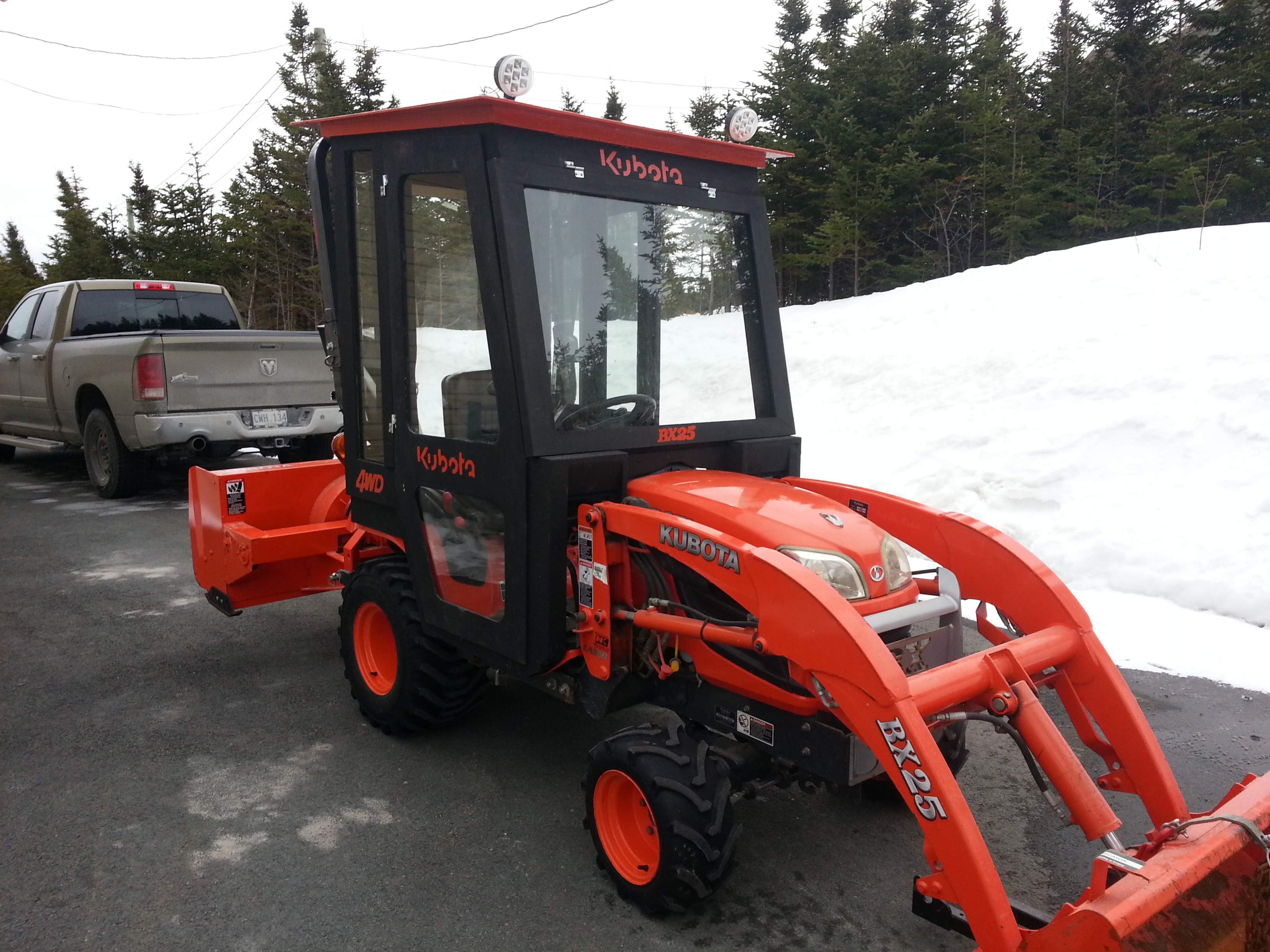

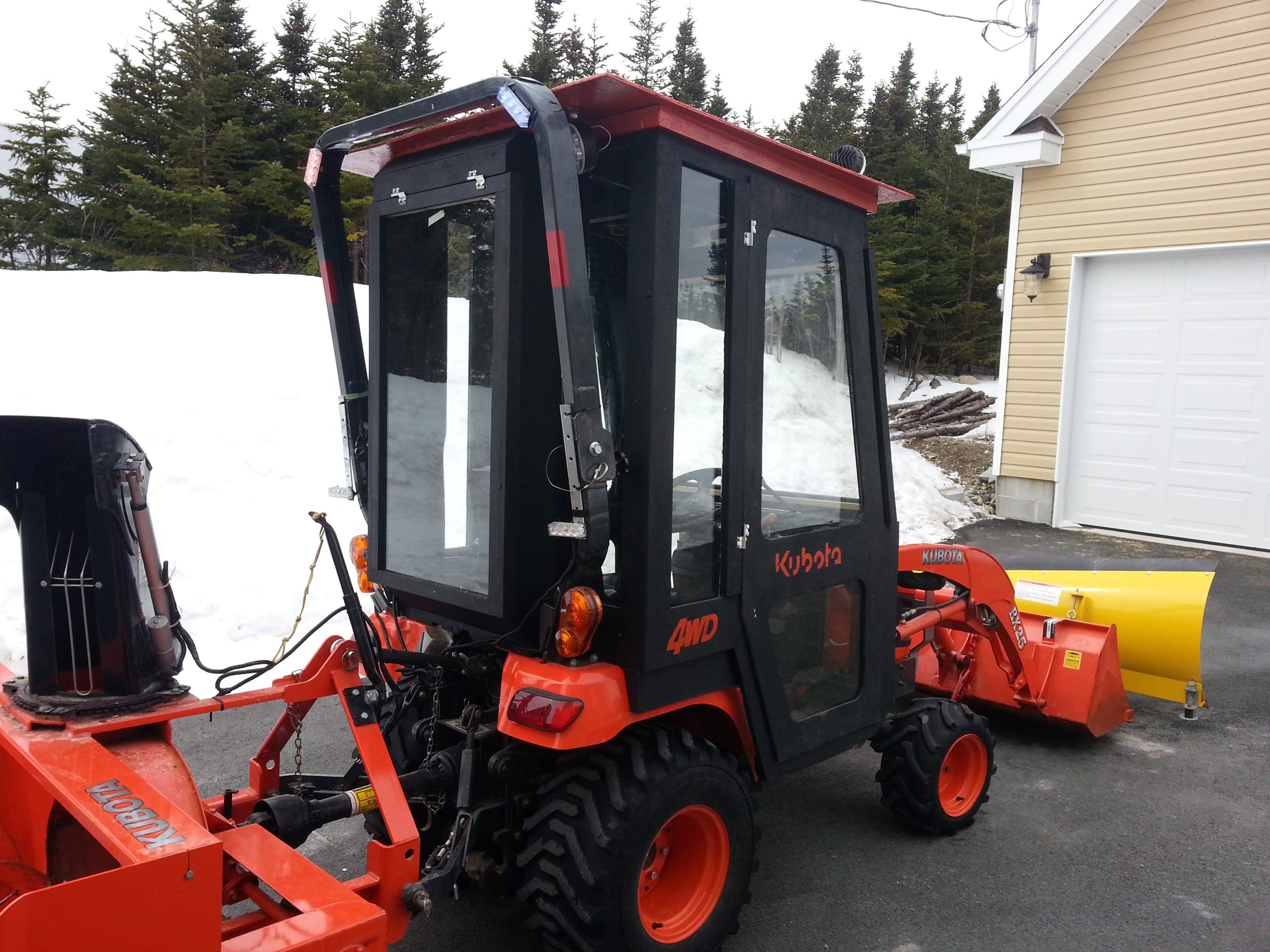

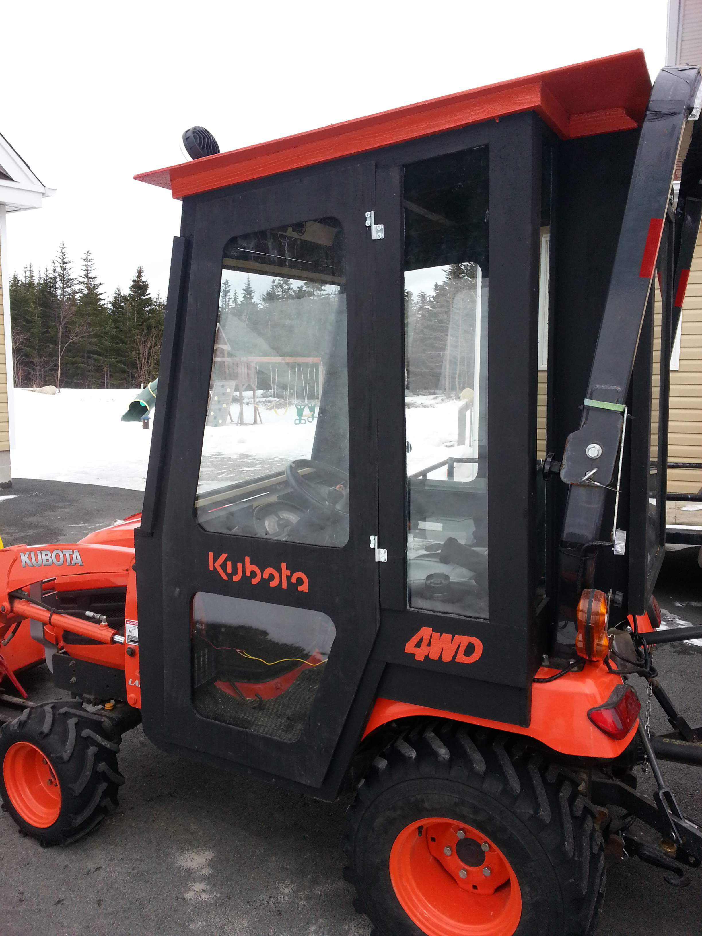

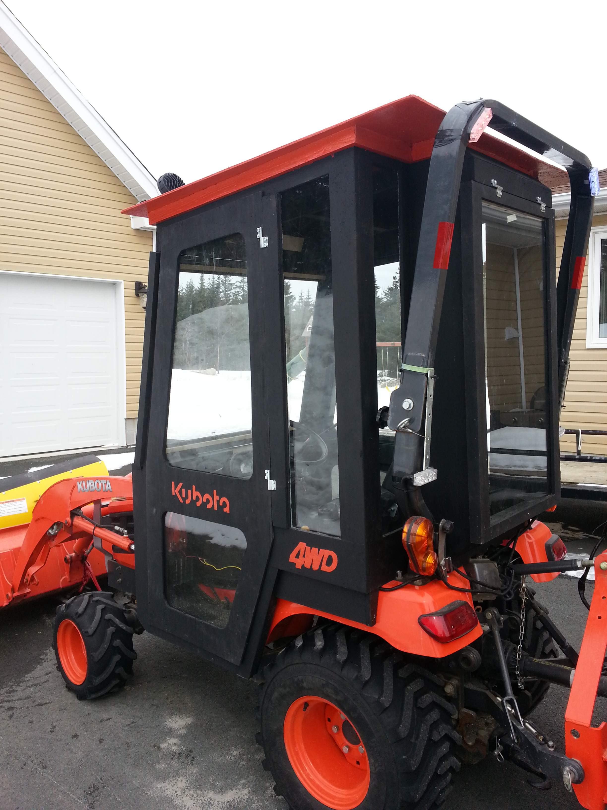

Thanks for the notes folks. I did take the cab out to do some snow clearing a few times before these pictures and while there was some creaking from the wood I think that's normal until I get it mounted really well with the weight of the glass. I'll be looking to get glass installed this week and maybe even a heater before the snow is all gone, ;o). I did two coats of Dupli-Color Bed Armor Truck Bed Liner from Crappy Tire ($40/qrt), that took 3 quarts. It seemed to cover well so I don't think I'll need to do a third coat, I'm still considering some kind of clear coat to add a little shine, thoughts?. The roof is a 4x4 sheet of 3/8 ply, I also picked up a few bits to do some electrical hook ups but haven't got to that just yet. I'm using a 2000lb winch to lift the cab, I think the weight is about 150lbs at this stage. Enjoy.

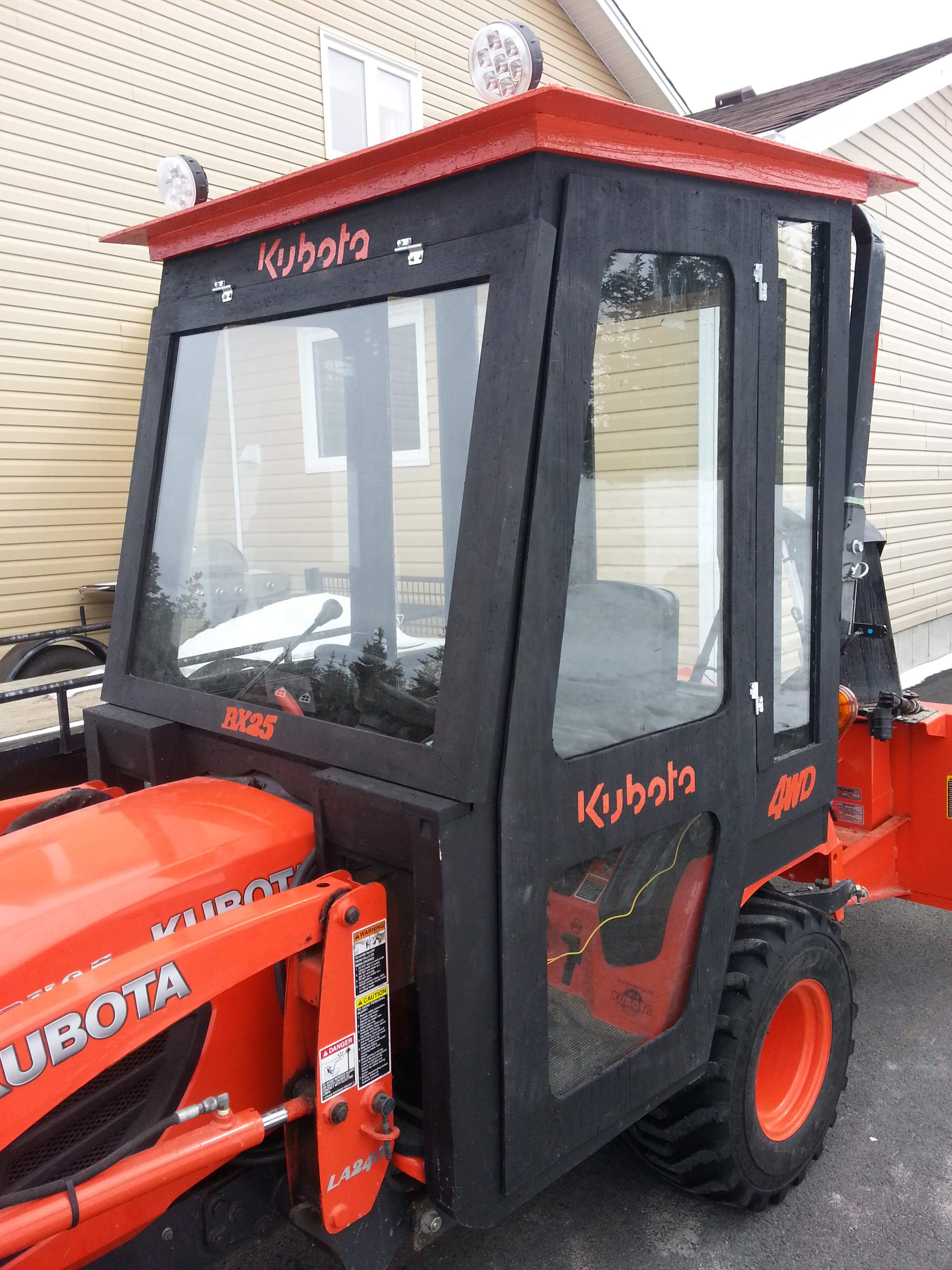

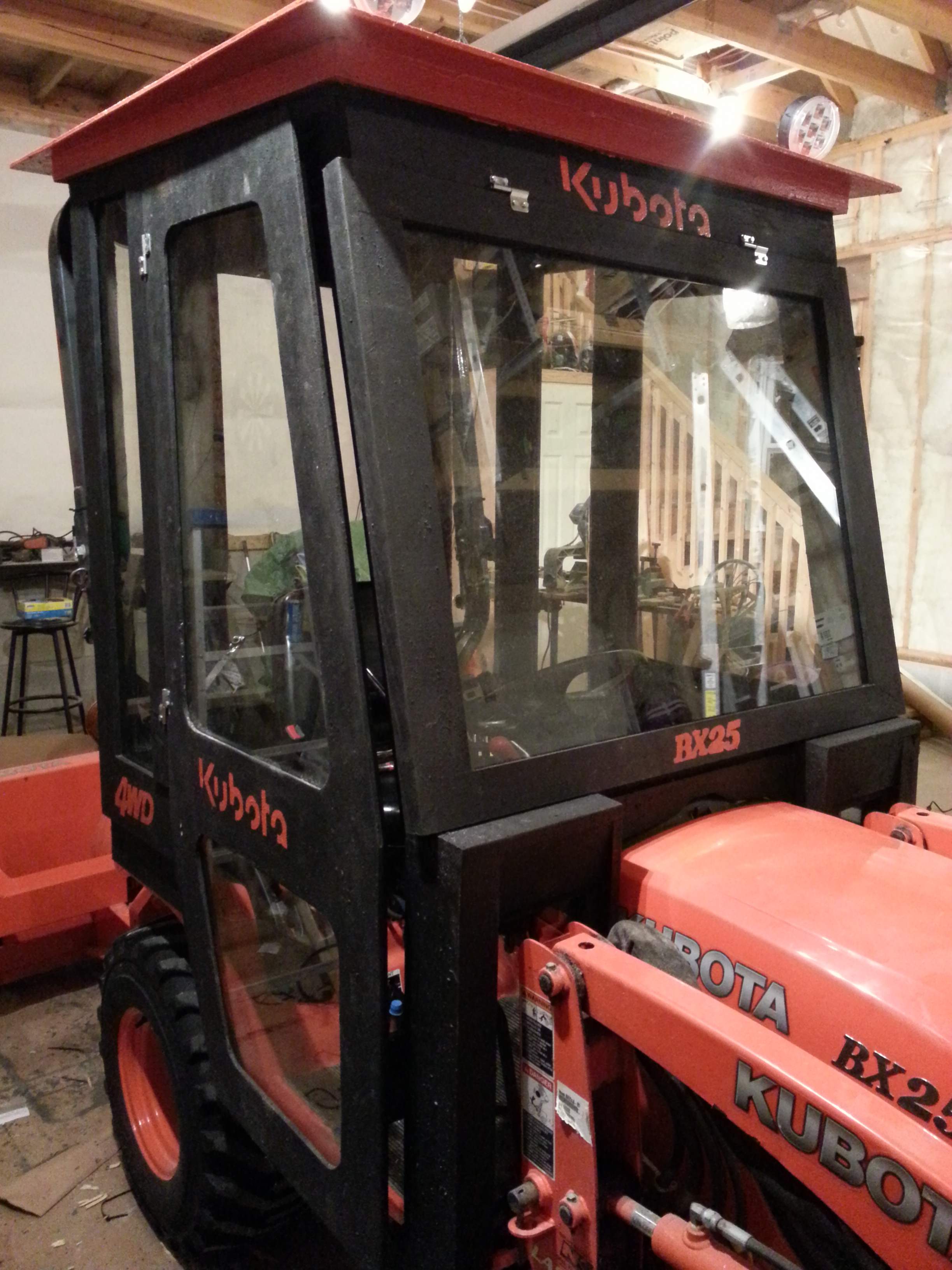

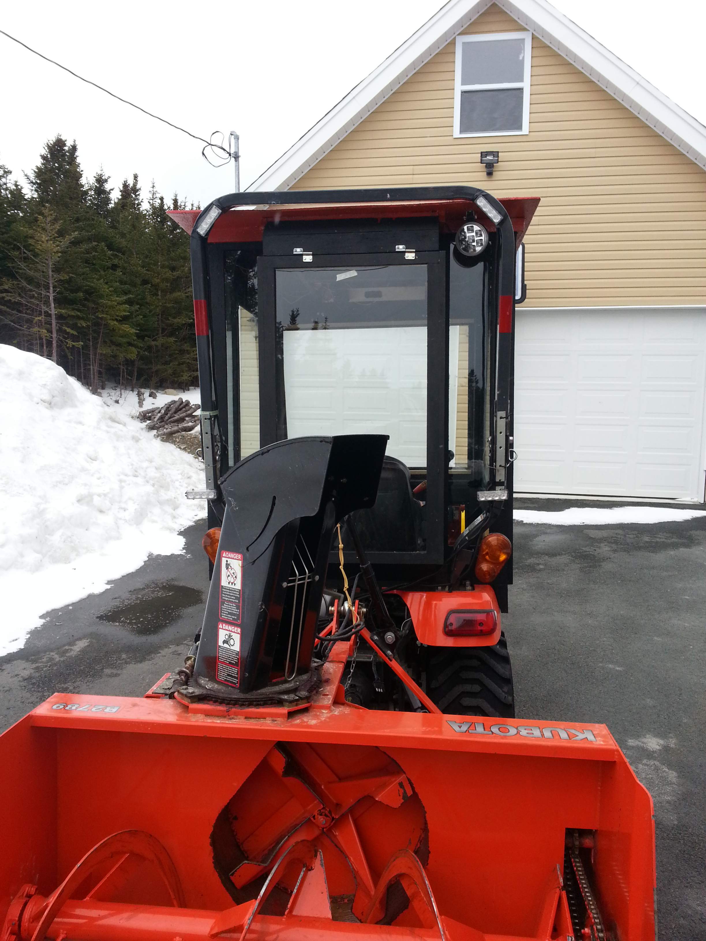

Well she's complete, well phase one anyway. I still have a few small things to do but for the most part it's done. Today I did some paint touch ups a little electrical and installed the heater so I'm looking forward to giving it a try, not sure if we will get any more snow or not. I'll have to plug a few holes in the floor and under the seat to keep the draft out but I figure a few pool noodles and maybe landscape fabric could do the trick there. The windows are safety glass rather than Plexi or Lexan and I used lift off hinges so everything could be removed in summer. I put a little video on You Tube as well in case you want a different look, however I used my phone so I'm not sure how the quality will be. Anyway folks, it was a great little project, I'm looking forward to using it more and I thank you all for your comments. If there is something you like say so, if there is something you don't like please let me know how you think I can change it.

Very cool, nice job. :thumbsup: It will be interesting to see how she holds up.

Right now just by gravity. I did make an allowance in the front to use the existing bolts by your feet but it sat so well that I didn't see the need. I do still plan to attach to the ROPS for added stability, just haven't done it yet.

I certainly use to wish snow clearing went that quick. With my setup now (blower, plow and cab) I enjoy it so much I don't want winter to end. We've had a few days with small amounts of snow overnight and I get up early just to push it around before the sun has a chance to melt it, LOL. Meanwhile what you don't see on the security cam video is the second half of my driveway, there's another 100 feet in the back and if you look at the time stamps I've been completing the whole thing in less than 15 minutes, about the same time it takes my neighbors to get all dressed up, dig out their walk behind blowers get them gassed and warmed up. Thanks for the comments.
