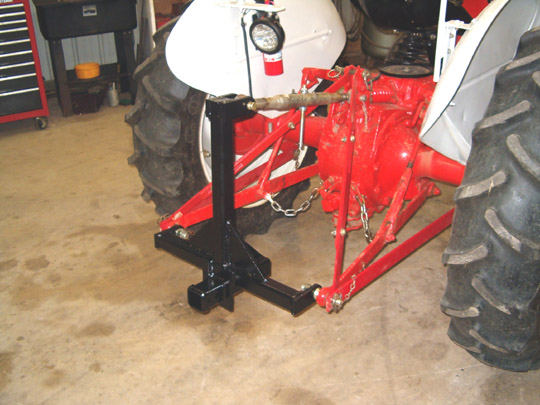

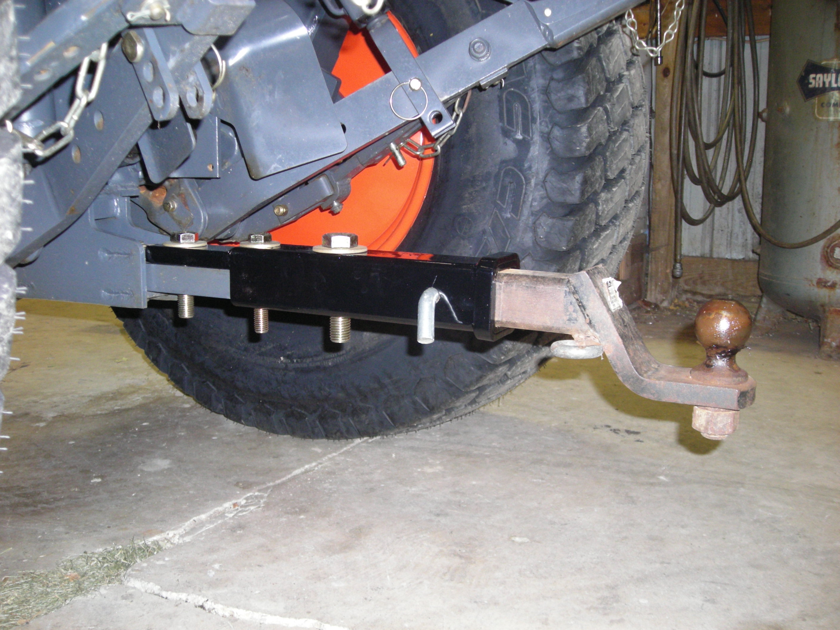

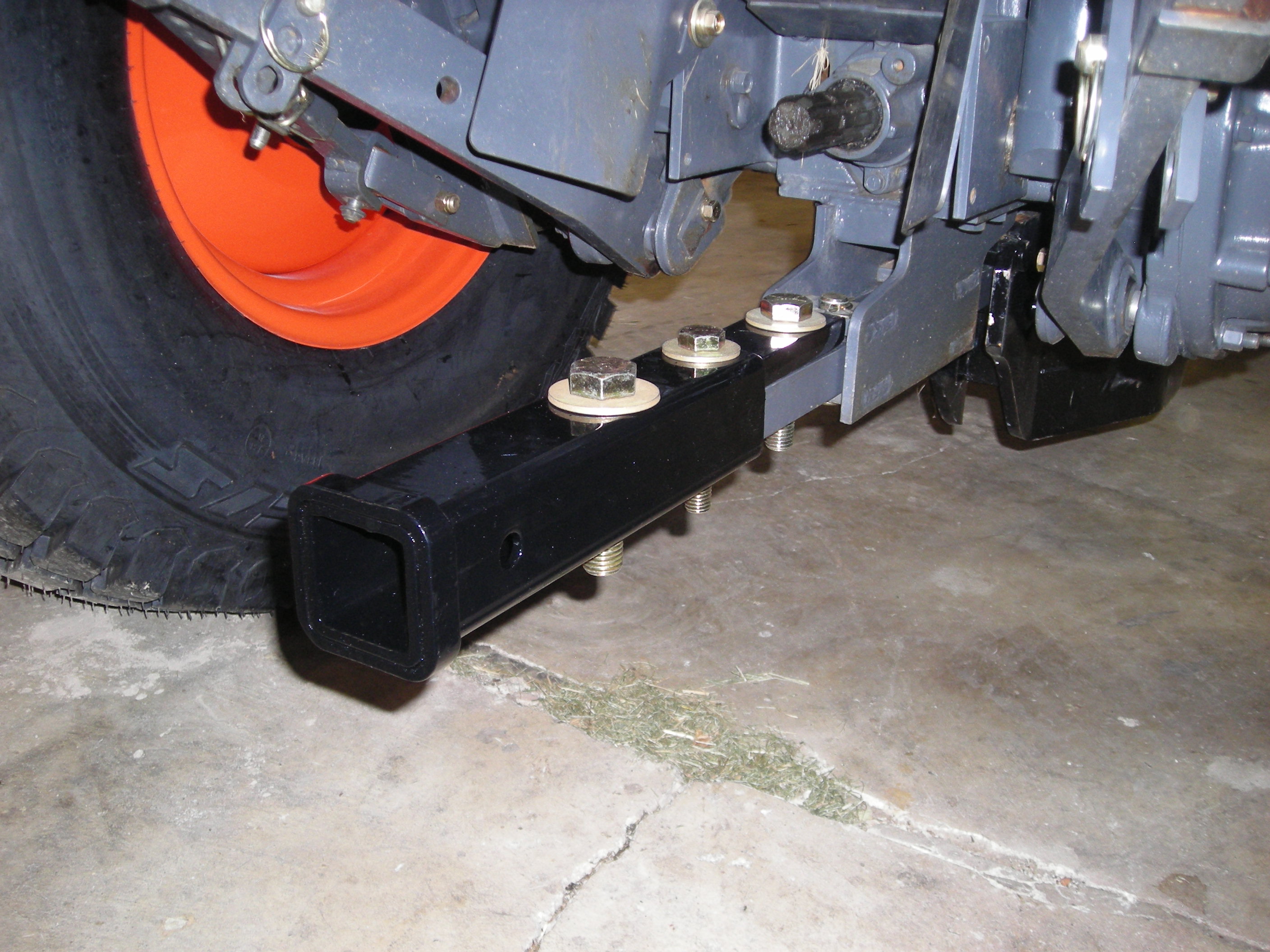

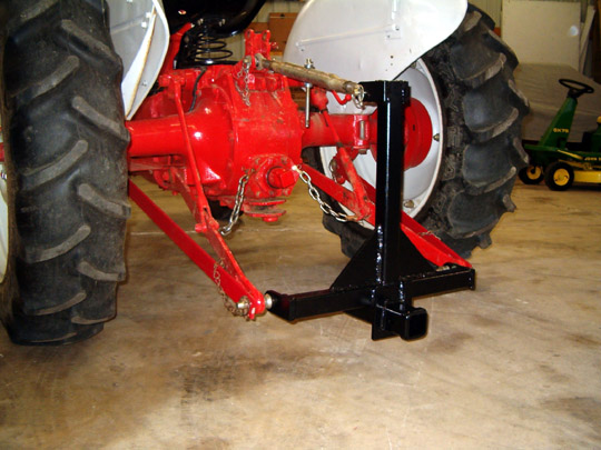

If you add a 2" receiver in the middle of the box would make it hard to sit the box down flat. I assume you will want to add channel to each side as well to make it sit flat. I don't think BX's have allot of 3 point lift power, 700 pounds or so I think, so with a ballast box and tongue weight from a trailer, you may be close to maxing out. I made these 2" receivers without much trouble, one on 3 point, one solid on drawbar. Philip.

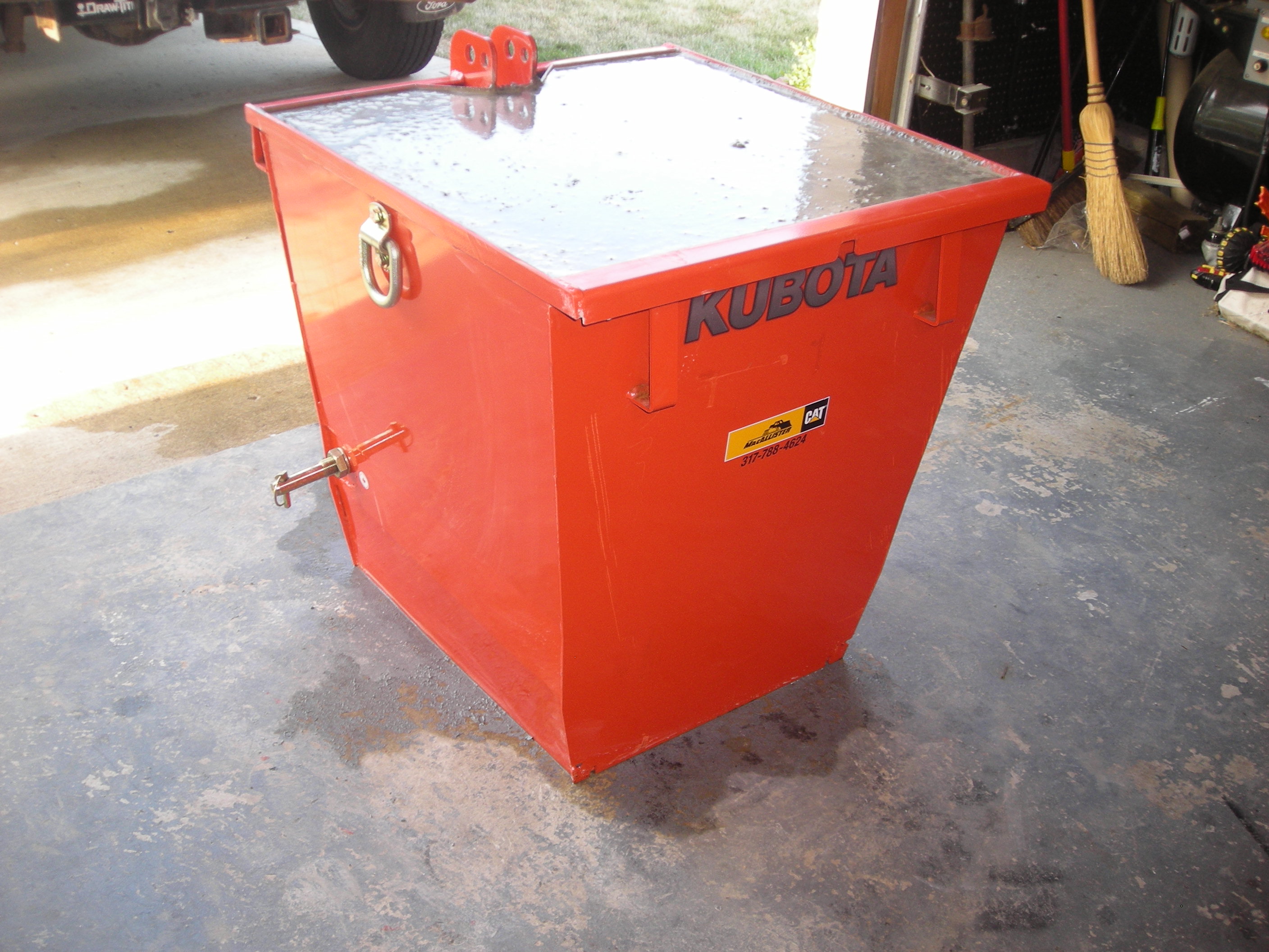

My ballast box sits on two pieces of channel which allow enough horizontal and vertical room for the hitch.
I did not realize the BX ballast box sits on angles. My ballast box sits flat on the ground. I toyed with putting angles on mine to keep it off of the ground when not in use, but I will use wooden pallets instead. Good luck with your receiver installation. Philip.
