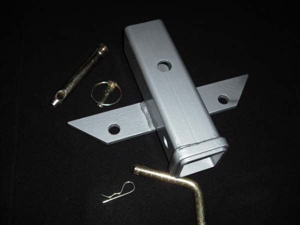

Boy I need to let you all know, I just received a new receiver hitch from Harry at BXpanded.com for my BX25 and I need to say that this hitch is PERFECT and what a great fit and less than 10 seconds to install. You sure can't go wrong purchasing anything from Harry at BXPanded.

It slips right on over the frame below the rear PTO and the pin goes in the hole where you would attach a trailer.

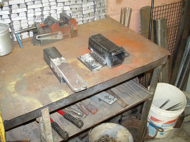

Mine does not attach as easy but is **** for stout!!! :D

The reasons mine is the way it is...............I have both pin and ball hook ups. And the hitch was so low that nothing I had was level. This arrangement raises the hitch bar about 2" which worked well for my implements; especially my sprayer.
As for the ingots, lead is getting hard to come by.

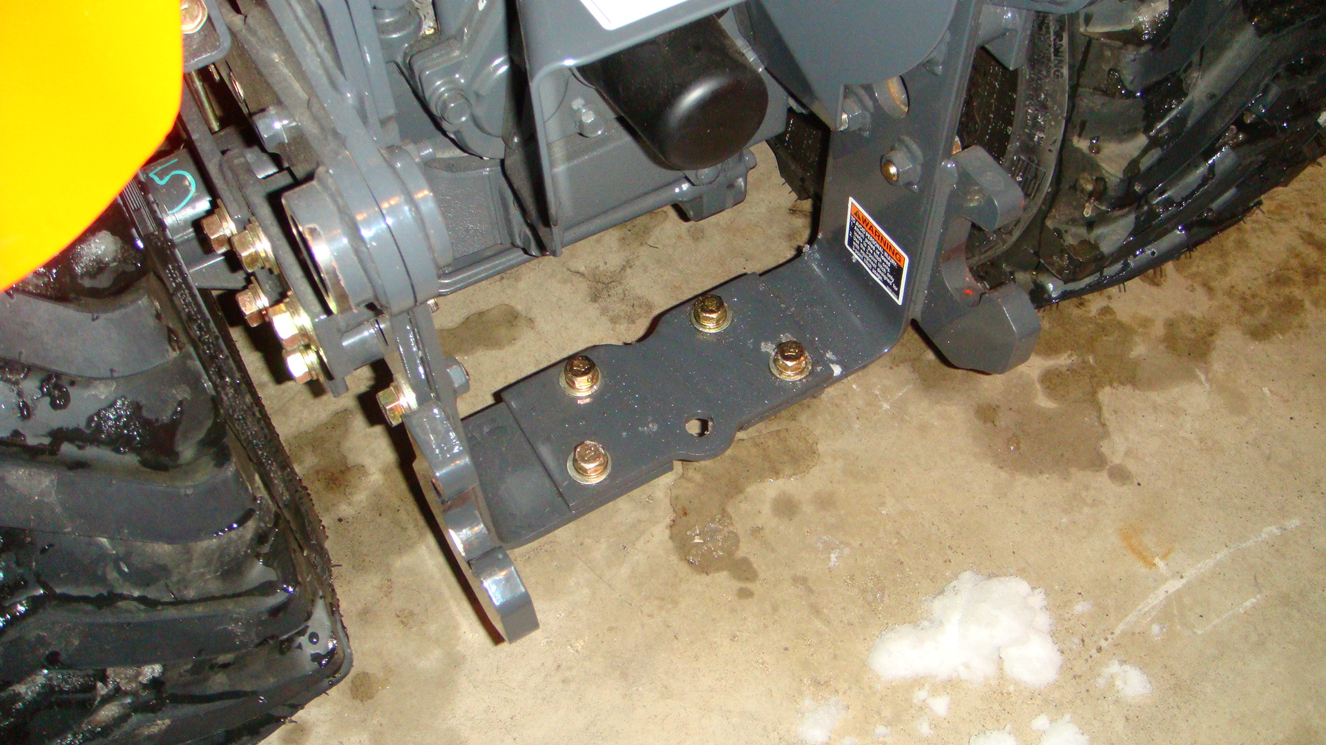

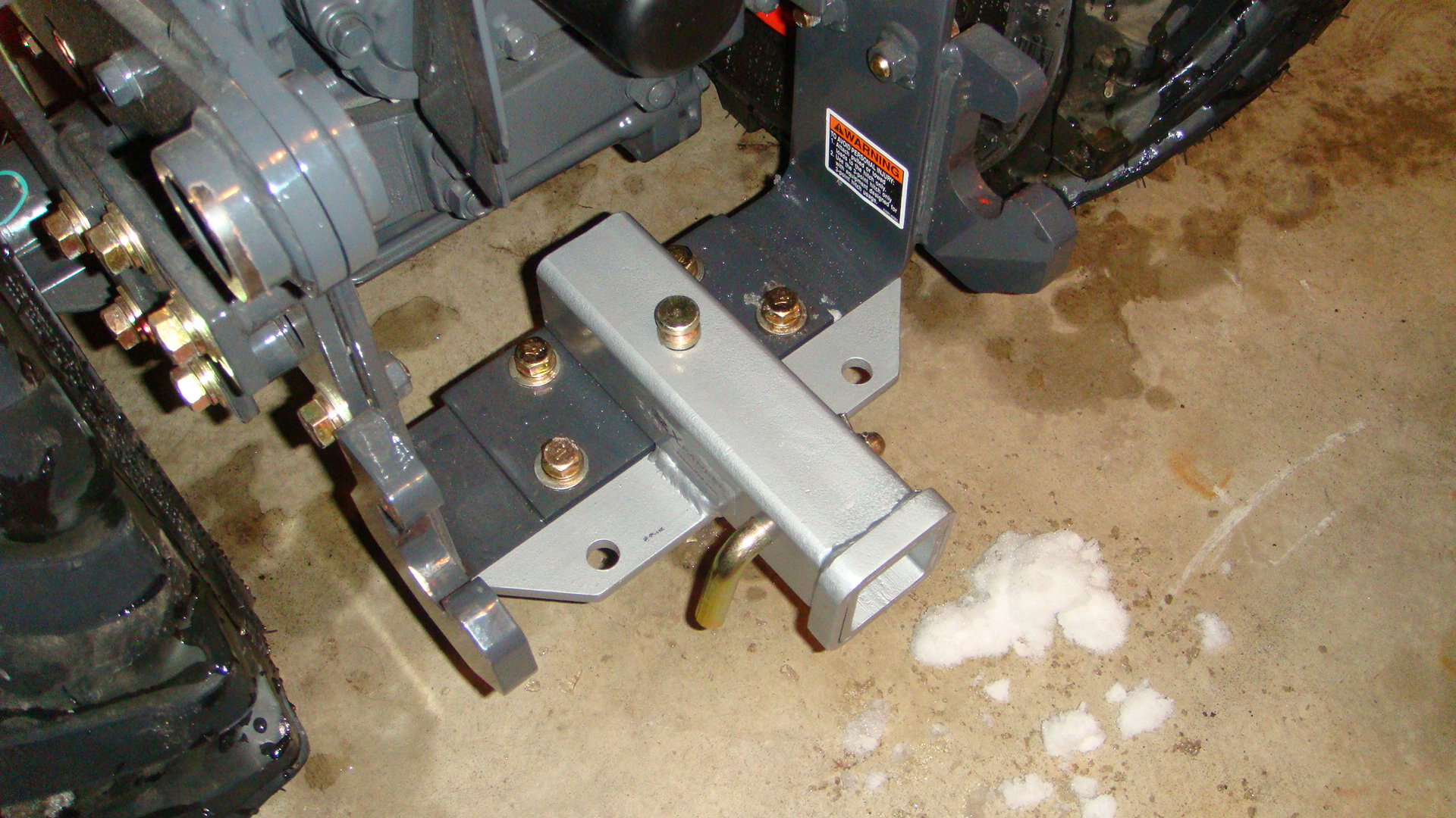

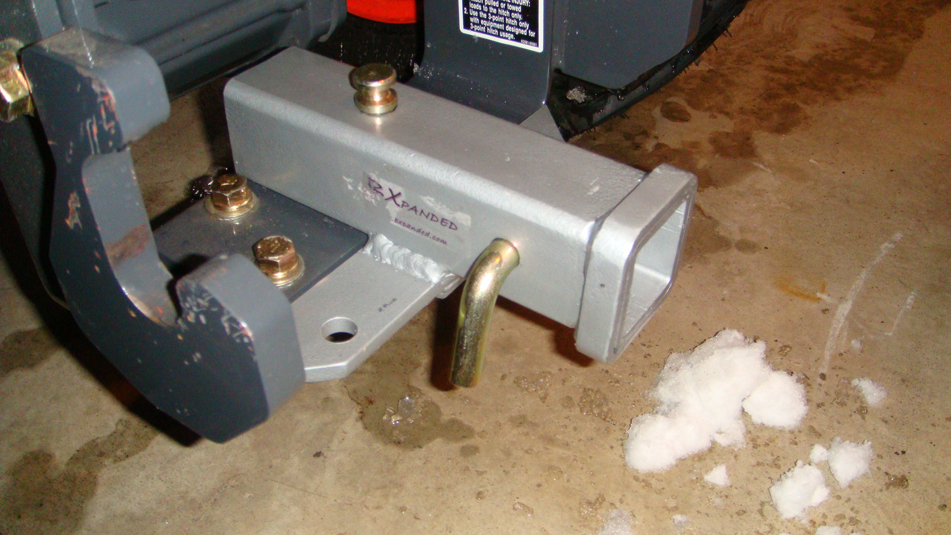

Here are the pictures of the BXpanded.com hitch installed, nice tight fit, just the way I like it!!!
Stuarth, doesn't that arrangement put a lot of rotational force on just that one pin, and wouldn't that cause the whole hitch mechanism to tip downwards, as opposed to a situation where, say, there are two vertical pins, one behind the other? Also, what is the rated hitch weight for the hitch?
/ BX25 2" Receiver Hitch #14
I'm not Stuart but I can answer:
The hitch incorporates structural members other than the pin, that prevent rotation in any plane. The pin prevents the hitch from pulling off the back. The hitch capacity is limited by the tractor's stated towing capacity.

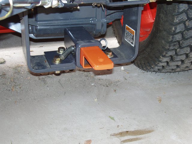

I bought a Reece reciever and bolted it to my frame. Don't remember the part number but it bolts to a pickup's step bumper. It was less than $40. Remove the crossover plate, use a Dremel to elongate the back two holes, the front two fit perfect, used stock bolts. You don't have to remove it to reinstall BH.
