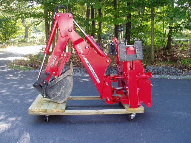

IMHO, having a dolly is the way to go. I made a couple out of pressure treated wood: one for the BH and one for the 3PH chipper. When the BH is on the tractor, I put the 3PH snow blower on the dolly and wheel it out of the way.
Like others, I lift the stabilizer arms all the way up and use a bungy cord to keep them from settling down.
This past winter it sat for 5-6 months with no problems.
