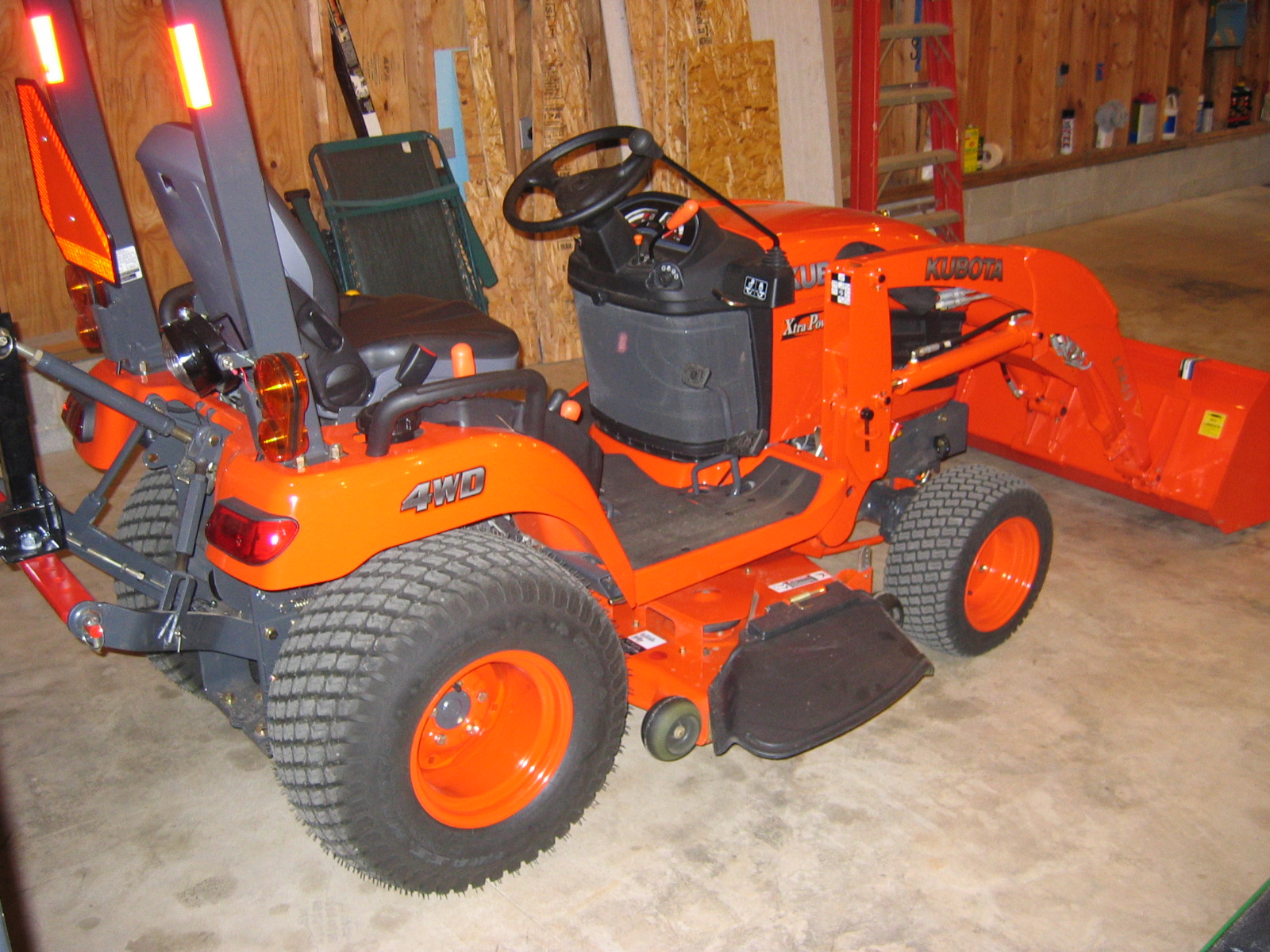

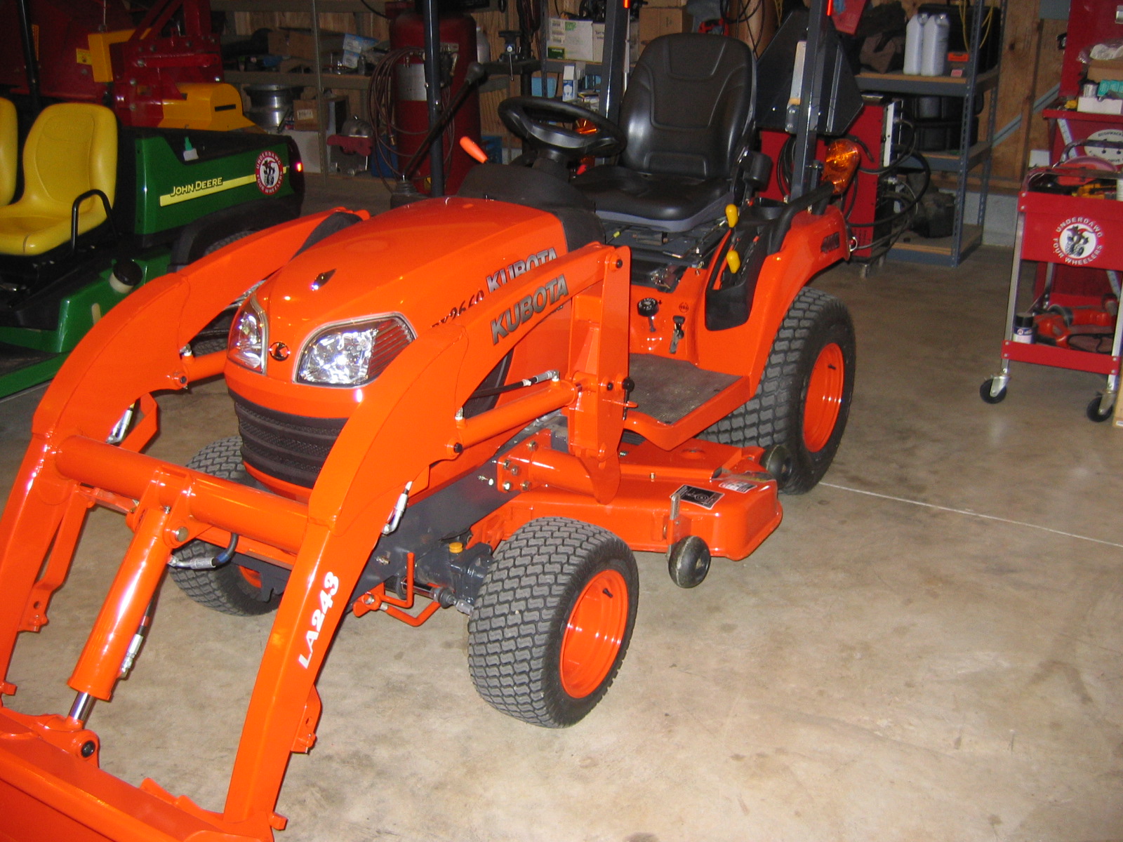

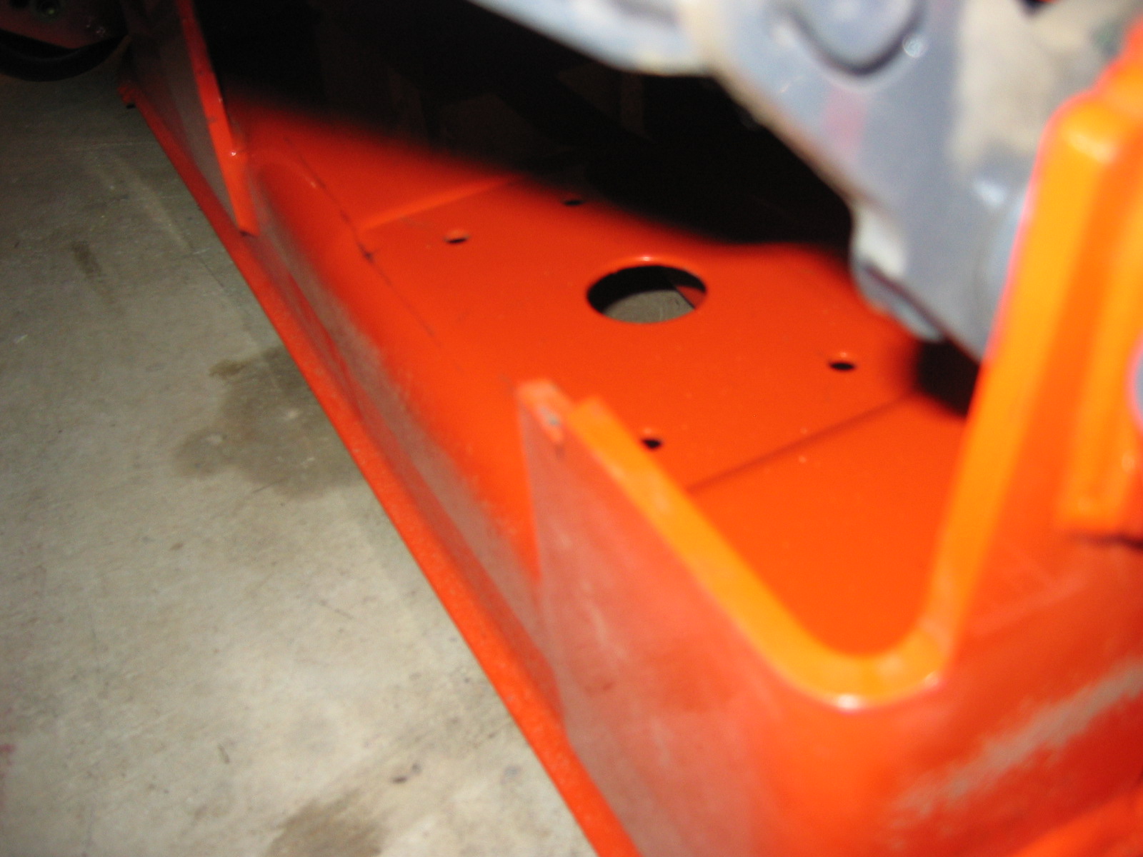

I put a 48' deck on my BX2660 from a BX1850. This fit with minimal modification. 48" deck will level as the other two larger decks do, drive shaft fits, and front hanging brackets fit with out modification. the only modification was cutting the rear stop brackets where they come to the frame 3/8 inch for clearance to allow the deck to get to top position. One draw back is that the cut height is 1 inch higher than the indicator. For me this was no issue as I do not cut grass lower than 2". One additional benefit is that the ground clearance with the deck raised is 1" taller. The deck cuts about 1" wider than the rear tires on both sides.
I don't know for sure if there is any additional clearance problems associated with the BH sub frame kit of the BX24, but I would be inclined to think this would fit. I had a good dealer that had access to a 48" deck and supported me in trying this out. I did the final modifications myself. This is the second time I have done this with a BX. Before you do this look at the anti-scuff rollers so that you will not be disappointed later. The larger decks have more adjust-ability and can be turned sideways. On the same hand the smaller deck is less likely to scrape and will push out from under the tractor pretty easy, as it is lighter.
If you are going to use R4 tires (I also have a set-Ag's shown in pictures) the rear anti-scuff rollers will have to be moved forward. This is simple and requires just a new hole to be drilled on each side. About 1/2" forward will do. I also lowered the hole a Little from straight forward since I moved them closer to the deck.
You still might want to consider the cost of the deck and possibly to buy a Home Depot or Leows Disposable tractor with deck for similar cost. I didn't want to do this for three reasons- Extra engine & maintenance, garage floorspace, and explaining to my wife how my yard tractor got too big and new we need another.........
Kubota is the only tractor of this size that can do this deck size, that I know of. Hope the pictures help. Shown is 48" deck mounted to BX2660 and bracket that was trimmed at rear of deck. The other side opposite bracket will require same modification.
