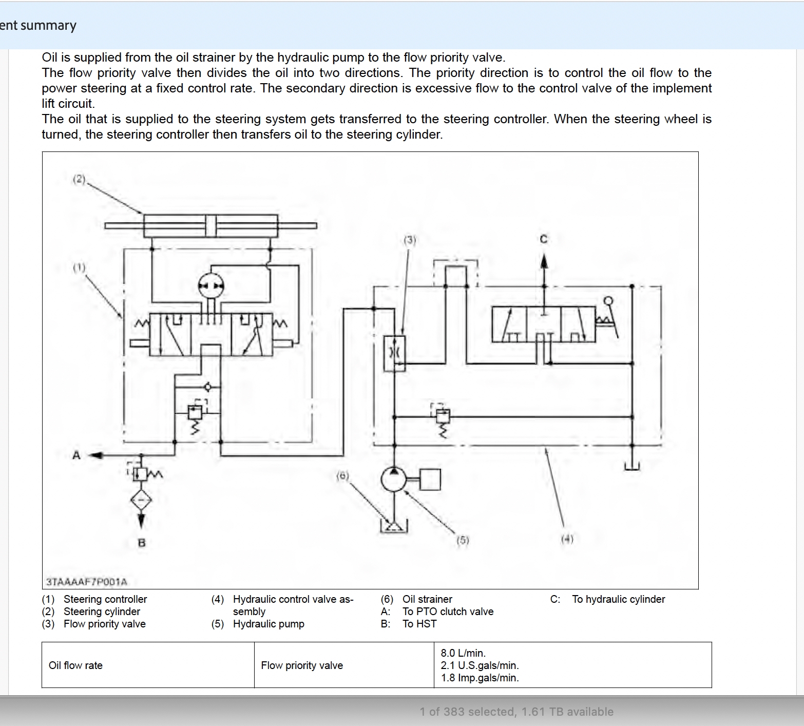

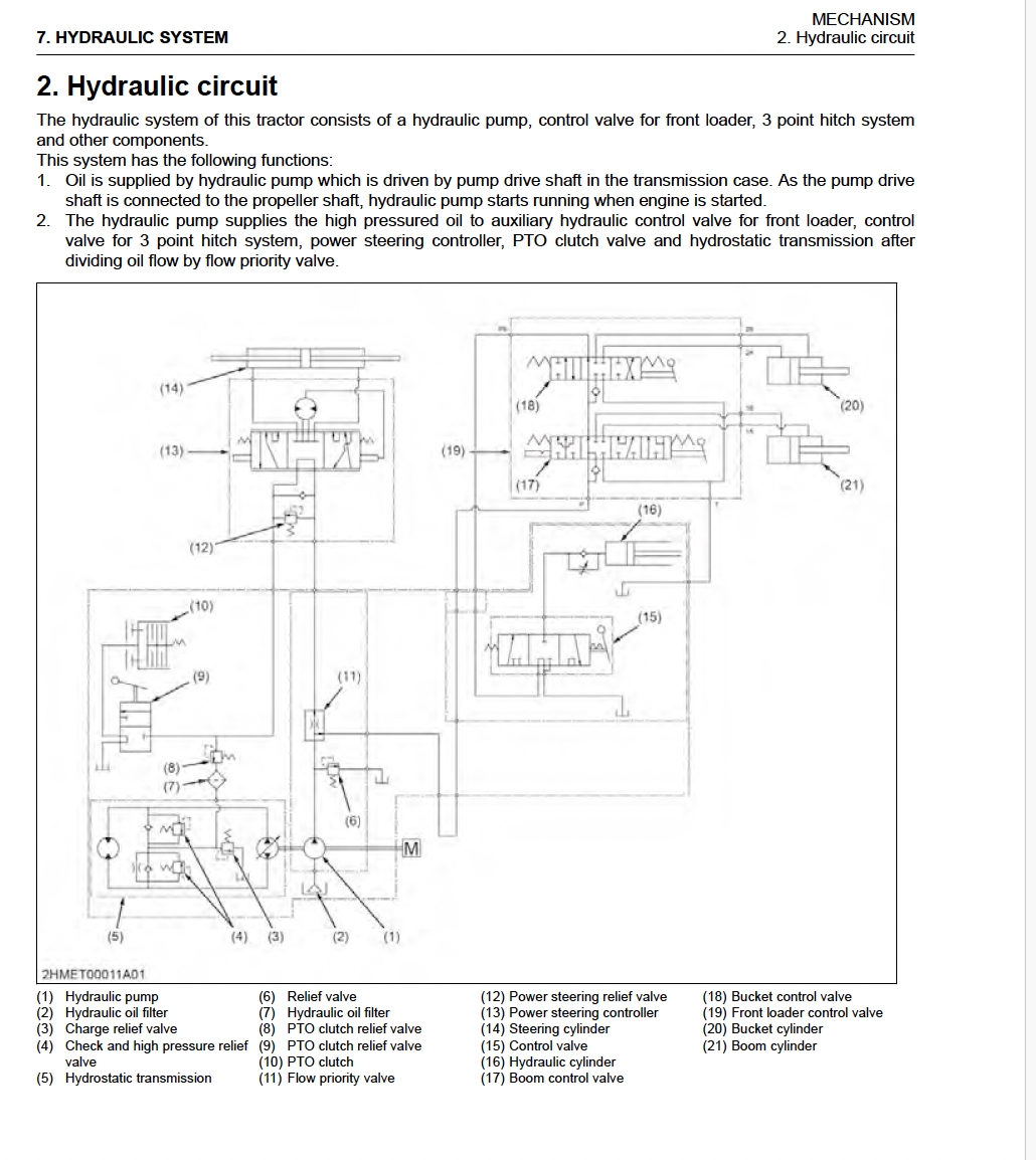

Suki, I have just tried to send you the BX23S WSM via Personnal Message (PM). Let me know. It has full info. Much better than more recent manuals.
Also found in the WSM more hydraulic diagrams. One identifies (#3) as a relief valve that may also affect your filter pressures. Worth checking, but read the WSM if it arrives.
Nice to see someone willing to do their own diagnostic work these days instead of dealer.
rScotty

If you figure out how to get the WSM, setting the HST reliefs & charge pressure is on pg. 257.
The PTO works on 150 psi, but the HST reliefs at 3000 psi. That is enough pressure to be deadly and cut a foot off.
Please be careful. 10 seconds max on the relief. The WSM implies that those HST relief valve had a nut that coud back off, .

Per schematic attached by rscotty the filter is after the PTO relief and before the HST charge relief. If this is correct the charge relief would be the only relief that would affect the filter or an obstruction between the filter and charge relief.
Other potential concern would be if the priority flow valve is somehow allowing more flow to steering- charge circuit which may increase charge pressure. I recall some posts in the past about priority valves failing but do not recall what the failure mode was.

Pretty late to the party here, but looking at the WSM for my BX22, the filter is in the HST Loop. I would expect the problem to be stuck check valves in the high pressure relief valves forward/reverse. Nothing to do with loader relief valve. They are located, looking up from the bottom of the tractor, between the filter and the front PTO shaft.
