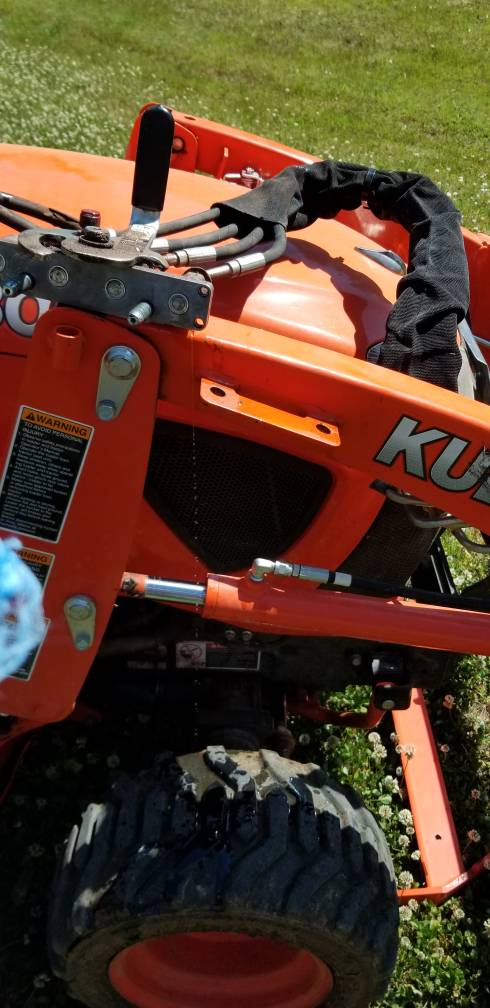

Anyone have an issue with this assembly leaking (slow) and dripping on their driveway? Any fixes such as reactuating the assembly?
Tnx,
glenkView attachment 563452
The quad upper block assembly that comes off with lever was replaced on mine. It seems to have solved the leaking problem but I haven't done a lot of FEL work since then. I will be doing some shortly and will update the thread.

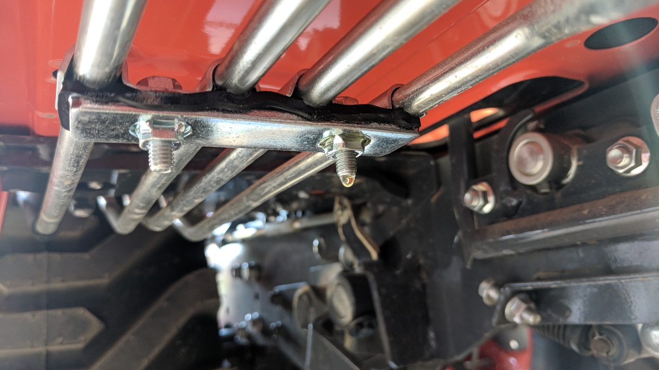

Have same exact problem. Started just as some drops here and there. Very recently turned into a complete run. Will talk to my dealer about what you mention here. Picture attached. It's one of the 4 qds pouring out even when it appears seated.
Worse when connected and motor running. Lost 2 gallons of oil. 20200516_153214.jpeg

Worse when connected and motor running. Lost 2 gallons of oil.View attachment 656317
Wow, that's a lot of fluid. Also quite a few $$ to replace just the fluid alone. Is the leak coming from the gap between the upper and lower quad coupler assemblies?
After a year of use, mine still seeps fluid. I think the dealer tests the repair just by cycling the FEL through it's motions. That does little to stress the FEL mechanically. You have to be digging, lifting, stressing the FEL arms horizontally.
