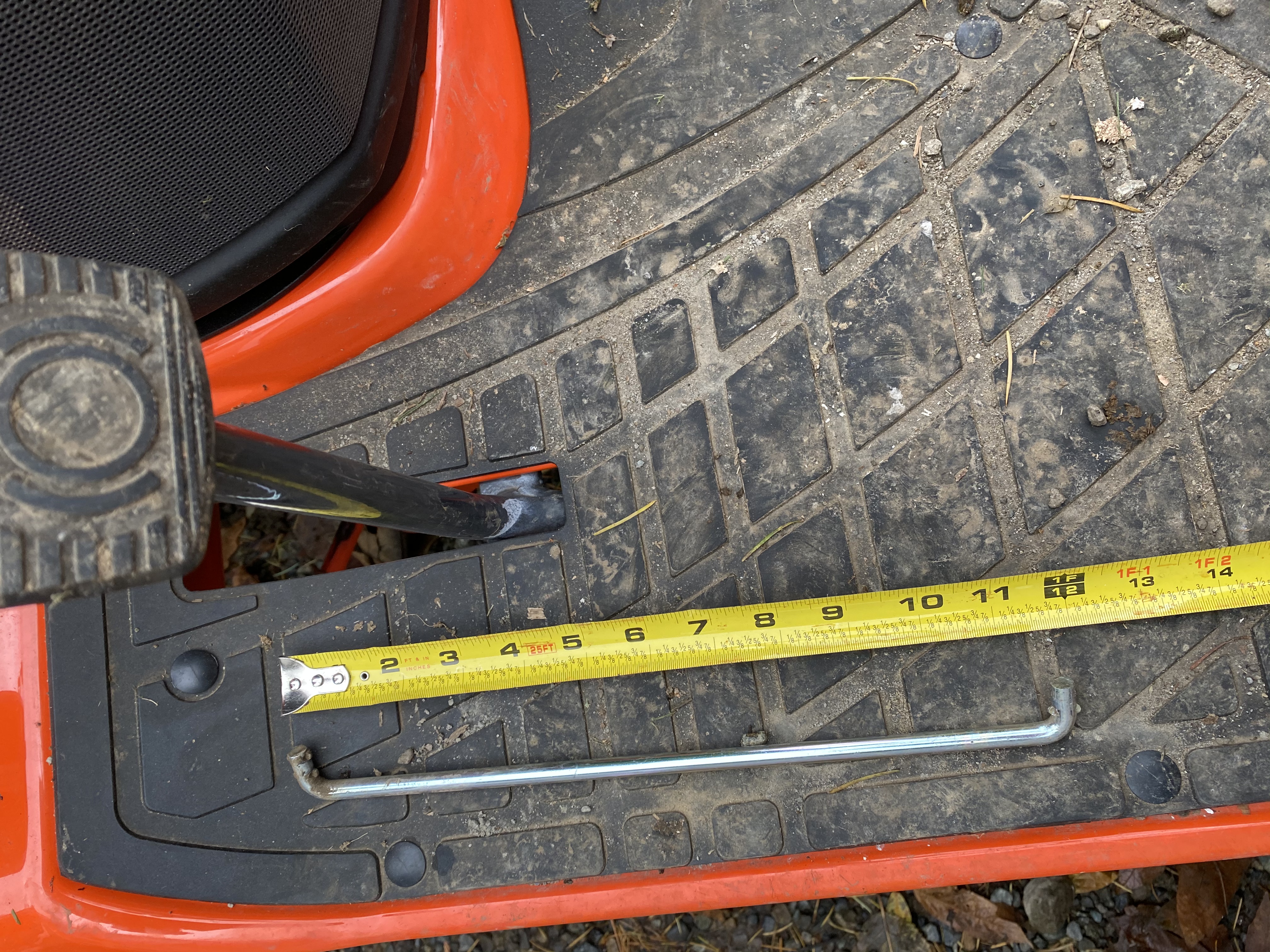

I have a BX2380 w/loader and drive over 60 MMM. I recently was doing some bucket work and heard a medal clanking noise then after backing up I seen this on the ground. It looks like some linkage however I have yet to figure out where it came from. The only I have noticed so far is the Mower seems to bounce more when driving around. I was hoping someone here might be able to help identify where it came from?
I appreciate any help on this one.
Rob

Could it be a link from the loader levelling indicator? That's if you're loader came with one.

No it did not come with one.

Possibly linkage for the parking brake lever...

That seems about right, also check if both brake pedals and all shifting and control works - gear range, pto rear/mid select, pto engage, 3-point position control, 2wd/4wd, and cruise control?

Thank you. I will run through all those to ensure they all work.

Also check the hand throttle lever...

I checked all these to ensure they all function and they all work with no issues. I suppose that’s good but confusing on what its from.

I'm guessing it came off your mower then.

That sir, is your diff lock rod.
I just dismantled and put a new transmission in a BX2380 last week. So I am very familiar with that machine.
