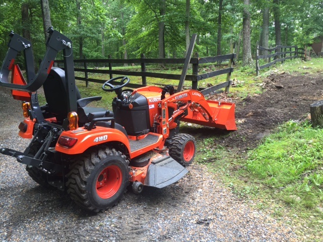

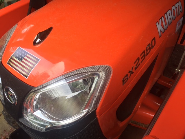

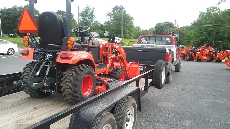

Thanks for all the great tips! I had the dealer switch out the turf tires for the R4's and they're filled. My little 1972 JD 140 H3 quit on me last Thursday and I picked up the 2380 Saturday. I've put a little over 8 hours on it and just tucked it away in the shed. I've done about 2 months worth of Saturdays work in those 8 hours. Mowed my lawn, mowed my son in law's lawn and 2 fields. Moved about a dozen unsightly stumps that have been laying around the property for years and dug 2 small stumps and moved them. I also used the FEL to rough grade a very rocky area in one of my fields and moved most of the rock. Moved another pile of rock I'm going to use for some landscaping. I'm absolutely amazed at what I've been able to accomplish with this tractor. And, of course, my grandson just had to sit on it with Grandpa before I started my work!
