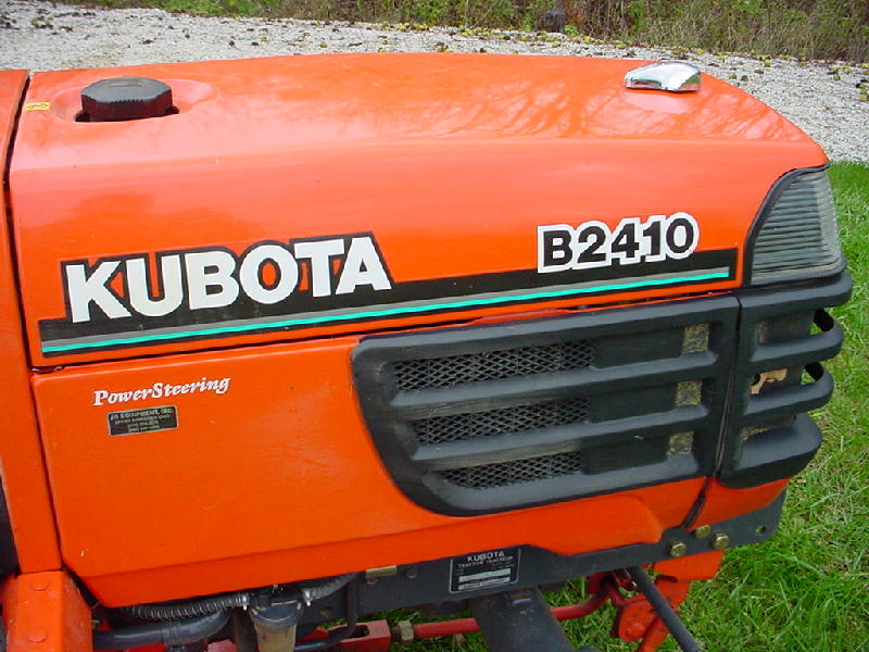

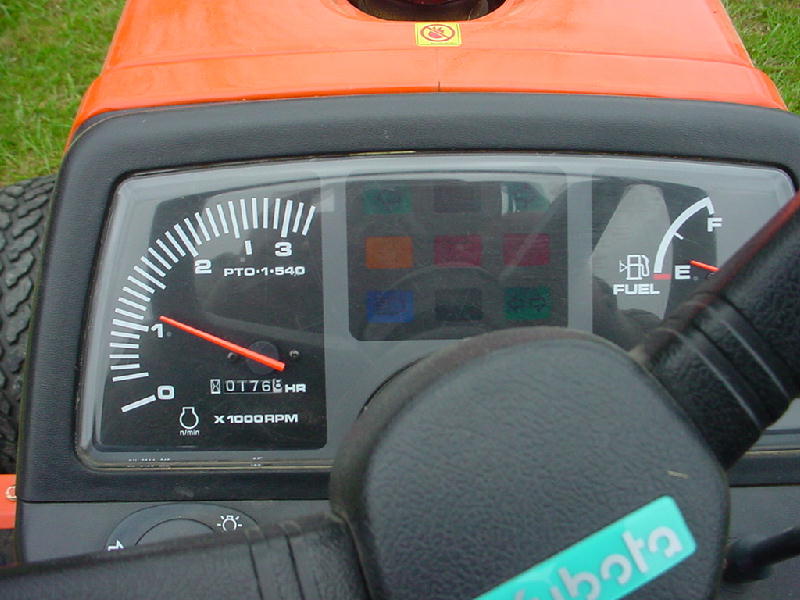

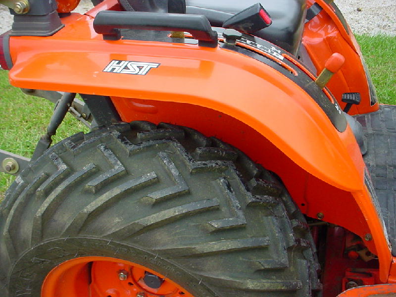

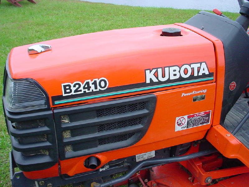

I do, at present, only have 1 acre. My wifes family, who lives next to us on two sides, has a total of about 10 acres - but it wouldn't be my responsability to take care of their property, just when I wanted to play.
I was considering the BX until I ran across this 2410. While it isn't "as good of a mower" as the BX is, it does have a full Cat 1 3PH.
I just received some pictures of the 2410. I'll post shortly.

If it was me i'd go with the 2410.
/ BX2350 or B2410 #8
Pretty clean looking unit.
/ BX2350 or B2410 #9
if it has a mmm and no loader i would think those hours that are on it were easy on the machine
/ BX2350 or B2410 #10
I agree. Nice looking unit. I also noticed that they marked the date on the oil filter. Seems like what very little amount of maintenance that was needed in it's young life was done. It'd be hard to pass on that one.
/ BX2350 or B2410 #11
Since money seems to be an important part of this decision, I too would go with the B2410 because of the depreciation issue you mentioned above. You could use the B2410 for a year and if you didn't like it, sell it for what you gave. Can't usually do that with a new tractor. You would come a lot closer to getting your money back in a trade for a BX2350 a year from now than you will trying to trade a year old BX2350 for a new B2630.
Another selling point to me is you are seeing the 2410 in it's work clothes. No one is trying to hide anything by detail cleaning this tractor. I'd say it is exactly what it looks like, a maintained, lightly worked, slightly used tractor.

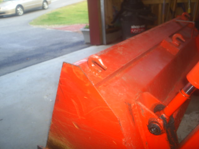

I am already thinking about customization. I didn't have them do anything with bucket hooks. I want to order a tooth-bar (probably Markhams') and then for the hooks I want to get a rectangular steel channel to tuck up an under the top lip of the loader and then weld it in place. I'll have the hooks welded onto that then - then painted of course. I don't have a welder so I'll have to hire someone to do that for me. Does anyone know how much traveling welders charge for smaller jobs?

Great price on a great tractor. On the bucket, you need bar channel, not a piece of rectangular steel. Here is my LA352 with bar channel welded in and hooks installed. It fits perfectly. Sorry the photo quality isn't a little better.
/ BX2350 or B2410
#14
I realized my mistake when I started researching what is available steel-wise after my post. I meant to say channel.
Do you by chance remember what size channel you used? Also, what did you do over by the bucket level indicator?
Lastly, why is your middle hook set back further and not on the channel?
:) I've just begun to start asking questions!! :)
/ BX2350 or B2410 #15
It's been 3 years, I can't remember the size off the top of my head. It slides right under the bucket indicator, a tight fit, but no issues there. I slid the middle hook back to keep it out of the way when using the two outside hooks. I use those most often and string the chain between them, then hook to the object. It helps spread the load to both lift cylinders on the loader. When I do use the single, the middle one is there. Also, I'd like to install a grapple at some point, and pushing the middle hook back makes that more feasable.
