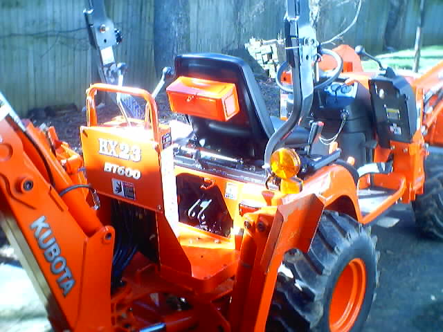

Greetings, as all BX owners know, probably the only shortcoming of the BX series (well, to me anyway) is the lack of a toolbox. I guess when Kubota set out to make the 1st ever subCUT, they wanted to squeeze as much into as small a space as possible. This is a good thing in most all respects except'n most of us need a small storage space for the various tools & gloves we need when operating our BX's.
Well, I found a well made, somewhat heavyduty and small tool box of just about the perfect size for my BX23. It's 11x4x4 and weighs a good couple/three or four lbs and has a full length lid hinge. I ordered it on Wed and got it on Sat., and it came red primed, ready for painting.
After peep'n around the BX23 for a space to mount it, I noticed several plastic plugs on the metal seat back frame and when I removed them I discovered the holes had press fit 8MM nuts behind them. There are at least 6 of 'em so I picked the set that would line up with the tolbox's backplate, marked and drilled some holes in the box, test mounted it and saw that it'll just clear all the obstacles and work pretty good. I was then faced my last decision, what color to paint it! Black would have made it blend in with the seat and I almost went that route but I then decided that I wanted to use up the last of my Chev engine orange spray paint and I wanted it to stand out a little too /forums/images/graemlins/grin.gif so orange it be!
It'll hold my workgloves, some handtools, some implement clips and whatever other small stuff I may need once I get to working this little beast /forums/images/graemlins/grin.gif

Heres a pic of it mounted on the seat. The two 8mm 1.25 bolts secured it good enough and lockwashers & locktite should hold 'em thataway.

A pic showing how it clears the steering wheel when the seat is in the BH position.

A final pic showing how it clears the ROPS by a just couple inches when spinning the seat around. If I had mounted it an inch lower it wouldn't have cleared the ROPS.
All in all the toolbox fits just about as good as any would have and I'm not so sure that a longer, taller or wider toolbox would have worked behind the seat.

Looks like dinner to me /forums/images/graemlins/grin.gif Nice looking tool box mount. Do you think the weight will be an issue on the seat back when bouncing around?
